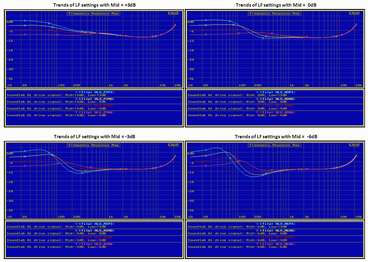

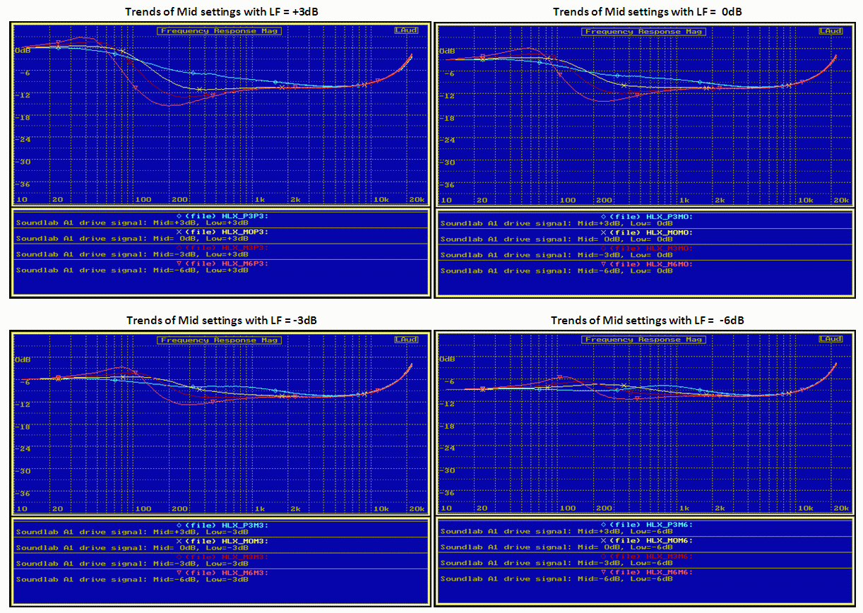

Indeed the SL A-1 has 4 setting for LF which pick different taps on the LF transformer primary, and 4 settings for MID which put different amounts of inductance in series with the LF transformer.

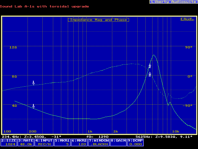

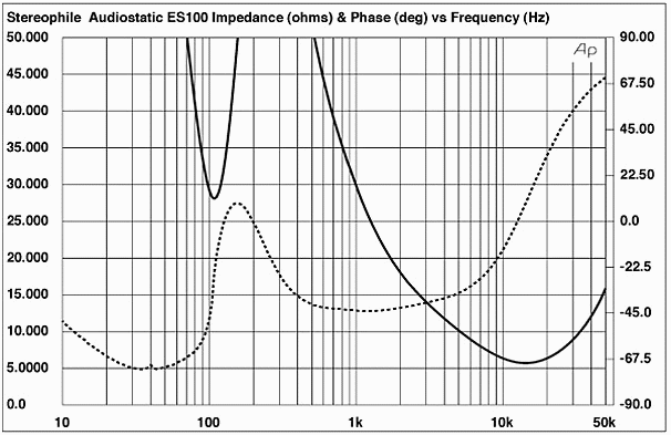

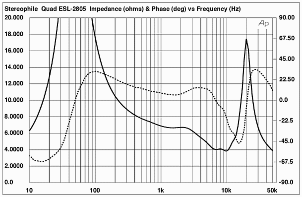

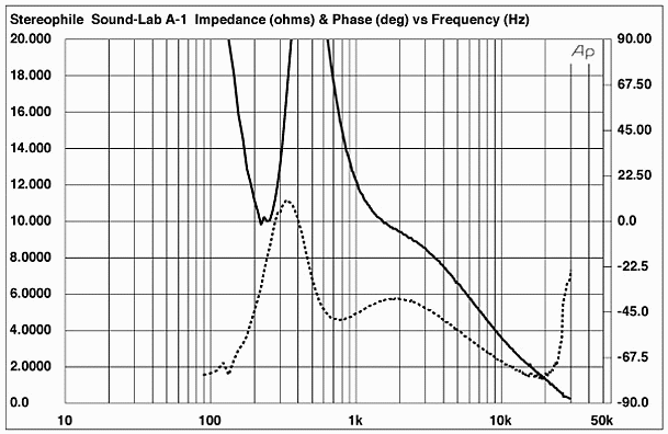

Attachments 3-5 show some impedance curves published by Stereophile for 3 full range ESLs: SL A-1, Quad 2805, and Audiostatic ES-100.
Note that the Sound Lab measurements were from 22 years ago. The backplate design and transformers themselves have changed significantly over the past two decades. The panel design has undergone many changes as well. The most recent change was two years ago with a new bass transformer that blends at approximately 200 hz rather than 500 hz. It is far more tube amplifier friendly.
Attachment 6 shows impedance for the SL A-1 with LF and MID both set on +3dB…the impedance drops to a punishing 2 ohm in the midrange.
I'm not sure why anyone would choose either setting. I've never run midrange at anything other than flat and find that the most linear response at the bottom in my room typically comes with the bass control at -3.
