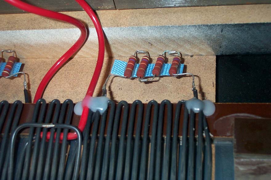

What pussles me is the wattage of the equalization resistors. They do not look no more than 2, may be 3 watt.
Resistance is around few hundred kOhms.
Most of the panel (area wise) is driven through 4x390k in parallel: this translates into 4Ohm @ transformer primary.
Besides the ohmic resistance of the secondaries it's almost the only dissipative element in the circuit.
Assuming 1000pF capacitance of the panel, reactive inpedance will be 32kOhm (@5kHz) which is 3 times less than dissipative one.
Vector summing of impedances makes capacitive component irrelevant (almost like short circuit): Sqrt(90000^2+32000^2)=95k

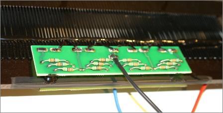

Concerning segmentation resistors:
I usually use multiple resistors(as do most manufacturers) in series to keep the voltage across the resistors within rating and to share the power dissipation. I attached two examples from Capaciti and Audiostatic. In my experience when playing music single segmentation resistors do seem to work fine as the peak to rms ratio of music keep the power dissipation low. However, if you play loud pink noise or high frequency sine waves, the single resistors will got HOT quickly and burn up if left playing.

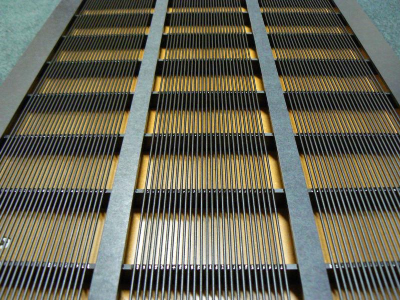

Hello mavric,
Stator costs
Material cost for wire ESLs are not that much different from PSM(perforated sheet metal) ESLs. Certainly the PVC insulated wire is much cheaper than buying PSM and getting it coated. But, wire ESLs usually require some sort of jig to be built to hold the stator and wires while gluing everything together. For manufacturers that will use the jig to build many stators, the cost is quickly made up. But for DIY where you may only build one or two, it is a major part of the cost. For me, the results are well worth it. You get a very uniform, flat, well insulated stator this way. I attached a pic of my latest stators before I attached the diaphragm.
transformer costs
In general, wire ESLs require a transformer with 2 to 3 times the step up ratio as that used for most PSM ESLs. So, you can expect to pay 2 to 3 times as much. Ratios of 150:1 to 180:1 are typical. You need the higher step up ratio to keep the efficiency up with the segmented wire stators where your radiating width in the midrange may only be 2 to 3 inches. What you get for your trouble is much better dispersion of high frequencies. Most people find this to provide a much more natural and enjoyable listening experience. However, there are some people that prefer a very directional, beamy PSM panel.
size
For segmentated wire ESLs to work well and provide flat response down in to the bass range, the panel really needs to be taller than the 40" you mentioned.
Ideally, it would extend floor to ceiling. It doesn't take up any more floor space ;)

Thank you for taking the time. I love the floor to ceiling, but mine is vaulted. I am trying to imagine your set, very interesting concept. the jig seems pretty strait forward, just distance between wire and distance between the mounts that secure it, hope that make since.
I tried to look closer at the picks you have posted and noticed different wire gauge, so is each partition on solid wire loop per partition, or are they cut and soldered, insulated at the top and bottom( per partition?)
Noticed test tones, i will no longer do that anymore. it is really bad for any audio setup.
Look forward for more info and pics, since I have joined, I have only had a few things posted from you, all were great and very informative, much appreciation. Kind regards. Mav
i do have a loft, building a 15 foot jig sounds like fun. You and Charlie have me addicted to this, almost better than sweet tea. keep posting, you are waking up everyone.

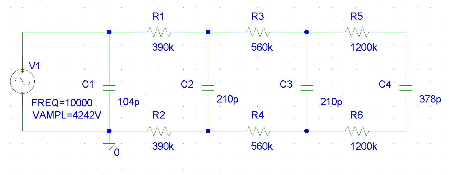

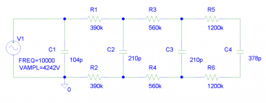

Back to the question... Why do low power/low voltage resistors used?
Am I missing something?
Assuming panel capacitance is 1500pF (spacing 2mmx2=4mm)
Only half is drawn
5kHz
UR1=1400V UR2=290V UR3=50V
PR1=5.5W PR3=0.12W PR5=0.0W
2kHz
UR1=1250V UR2=600V UR3=105V
PR1=4W PR3=0.5W PR5=0.01W
Having impedance of 4 Ohms @ 100W one needs not some current but at least 5A @ 20V or 33 mA @ 3000V
Alex
P.S. Try to burden resistor (MF or Carbon Comp) with two times rated power...
