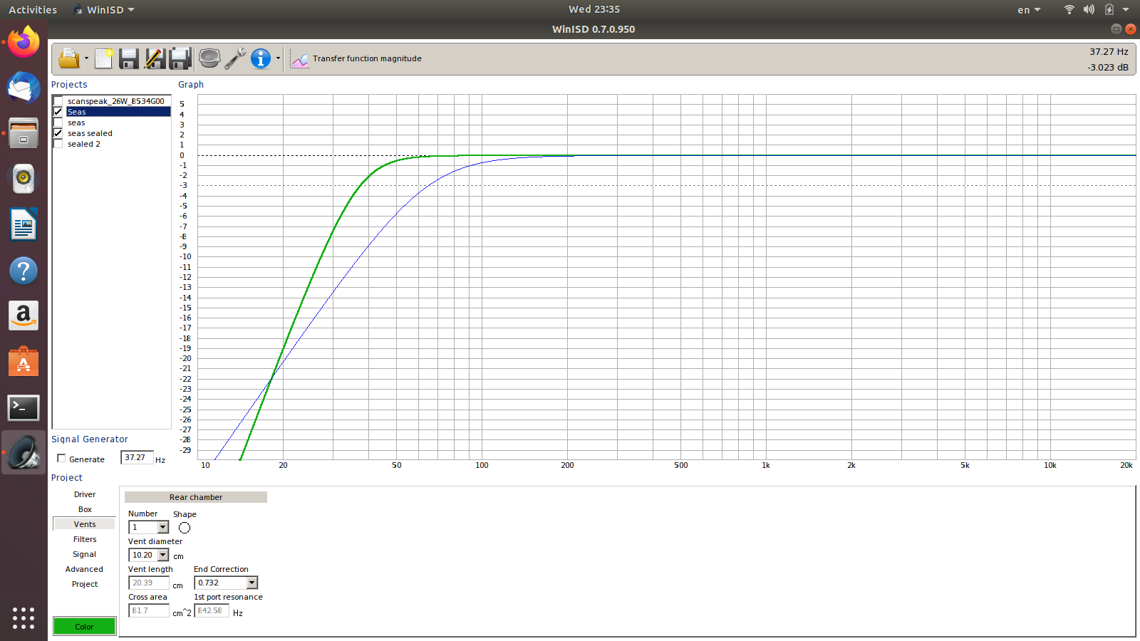

I tried to reproduce the example given at Seas documentation
http://www.seas.no/images/stories/prestige/pdfdatasheet/fa22rcz_appnote.pdf
the blue line is a 46lt sealed cabinet with Q=0.707 and the green line is for a 74lt BR cabinet with QB3 response
The default port given by the software is 10cm diameter / 20 cm length but if I change to 6.8 cm diameter the length becomes 7.4 cm which is more consistent with a 3" x 3" port

could you please have a look at post #28 regarding the Seas driver? Does this look right to you?
I could extend the cabinet in order to increase its volume to ~75-80 lt
What about the port and its position on the baffle?
