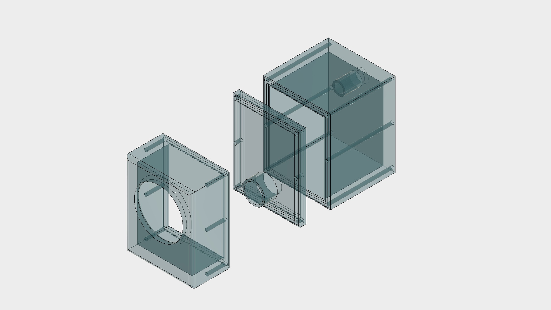

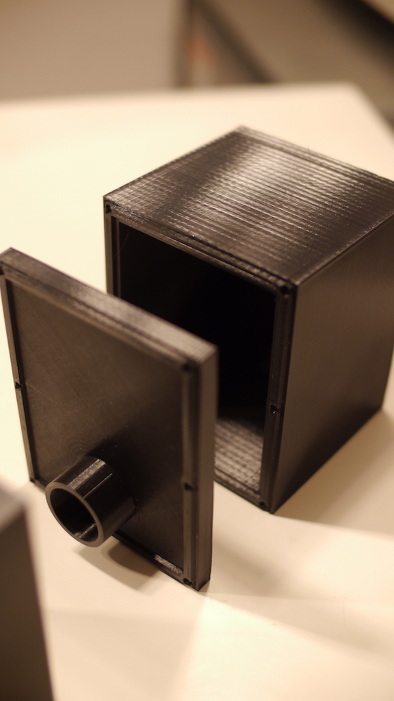

Ok, thanks. I modified accordingly. To minimize plastic waste, I'll print in three pieces and bolt together. If all goes well, they might be done tomorrow.

If 3D printing you should make shape non planar as standing waves can color sound. Especially backside wall behind driver. Make it angled and riddled with pyramids pointing in and out. But angled back wall not normal to driver will help a lot.

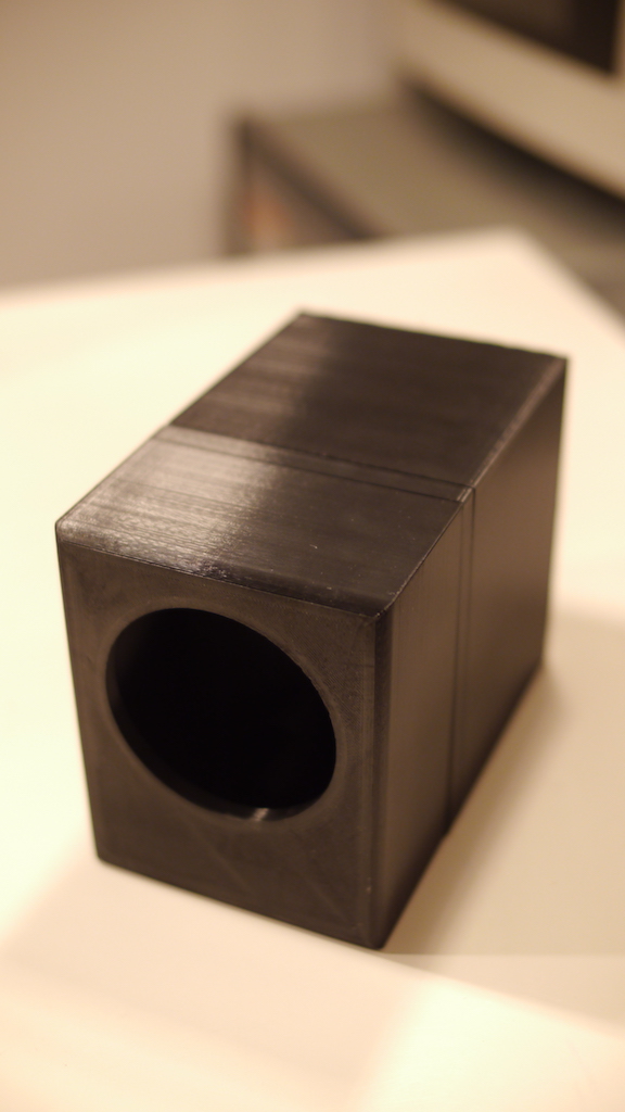

Great idea! I almost did that, but decided to start simple so I could compare the sound differences of optimized vs less than optimal volumes. Also, I decided to print in 3 pieces since it is faster and uses less "support" material. It would be also nice to experiment with flaring the port ends, but I'm not sure how to compensate by changing the port length accordingly.
Having said all that, the printing is slow. Two pieces are done. The last piece just started printing and won't be done for 36 hours. Fortunately, I'm traveling the next three days, so it will be done when I get back.
Once satisfied with volume, I'd like to experiment with the enclosure design as you suggest. Rounded shapes, fill with clay or other damping materials, flare ports, adding rigidity bracing, etc. All ideas to improve are welcome. As soon as I started printing, I started a design inspired by the B&W Nautilus. 3D printing opens up a lot of possibilities. I may have to get some viscoelastic printing materials for isolating inner enclosures, etc.
Keep the ideas coming...Will post pics when it is finished printing. Then onto measurements...

XRK971, yes the combined print time for the three pieces was over 50 hours and that was my fastest print setting (Raise 3D N2+ printer). I bought the printer used and the gentleman I bought it from was doing 800 hour prints. I've only have one print fail and that was when a shaft to stepper coupler broke.
This weekend, I hope to work more on a better enclosure shape if the measurements for the volumes and ports look good.
