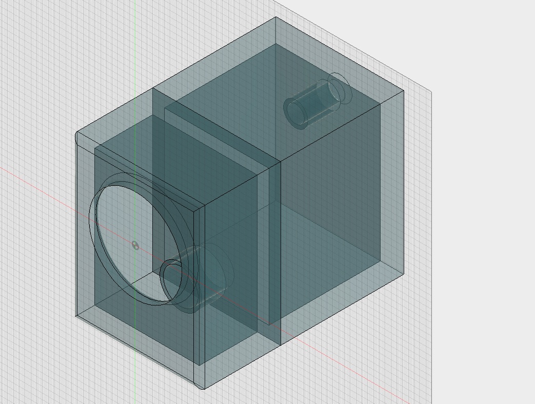

I have several FaitalPro 3FE20 8Ohm drivers I'd like to use to build a Double Bass Reflex (DBR), aka DCAAV enclosure. These designs don't seem to be very popular as there aren't a lot of threads discussing DBR enclosures. For those not familiar with the DBR layout, see image. Note it only has two ports, not to be confused with Double Chamber Reflex (DCR) enclosures which have three ports.

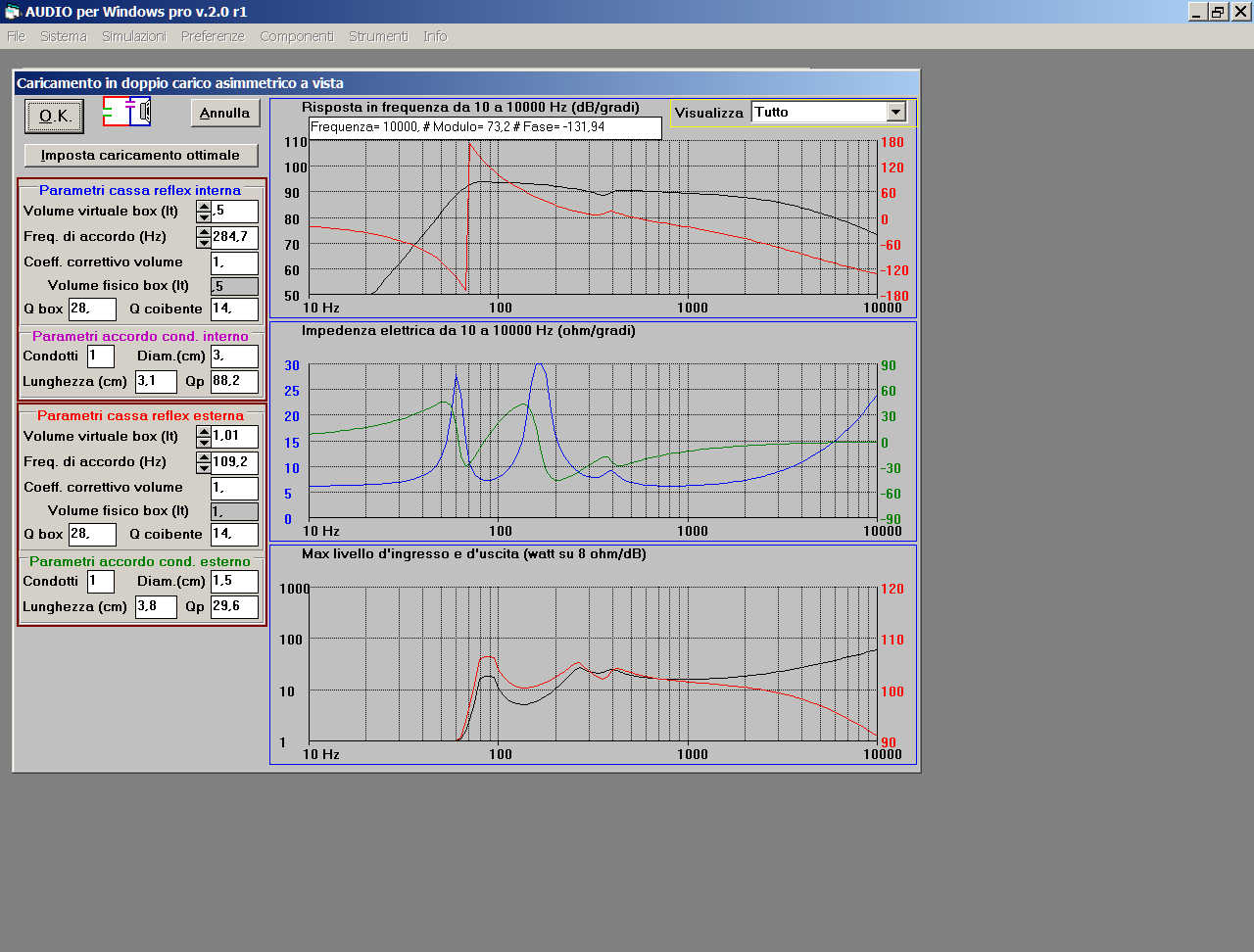

Take a look at the project I simulated for you.

Thank-you for the simulation! It looks as though the software you have specifically simulates DBR enclosures. I recall reading about Italian software (only DOS compatible?) on one of the DBR threads.
So it looks as though I need to model:
Driver enclosure volume: 0.5L
"External" enclosure volume: 1.01L
Internal port ID: 30mm
Internal port length: 31mm
External port ID: 15mm
External port length: 38mm
Seems simple enough. I'll try design a model today and 3D print it for measurements. Stay tuned...

From the little I could find on DBR enclosures, some mention an advantage of less cone excursion for the two lowest octaves, while a bass-reflex only reduces excursion for the lowest octave.
Take a look at simulation claudio kindly shares with us. DBR enclosure has less excursion only at 350 Hz, not "two lowest octaves". And there is a dip in frequency response at 350 Hz to penalize that.

Don't worry too much to the frequency dip, it's less audible than you can imagine. Pay attention at cabinet leaks, which can change the final response much more than what happens in a reflex speaker. Try to keep at minimum the absorving mat in the high chamber (the one with the woofer), and possibly don't use any in the low one (DBR it's a series resonance system, and the lower chamber efficiency depends on how much energy arrives to it).
Also try to place the 2 ports not too close to each other.
The software I used is called Audio for Windows, it's only in italian, and is available through the italian magazine Audioreview.

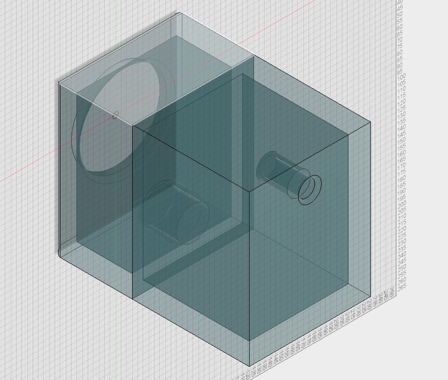

Here is a CAD mockup with the volumes and port dimensions based on Claudio's simulation.
I filleted the rear (external) port slightly (see rear image). Does anyone know how to compensate port length if you fillet or flat the port ends? If not, I'll start printing it soon.
Also, other than volume, does it matter if the internal port extends into the rear enclosure volume? I modeled the port extending into the front enclosure, but am curious.
In my experience, not really. It might help to place it in the middle if the port is too close to the driver. You can experiment yourself, measuring the impedance and paying attention at spikes in the curve. 😉
