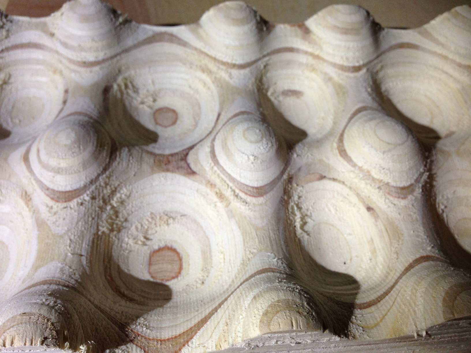

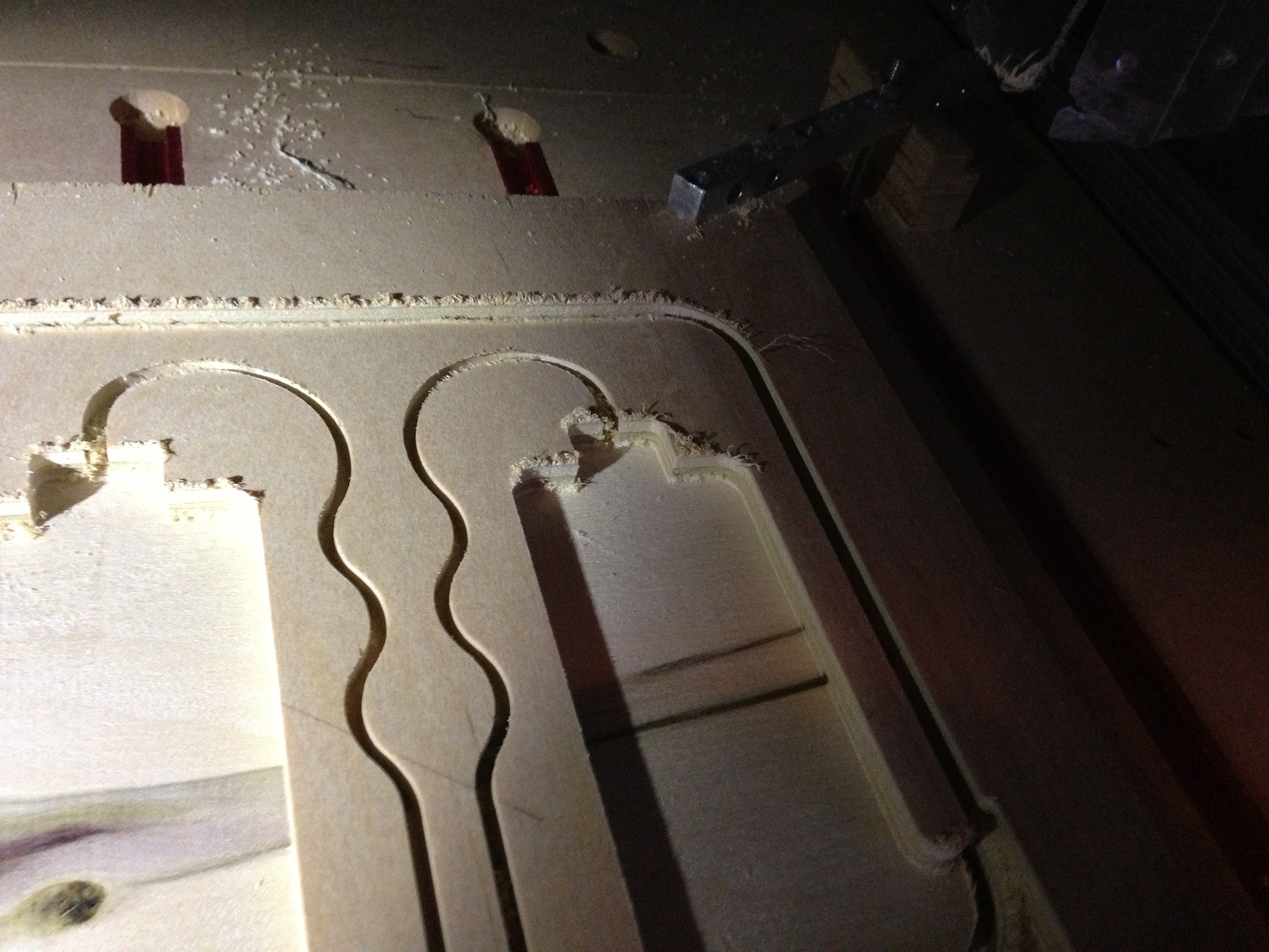

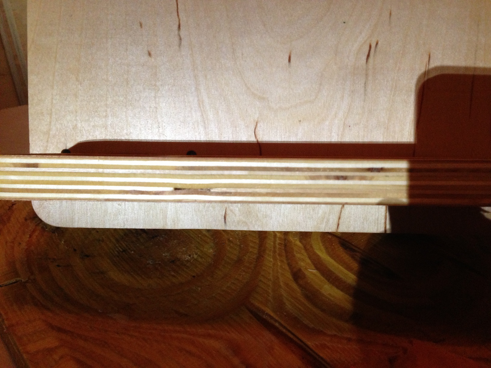

I did do some wood work today that clearly pointed out the birch plywood I'll be using on this project. Below are pictures of Lowes birch vs Home Depot birch. I've gotten 2 different quility birch plywood from Lowes before. Bad and worse. Yesterday I picked up a sheet of Home depot birch and has won me over big time. From what I can tell it is voidless, machines better than lowes, and much denser all around. The HD birch veneer on the ply gives a much better edge. If your local Home Depot carries the same Birch ply I'd highly recommend it.

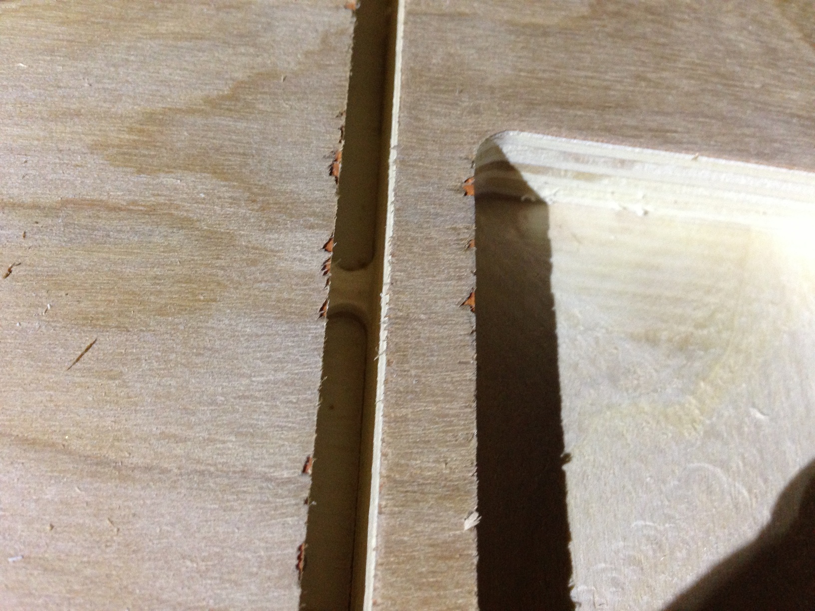

PIC1 pocket operation straight from my cnc on the HD birch (used a 1/4 2flute carbide upspiral for the pocket and cutout and a 1/8th single flute for the wire lead)

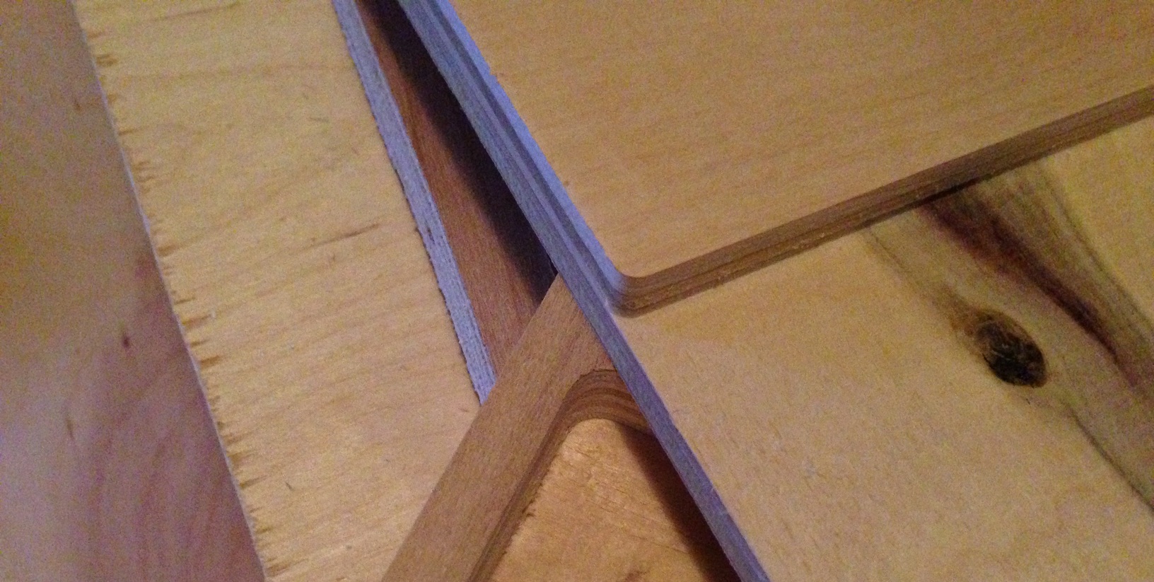

PIC2 after a light sanding on the edges

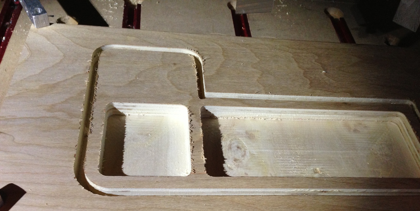

PIC3 Lowes birch right off the machine (used a 1/4 2flute carbide upspiral for the pocket and cutout) The edges look better than HD birch but it's a lie. The splintering is deeper and further in than the HD.

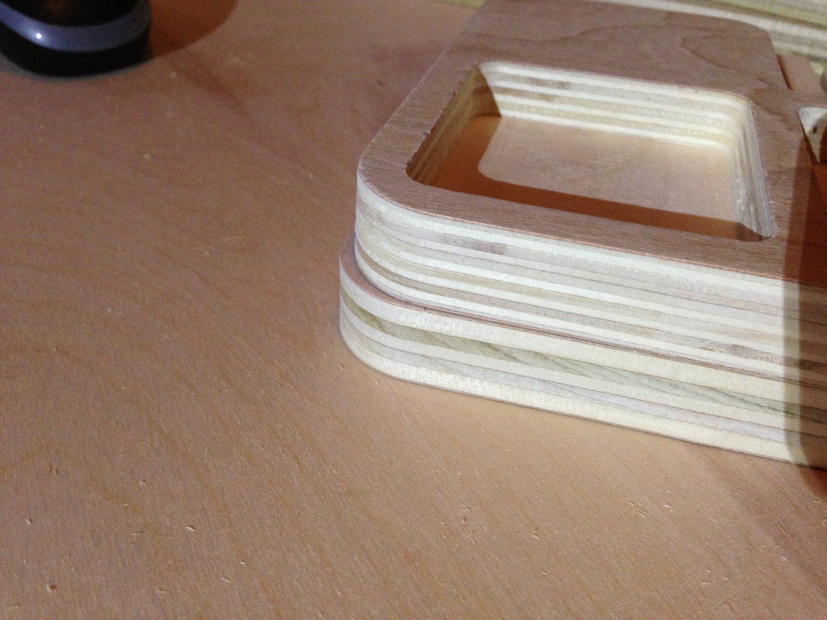

PIC4 Loews after a light sanding. Here you can see the difference between HD and lowes birch.

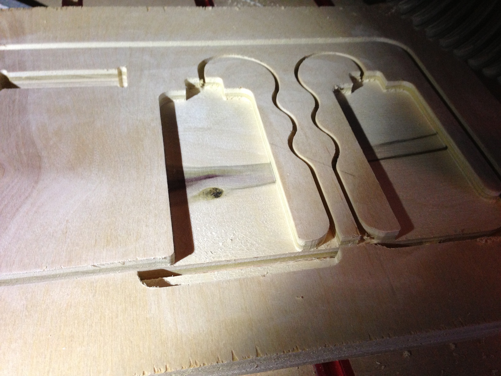

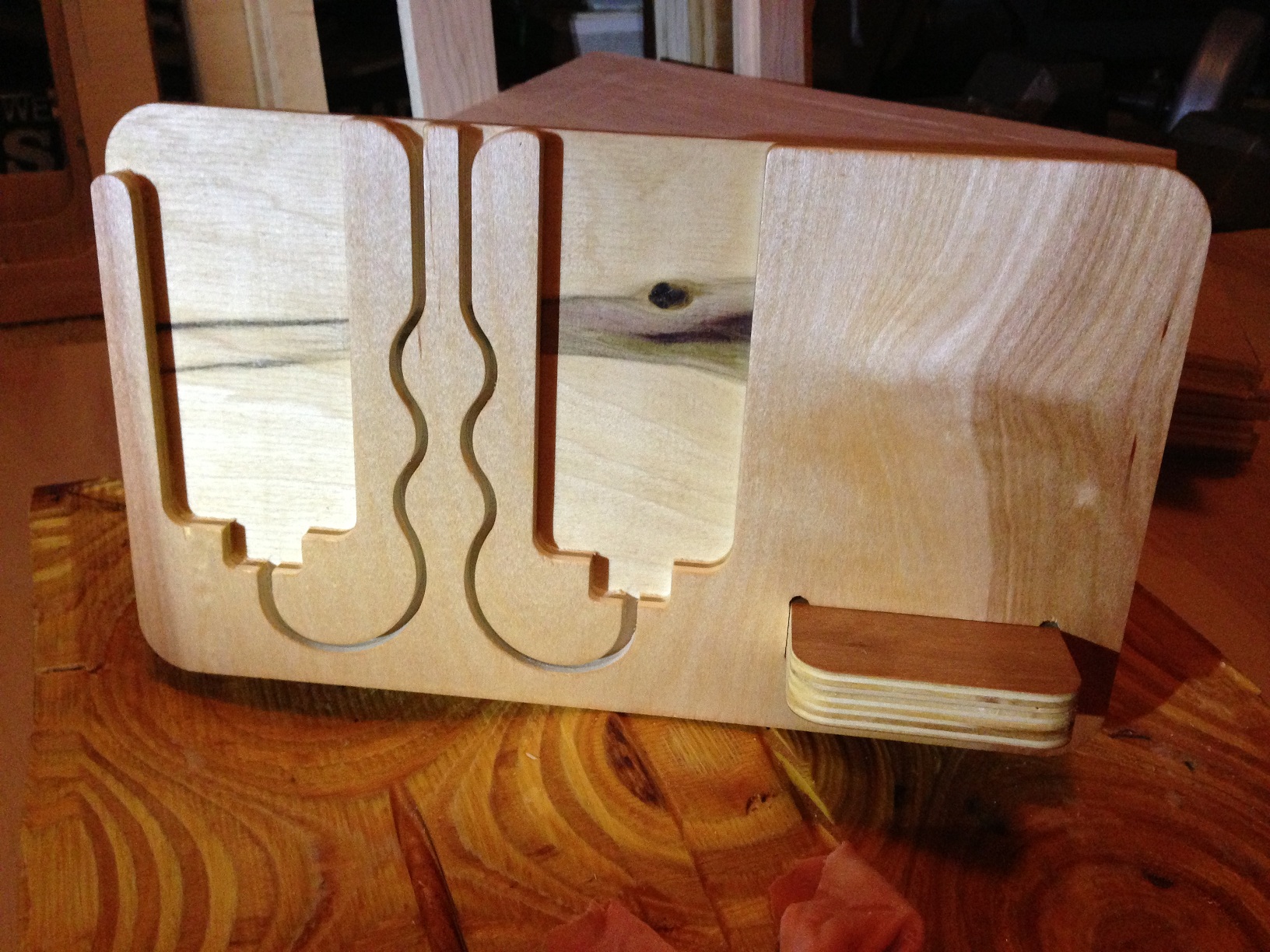

PIC 5 A corner comparison. Notice HD on top has thicker and more even layers than the lowes at the bottom.

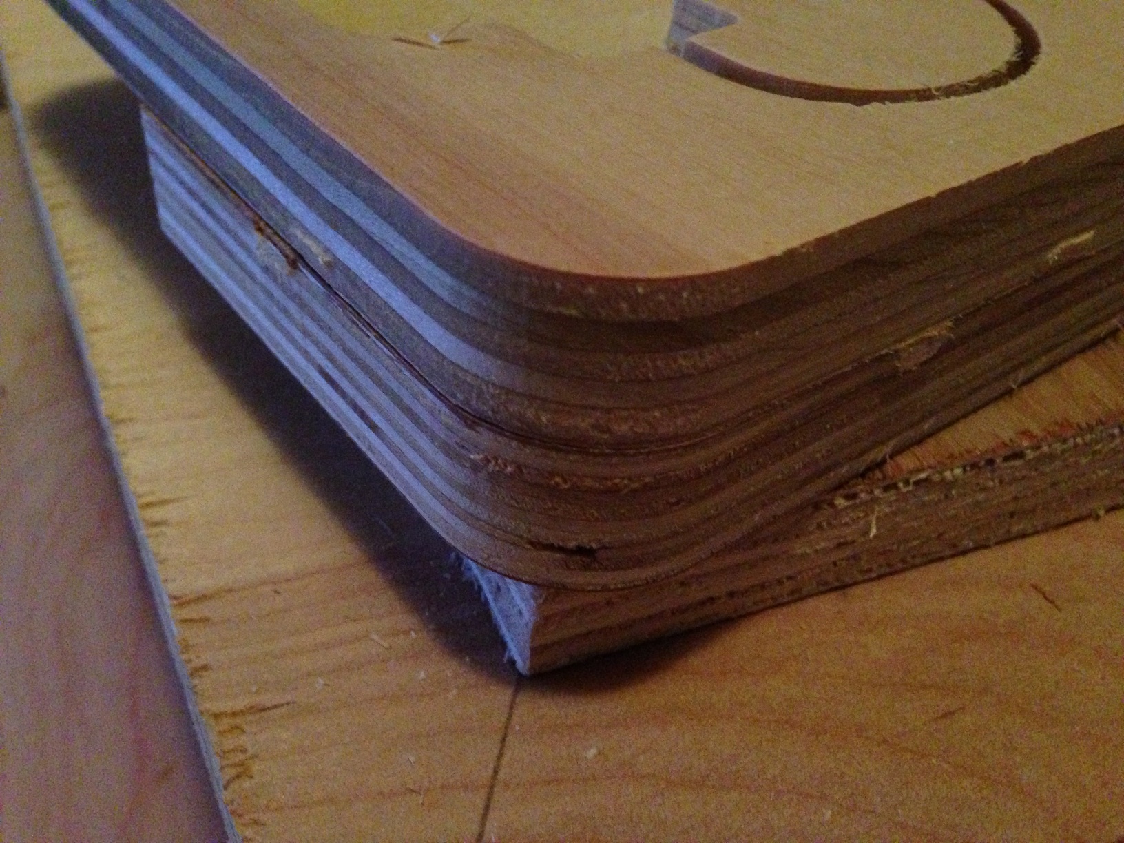

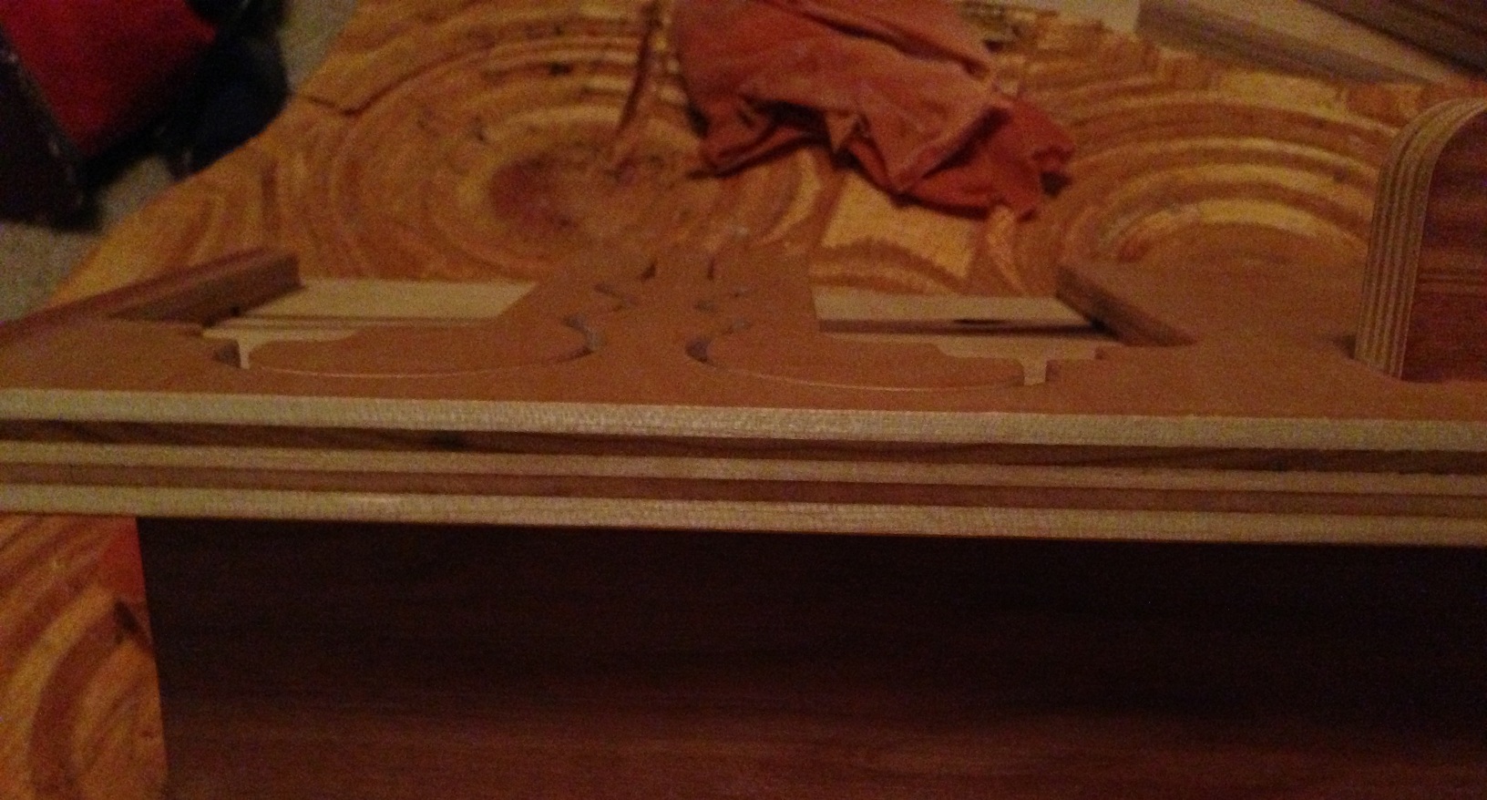

PIC 6 This shows a pocket operation up close. Notice the tool marks on the Lowes on the bottom is much more pronounced the the HD on the top.
PIC 7 HD on the bottom and lowe's on the top. The definition of HD's thicker layers is much more attractive to me.
PIC 8 Lowe's side view after sanding and application of linssed oil as finish. Uneven layers and voids.
PIC 9 HD side after linseed oil finish. I love it.

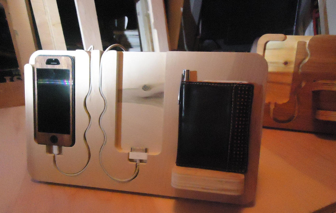

PIC 10 unfinished product afte sanding. Just so you know what you've been looking at. It's a his/hers, Iphone 4/5/ipod charging station/ valet. Mens wallet upfront. Girls wallet in the back with a spot for keys in the back too.
PIC 11 after linseed oil.

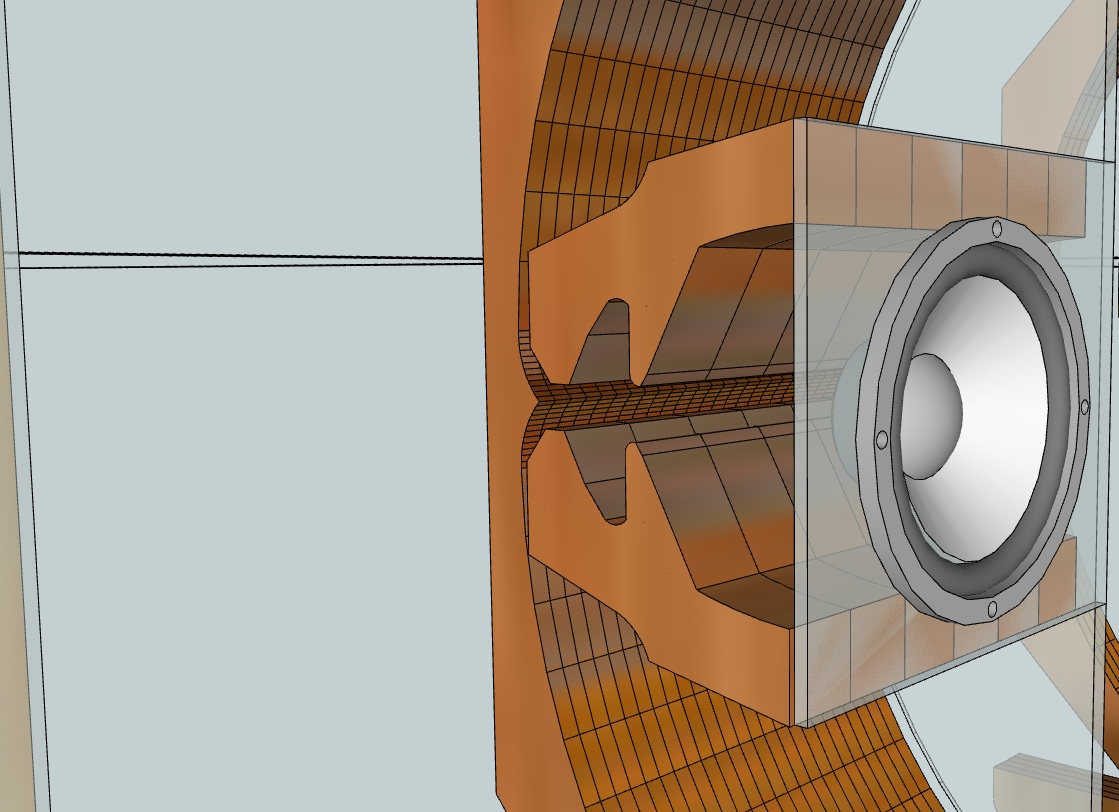

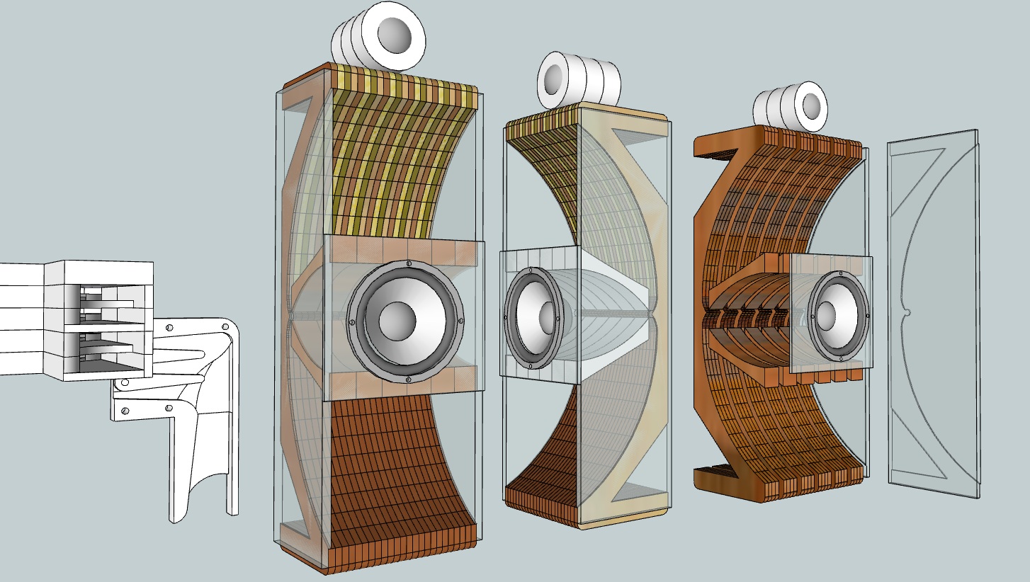

I've been thinking, reading, designing, etc.. Any-who, I'm kinda now leaning towards this minibvr I've designed. Does anyone think it would sound horrible?
I like the sound of BVRs, it Removes the horrible thump and bellow of Normal ported boxes.
Curved 'horn' paths from my recent errors with forward firing horns, ends up spewing a load of garbage out the horn mouth that ruins imaging and smudges the sound. Any front firing box I try next will have flat corners and folds to try and limit the high frequencies escaping and running the sound.

Thank you for the sage advice. I wonder if I'd added ridges to curves if that would help out. Give it a more bumpy path.

Maybe some of the smart guys will continue with this thread and give you the advice you need but on the surface I can see back wave cancellation happening in that last rendering.

Thanks... they are just google sketchup.
I think I may have found a solution. This guy was planning on doing a curvy BVR. He has these little ridges towards the back of his inlet in his drawing.
