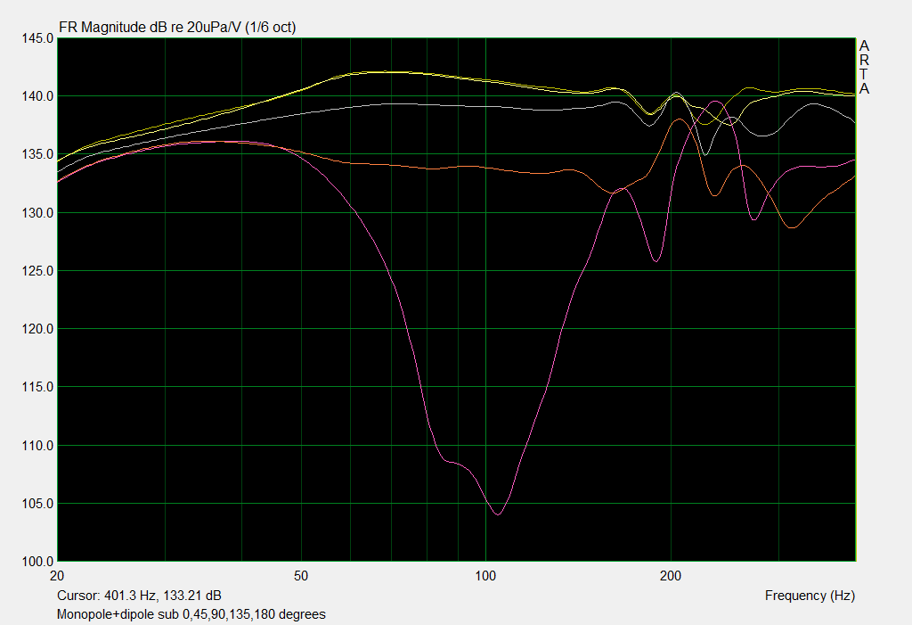

Currently i'm working on a new speaker build, aiming for a cardioid radiation pattern from 50Hz on up. I have made a prototype consisting of a top cabinet which has a A&D R1030 10" woofer in a damped Uframe, and a Hypex PSC 2 400 plate amp (2 ch amp + dsp). I experimented with the opening of the Uframe, adding slots and especially the placement and quantity of damping material. See attached files for the optimal polar pattern. For high frequencies, I have a B&C DE250 on a Dayton 10” waveguide. I modified the waveguide slightly to accept the bolt on compression driver and remove any irregularities in the transition to the waveguide.
For the sub cabinet, I have 2 Peerless XLS10 woofers and a Hypex PSC 2 400. In order to achieve cardioid radiation, I have combined a sealed and dipole enclosure. The dipole is high passed at 50Hz using a 4th order filter in order to limit cone excursion and to have the advantages of a pressure source <50Hz. Free field measurements showed a polar resembling cardioid from 63Hz on up.
However, there are some points for improvement for which I would like your advice!
1. In order to achieve maximum suppression of LF at rear, I had to delay the monopole sub by 1,9ms. This resulted in less than optimal summation of the two drivers at the front. The dipole woofer is actually positioned 20cm behind the woofer in the sealed enclosure.
2. The polar has a maximum which is about 20degrees of center, caused by asymmetric construction of the dipole. I think I will make a new version using a regular H frame.
3. I’m considering adding passive radiators to increase output of the monopole <50Hz for LFE use. I’m a bit concerned this will complicate achieving cardioid radiation in the 50-150Hz region.

Thank you for your reply! Im trying to understand why it would only work at one frequency. Measurements indeed show attenuation around a maximum at 100Hz. See attached off axis repons measured outdoors without gating, at 2meter distance, at 0,45,90,135,180 degrees. Attenuation shows a maximum of over 25dB, which was probably more since the respons was "dancing" on the wind at 180degrees.
Im also having a hard time understanding why the monopole needed around 1,9ms of delay to get max attunuation at the rear, while the monopole is actually positioned more to the front.

Interesting point. Only, im not sure how close the null would be to the speaker, since the respons of a dipole is different in the nearfield. Tailoring the filter for the dipole to the specific distance to the wall, might eliviate this problem wouldn't it?

Okay, if a monopole and a dipole are to give cardioid response then we can ideally use no extra delay and just set their 0 degree (and 180 degree) strengths equal. In theory that will cancel rear firing radiation and give us the cardioid pattern.
In practice the responses don't match as the dipole will be rolling of 6dB per Octave. So lets equalize that to give as close to the same response as possible. Again, if anything varies with distance then we need to view from a distance equal to the distance from the listener to the rear wall virtual speaker (the reflected one). In practice I don't think it matters much as long as your measurements aren't too close to the system. Note that we are going to equalize to match the rear firing part of the monopole, not the usual front firing part.
Now our dipole and monopole aren't coincident in space so we need to adjust for that. It looks like your monopole is in front and your dipole behind. That means, when considering the reversed virtual system (the one we want to cancel) that the dipole is closer and will need some delay applied to it.
In the end, if we can look at the rear radiation of monopole and dipole, set them to the same level, the same frequency response and the same effective delay (but of course of opposite polarity), then we will get perfect broad band cancelation.

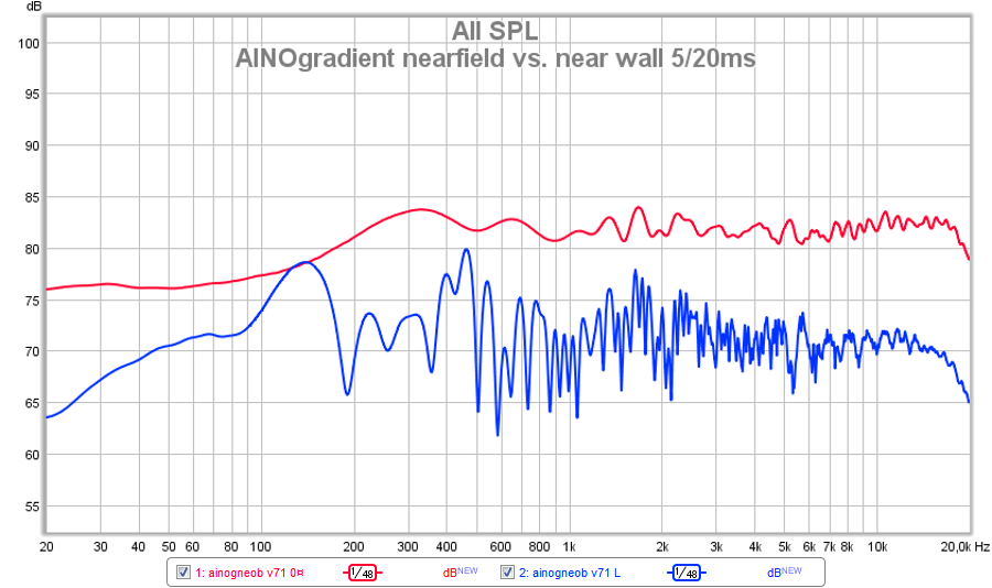

Been there, done that! That was my intention... AINOgradient has monopole bass crossed to dipole mid somewhere between 100-200Hz depending on settings. This question is furthermore corrupted with difficulties with indoor measurements...
About frontwall reflections - every speaker has them, but dipoles have most severe. Peaks and dips (summing/nulling) also happen at different frequencies for monopoles and dipoles. The first null is strongest, multiplities are weaker.

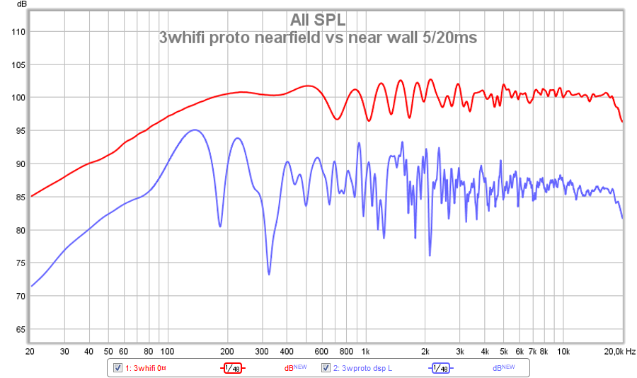

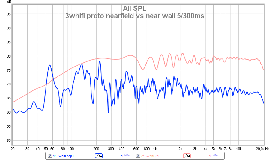

In real world (my living room) - I have measured a dipole and monopole speakers, and difference of a sealed box mopole and dipole are not as great as one would think. AINOgradient (avatar) is dipole between 150-3,5kHz.
We see floor bounce at 180Hz and front wall reflection at 320Hz. Here are nearfild measurements (5ms speaker in the middle of the room) and 20/300ms with speaker some 80cm from front wall (actually window!) Peak at 1,8kHz is mystery to me, possibly window glass resonance.

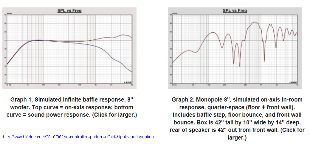

I show also a LEAP simulation that I captured from here The Controlled-Pattern Offset Bipole Loudspeaker
