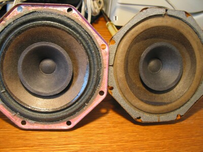

sandy beach.. oops, driver..
Hi Planet,
Well, I have nothing to loose.. Either I throw it in the garbage can, or I attempt doing something..
So, removing the dustcap might be a solution.
One more question. As I told you, I have 4 of these drivers. Two with the cloth(and tar covered?) surround, (one of them being the faulty driver) and two with the.. well, see the pic..
Other than the suspensions, the drivers look the same to me. Am I right?
I think the stiffer suspension must be more adequate for a TQWT, no? or a back loaded horn (Swan)? am I right?

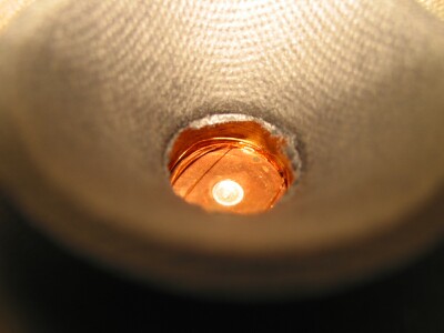

Hi Planet,
Just removed the dustcap and.. look what I found? loose wires from the voice coil.
And pulling the cone outward a bit, shows that it's as if the voice coil and it support have broken, half way to the cone, and a the unattached part of the coil remained stuck within the gap..
Since it still emit sounds.. I imagine the wire is still in one part, unbroken, but I can't see how this could be repaired..

Re: sandy beach.. oops, driver..
Both look like they have treated half-roll surrounds. One looks a tad narrower. These also came with accordian surrounds.
What are the numbers on the back?
dave
dave

Re: pic
That is unlike any philips surround i've seen before.
The accordian surrounds are usually just an extension of the cone.
dave

Re: Voice coil
Looks like someone cooked the coil enuff to disintegrate the glue... to fix you would have to completely disassemble then rewind the coil... not an easy task.
dave

twins are not all alike..
Hi Planet,¸
Well, funny. Two drivers of same model, but not same year, and not same suspensions..
In fact, the model with accordeon textile with tar on it, was in a box that was "vented" at the back, by a small slot at the bottom of the cover, while the other driver with half roll suspension was in a sealed box. Same size of box, exactly.
Looks like Philips made a lot of drivers variations on same theme..
A little bit like using left overs, to cook different meals all week long.. 😉
