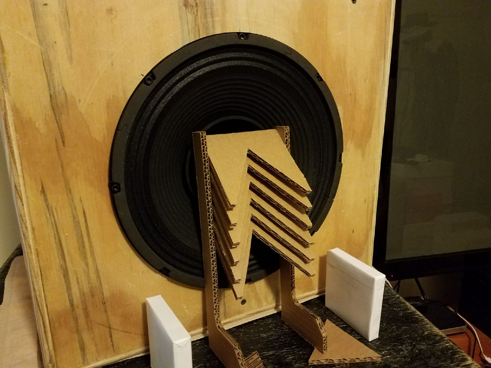

I made another prototype lens, but this time tried something a bit different than what I've seen. I couldn't see what the very wide plates were doing where the width of the plate was outside of the horn or driver line of sight, other than it's recommended to leave the sides of the plates unobstructed.
So, I shortened them to just the min width to cover the small whizzer, about 4" wide. I also changed the vertext of the angled cutout, where previously I had a ~R 3/8 radius at the vertex, this time I just did a sharp angle - thinking that this would lessen the slight hot spot at the center even more. So 2 changes at once, not too good for scientific experimenting, but short on time and was hoping for the best...
I'll have to get a picture to post up here, but in short it doesn't seem to work as well as the full width version. Dispersion is better than without, but not as good as the full version. The packaging this way is much better I think and could be made stronger/more durable, as well as it being smaller widthwise and potentially easier to tuck into a grille cover (Or, as I had been thinking, maybe even into between the "curtains" of a Karlson K12...)

I am guessing the lens should cover the radiating area fully. Perhaps if there is a sharp crossover frequency at which the main cone stops contributing and the whizzer starts, you could get away with a lens just in front of the whizzer. Otherwise, I would suggest extending the deflector plates vertically to top and bottom of the driver.
And, also guessing, the width of the commercial variants if probably no coincidence, is this perhaps necessary in relation to wavelengths of the lowest frequency required? Just thinking out loud, if you manipulate/delay the soundwave to a certain effect, you probably want to do that for the entire wavefront. Not just the middle bit.
From the brochure stuff I've read so far, these lenses don't seem too deep, but wiiiiiiiide. Maybe those circular perforated plate lenses are better if width is a concern?

Ivo, I forgot to snag a picture, sorry. I've only read that the plate spacing limits the upper effective frequency of the lens, but it's entirely possible that the width has an effect on what the lower limit is. For the Fane 12" FR, it's really only the peaky stuff up at the top end of the graph that needs dispersed.
Re: wavefront delay, I don't think the difference in arrival time is probably much at all - not sure if it would be perceivable to anyone. The path length is only 1.65" longer thru the lens. For my narrow lens, part of my thought was just to limit how much "punch" I'm blocking that should be emanating from the main cone.
The perforated plate design is probably wayyy more flexible in terms of how you control the dispersion, since you can control both horizontal and vertical dispersion that way. In my mind, there's also a danger of "muddying up" the sound more since it has to bounce around inside that type of lens more than the angled plate design. Mostly I haven't tried it yet because I didn't have any perforated steel grille material laying around. 🙂
Just a bunch of assumptions and suppositions for now though... more reading to be done, and need to catch that fellow Freddy recommended. I had found a document by Dr. Geddes that seemed to have some math in it for calculating some angles, but it was a bit hard to follow without a background in that sort of thing. If it's permitted, I could probably dig that up and post it - it was an AES publication from long ago.

It looks different than I would have expected though. I would assume narrow fins/short pathlength at the center and broad fins/longer pathlength toward the edge of the cone.
This is very similar to what I expected, you are interested in spreading out the high frequency sounds that come from the wizzer, not the lower frequencies that come from the main cone.
