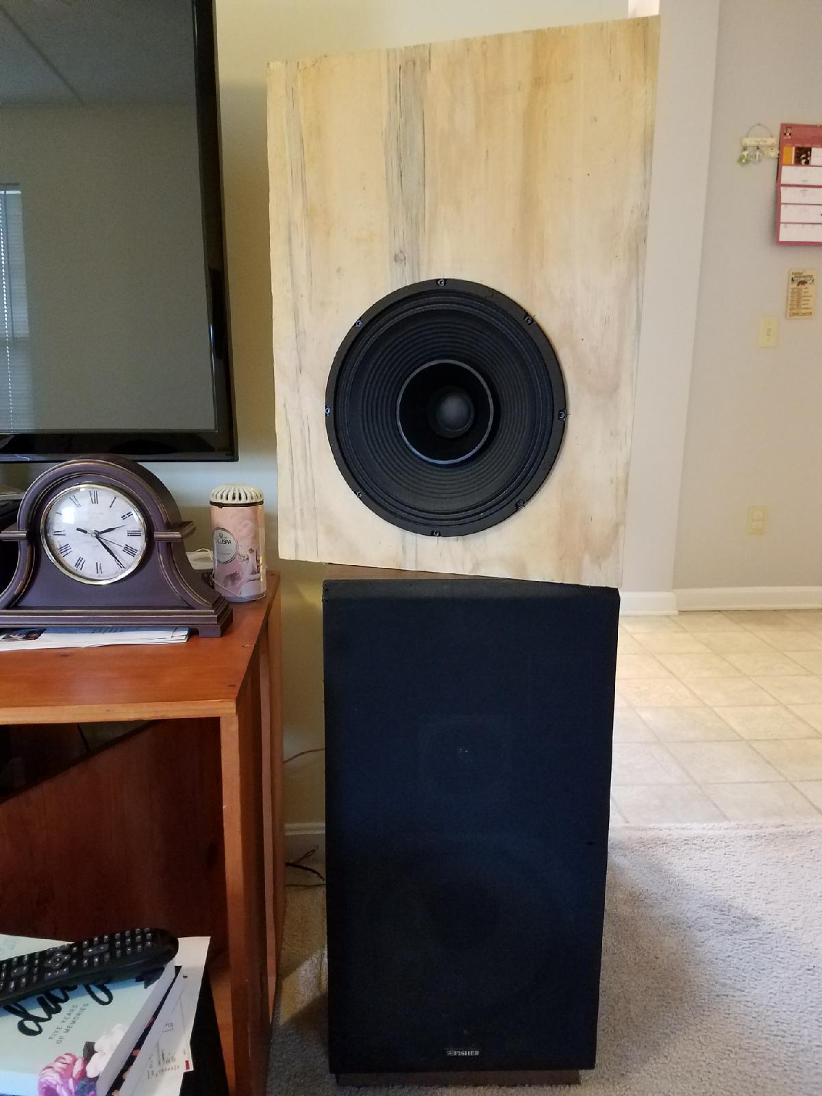

I've been working on the helper woofer section first, so not much progress here yet, but one 18" helper woofer is up and running in a large ~10cf prototype cabinet.
Now I've started the prototype box for one of the full range drivers. The volume was going to be around 6 cf sealed (if I'm recalling correctly from memory), but we had talked about going smaller and trying an aperiodic design. I settled on 3.75 cf (~100 L) sealed to try first, with the plan for the rear baffle to be removable and it could be "holed" to try aperiodic as well. I went much smaller on volume as it didn't seem to hurt the graph much, and was hard to tell the difference after a highpass filter was applied around 150 hz (where my xo will be). So, smaller being more manageable (as compared to the monster woofer cabinet anyway), will hopefully be as good. One again, the published hole dia to cut was overstated by like .19", so I hope I have room for my hurricane nut holes - that's rather frustrating, I should have done a test in cardboard first, but was in a rush. Pics to come...
Should I do anything to the drivers, or try them as-is first? I was thinking of just adding some insulation to the basket spokes, and some putty and insulation around the magnet. Nothing irreversible.
Unless open baffle is 2' deep (and crossing at 150hz) i wouldn't bother.
But, maybe a 2' cube with an open back is an option.
I had luck with that cube with 4 x 4" tang band bamboo.
Just stick some foam behind driver.
This is coming from the guy that had a philips 12" full range driver in a phy open baffle (2' deep), no bass, not much midbass, but that fane will do better with twice the measured qts.
Hmm. Well I can try it open baffle with just the baffle I've already cut for the actual sealed box. But I wouldn't expect much, its probably too small - 18" wide x 24" tall. And it would only be... maybe 18-22" off the wall.
I'm after some heavy bass and midbass from it... it's got to sing with authority from ~150 hz on up.
It's got to keep up with the 18" woofer 🙂
Open baffle with the Fane is.. interesting. It certainly is very open and the speaker blends (acoustically anyway) into the room. It's also noticeably more even in volume as I move around my downstairs (circular floor plan, so it's not all that much area to cover anyway).
But, the midbass just isn't there. Even with the bass knob cranked on the receiver, and/or the low end propped up on the EQ, it just doesn't have much midbass.
I'm eager to get it into a box to hear it. Hopefully find some time in the next few days to finish gluing and screwing the first test box together. 🙂
Yeah, a baffle this small is only going to load down to ~350-500 Hz depending on location when not up against a hard wall, corner before rolling off at ~6 dB/octave and even then the mid-bass won't be prominent except with very high Qt drivers.

Testing as open baffle with small baffle (actual box front baffle)
So it may not be a fair test, since the baffle is too small.
Thanks GM.
