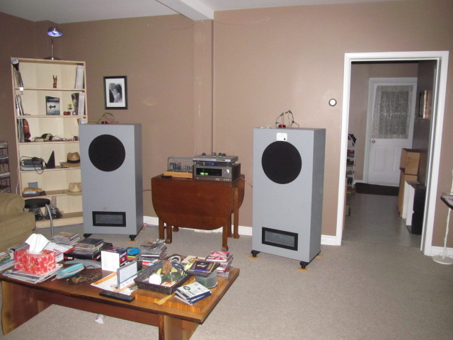

Thanks Freddi,
So the k-aperture will only disperse the sound coming from the main cone?
Also from your video, I just saw that the Klam has the k-aperture oriented the other way 'round vs the std. Karlson.. does it not matter?
I did see in another post somewhere that the reason for having the baffle at an angle to the k-aperture curtains is to prevent a resonance. If this is true, then the baffle in mind would likely need to be vertical, and the k-aperture would be at an angle from that (probably sloping back for aesthetics anyway).
IF the full range is up off the floor a good ways (up on top of helper woofer cabinet) away from children's prying fingers, and
if it will still work with the speaker baffle oriented vertically, I think I'd like to give it a go... 🙂
Probably a modified Karlson, Karlsonator, or XKi then (or Klam, etc)... Since the full range in the k-box will always have a large helper woofer handling the low end up to 150-750 hz somewhere, is there any reason to go with one type over the other?

So opening of k aperture down for floor speaker, opening up for ceiling speaker, got it thanks! Not sure if it matters which way for me since the driver will be up at ear level stacked on top of woofer cabinet.
I'm curious to see how it sims in XKi vs a k12 or karlsonator, though i should probably be more worried about smoothing out the mids and highs rather than the bass extension, since it will run with helper woofer.

Hmmm. So perhaps I'd have to try a k tube...I think whizzers don't work well behind a K aperture. - Xrk971 from XKi thread...
They don't IME with the K15, which was when I was 10-12 yrs old [hence very keen hearing] and no inexpensive 12-15" [i.e. with/without whizzer and/or with the funky scalloped ring radiator] we tried worked well in it, even when just reproducing an AM radio's 100- 5 kHz BW, though made a serious 'bass' bin [mid-upper bass actually since there was no real bass on recordings] in a corner.
It so turned me and its owner [40 something next door neighbor] against it that when I joined the audio forums I was one of the 'bashers' of this really bad audio 'joke' until Freddy got me to take a serious look at it many years later, showing where it was really designed for the upscale Altec and similar duplex speakers, which makes more sense, but truly 'snake oil' marketing made sure it would be ~uniformly scorned. That, and few folks had a clue how it worked, though didn't fool at least one industry pro, so no doubt others 'practiced in the art' of acoustics.
More recently, I've experimented a bit with K-tubes and combined with some of Freddy's measurements, it seems the way to go IF [big IF] such a super wide polar response is desirable, which normally means either a mono or really large room app. Could be just the thing for when one has a high aspect ratio room and want to use the long walls in lieu of the traditional narrow sound wall and adjust the listening distance.
All that said, I will still continue to only recommend it as a compact mid-bass horn up to 250-500 Hz BW depending on how much 'ripple' one will likely tolerate.

I see... I do recall reading previously that the Karlson type enclosures were better suited to larger rooms. (But had forgotten)
I will probably try a prototype box out of OSB to see how it sounds. Maybe do a prototype k12, sealed, and aperiodic em-ken to try the fane in... see what sounds best to my ears. Not sure if I would notice that ripple or not.. probably in a tone sweep, but in music not sure.
