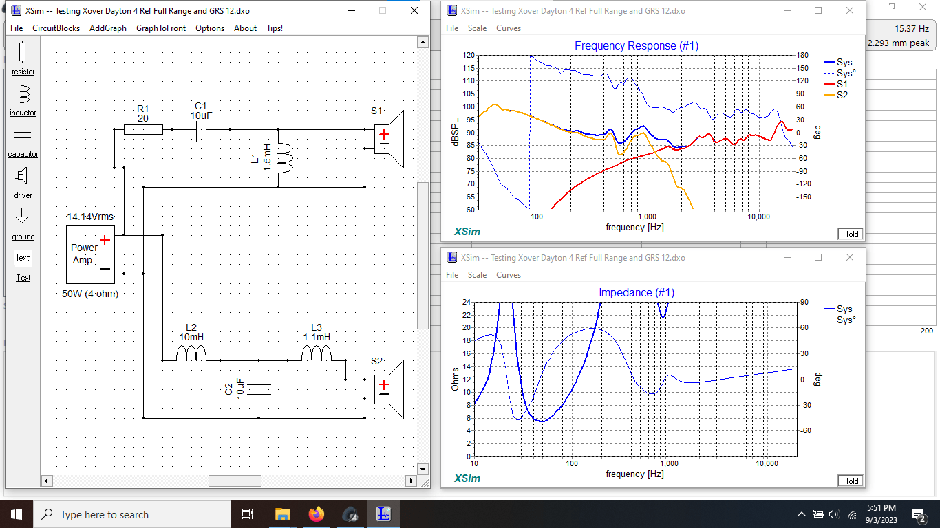

Toying with a crossover in XSim. This is my weakest point honestly. This may be a bad match of drivers, but I'm trying to smooth this out a little assuming a passive crossover approach. Was thinking of crossing closer between 120~250hz between the 4" full range driver and the 12" bass driver. But wasn't able to get a graph I liked so far.
I know I'm not modeling an Open Baffle in this, I was just toying with these two drivers in XSim mostly to remind myself what things even are in the crossover network again. I need to learn to use BASTA for the Open Baffle modeling, but there's even less tutorials out there for that, so its slow going with trial and error. That said, back up plan is to just mount the drivers and use UMIK1 and REW to build measurements to model from and use active DSP/EQ to handle the response of the drivers and baffle.
https://www.parts-express.com/Dayto...ce-Full-Range-Driver-4-Ohm-295-378?quantity=1
https://www.parts-express.com/GRS-1...r-Surround-Subwoofer-4-Ohm-292-820?quantity=1
This crossover and impedance looks absolutely awful lol. Sigh.

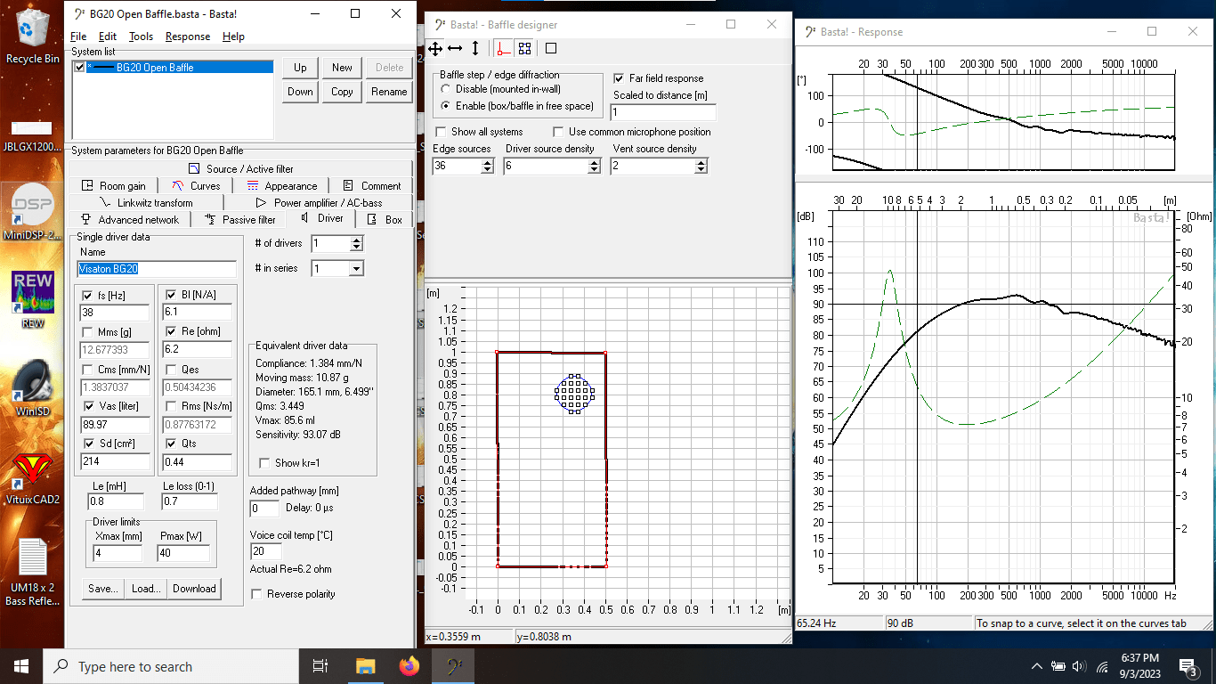

Playing around in Basta with the Visaton BG20 to get an idea of baffle width and effect.
Treble falls off rapidly. Any tips with the baffle shape or width to bring it back up at all?
If I could get that response to 100hz or so, I'd be happy with that for an open baffle stereo and would plan on bass reflex 12" subs integrated in the bass. Or possibly explore slot loaded bass drivers.

I take it you're putting the driver up in the corner while looking for smoothness on one axis? It can be difficult to see a way out when looking at things from this perspective. It means that most of the baffle is only there for minor support of one axis but is doing little to baffle the front to back path which may be dominated by the corner. Are you clear on the purpose of open baffle in your case or just trying it out?
I wonder if this is one of those cases where too much information can be unhelpful since there is usually no clear answer to many open baffle questions. Have you seen Pano's recent journey setting up an open baffle? - https://www.diyaudio.com/community/threads/18-coax-on-open-baffle-bm18cx-38.402195/

Thanks; was just looking at the different response and yes just trying things to see how the model changes. I'm very new to Basta so trying to get a quick dirty feel for what does what.

That's true, but not what I'm talking about. If I asked someone to define the aims of a monopole (regular box) design, they may.. but what are the aims of an open baffle? Is there a definition of perfection that you can design toward, or is it a matter of finding out what is audible and what isn't?

Hrm, mostly I just like the idea of less boundary interaction, off axis SPL dropping a lot and the overall airy sound of the mids. I am one of the first to admit that I'm rarely after perfection, nor the idea of flatness, I know I like a little more sub-bass than is true to the recording and I actually dislike humped up mid-bass. I've listened to some open baffle but haven't made some and I fancy the idea of trying it and tweaking and all. If I can make something decent I'd love to make some out of some attractive wood slabs. I love how those look. I have the BG20's just sitting here so figured I'd try them. But also want to try some of the inexpensive Dayton Reference ones that are smaller. Otherwise, I really like the value in the Lii Fast 8's for cost. I may get those next.

I didn't mean perfection of course, I meant is there a defined purpose where you can say it is achieved...
OK, you mentioned less boundary interaction so that means you want the nulls to the sides. This means you don't want an open baffle per se, you want a dipole. A dipole is a special case of open baffle where the directivity is the goal. It is possible to aim toward this specifically so analysis like you were doing above can take on purpose. Of course, you won't be looking so hard at the on-axis performance and more on the quality of nulls.
A dipole is a funny thing as a speaker. It has nulls to the sides, but extra sound to the rear. Is this a conflict of purpose? I'd look at what the dipole builders have to say about placement within a room, to learn the way to benefit from this speaker type.
