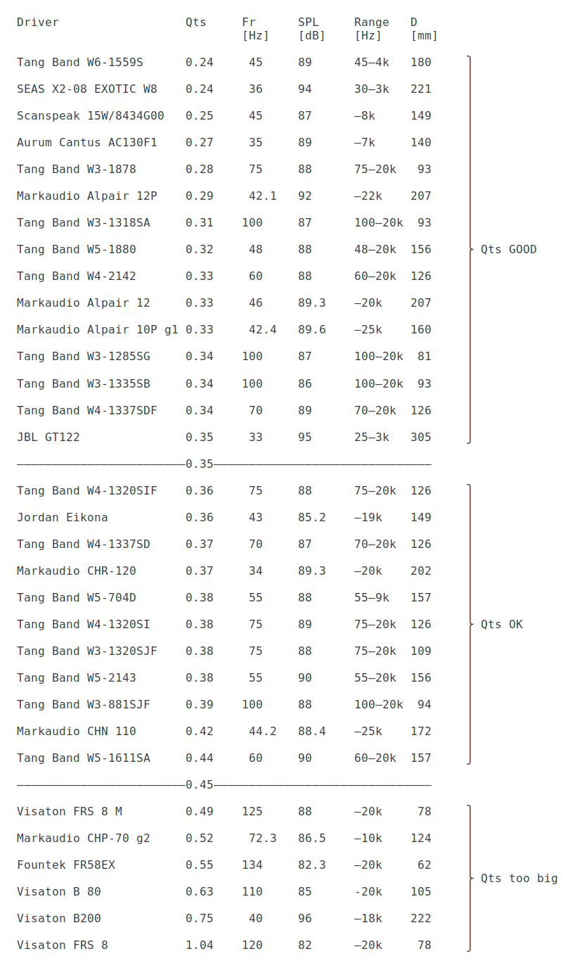

Some time ago I was pondering about building an aperiodic WAW and I had been searching for interesting low QTS speaker drivers, both wide-range and woofer. Because there seemed to be many candidates, I created a simple table.
According to Aperiodic Cookbook QTS less than .45 means that a speaker driver is probably suitable for aperiodic speaker designs. But, if you are not interested about aperiodic, this table may not be very useful for you.
