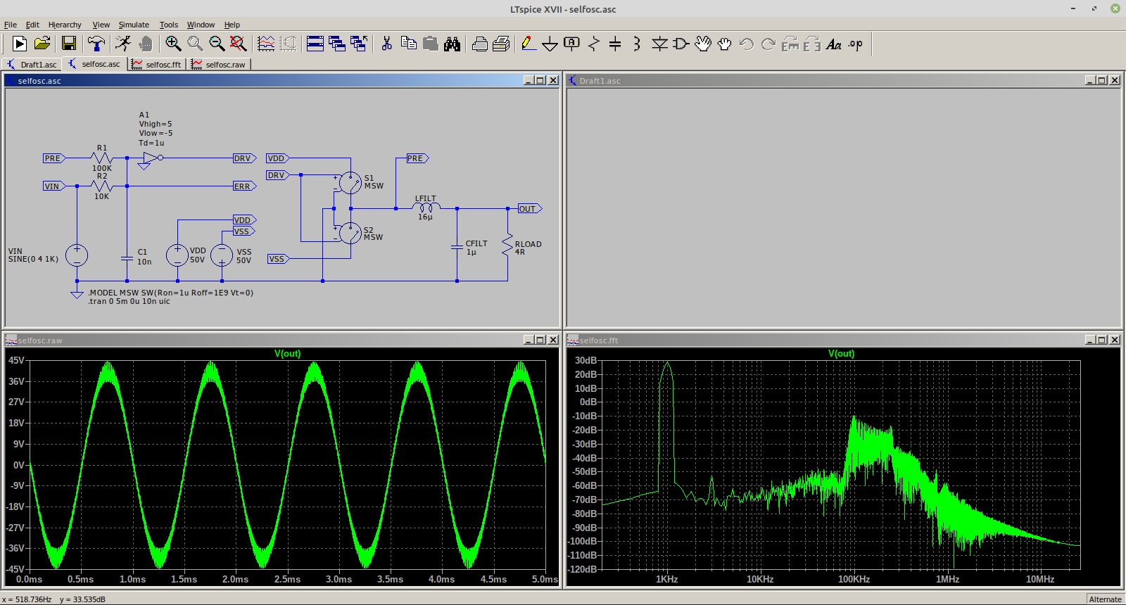

At the risk of using the wrong words the attached is a model of a first order self oscillating Class D with pre-filter feedback.
The zero output switching frequency is set by the time delay in the gate. In simple terms it notices an error then takes Td to respond accumulating the opposite error then flips back recovers the error then takes another Td to respond.
That works out to be 4 x Td. In this case 250KHz. When driven with a signal the self oscillating frequency varies according to the output level.
Picture plus LTspice asc.
What happens if you replace A1 with your FPGA and program the delay to adapt it in order to maintain a fixed switching frequency?

@MorbidFractal:
Well I know what you mean, I know the self-resonating concept. But I have never seen it somewhere implemented in some pure digital logic. I know it only mainly from the IRF designs.
Actually the self-resonating concept is also only some kind of a 1-Bit sigma-delta converter, but without any external clocking.
But interesting hint, would be definitely worth it trying out what happens actually.
