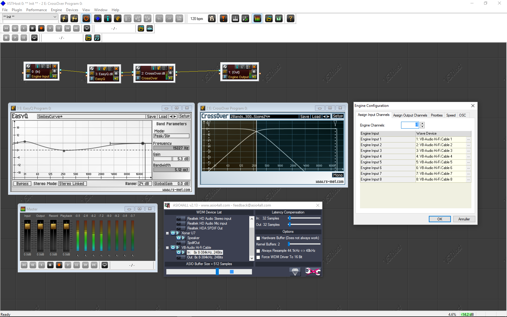

Gentlemen
Yippie ..ASIO4All appeared.
Now I am stumped…..
I think….I should be focusing on “Devices”
Select Wave Devices
I selected the OUTPUT to ASIO4All and the input went greyed out.
This is what I managed to get:
Engine Input – regate – reaeq – recomp – engine output….
Now I am stumped…..
Select Wave Devices
You can double click on the lines. The window you get is where you assign your inputs and output. You can change position of effects, and on the line just before engine output, you can assign output from crossover to outputs on your soundcard.

Hi Kjeldsen
Thanks for the information.
But I am not sure what I am looking at and what setting I want…
No I do not have ASIO-Bridge…..
Should I get it and what is it????
asio bridge and the normal VB cable is here
VB-Audio Virtual Apps
Some soundcards have something similar built-in called re-wire or something similar.
The essential for these things is that they send all sounds from PC to the VST host.
This is similar to a mixer, if you don't route the channels to main output or to busses and then main output --> nothing happens - no sound. Windows can't do it on it's own, that's why there stuff like virtual audio cables.
In windows I set-up Hifi Cable (asio bridge) as default sound device for input and out put. Youtube, Spotify etc will now play through Hifi Cable.
In foobar (my music player), I just tell it to use Hifi Cable instead of output directly to sound card.
In VSThost you just tell the engine to take input from Hifi Cable output. Now everything goes into the cross over.
In writing it looks complicated, but it's no different than having cables from physical items (CD, DAT, Tuner, recordplayer etc), and put them into a preamp and from preamp to crossover, and from crossover to amplifiers.

· Cable Input
I have made Hi-Fi Cable Input default – no sound, but the bars go up and down.
I make Realtek Digital Output (Optical) – sound….
OK there is something you have not told me?????😕😕😕😕😕😕😕😕
You need to change output device (Recording) to Hifi Cable as well, and not Realtek digital out.
Both Playback and Recording device needs to be Hifi Cable.
In VST host you need to set-up Asio to output to Realtek digital output, and input should be Hifi cable (you can see it on my screendump)
have you tried to read this article?
Windows PC as a FIR Audio Processor
It's not perfect description but does cover most of what you need.
