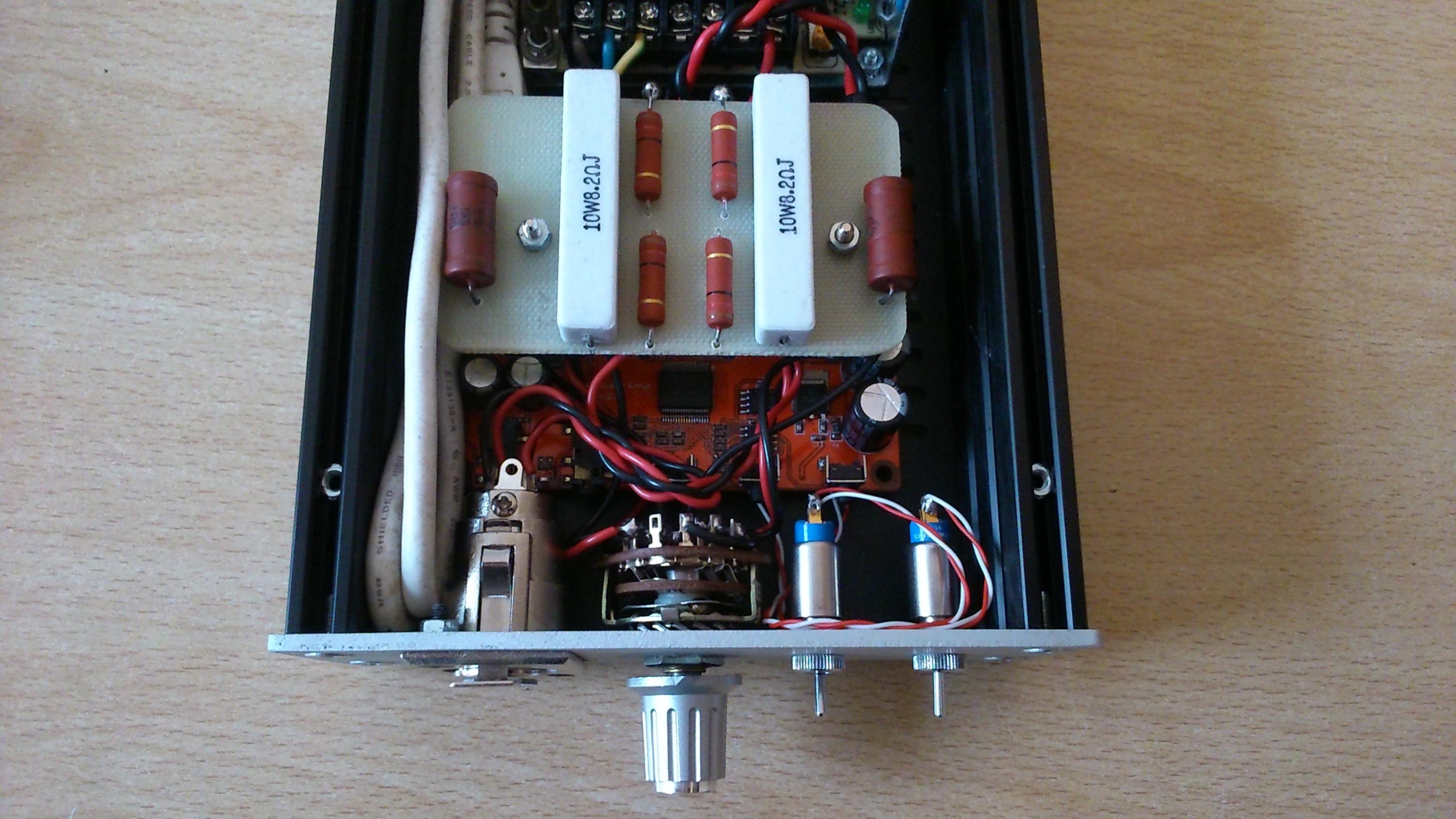

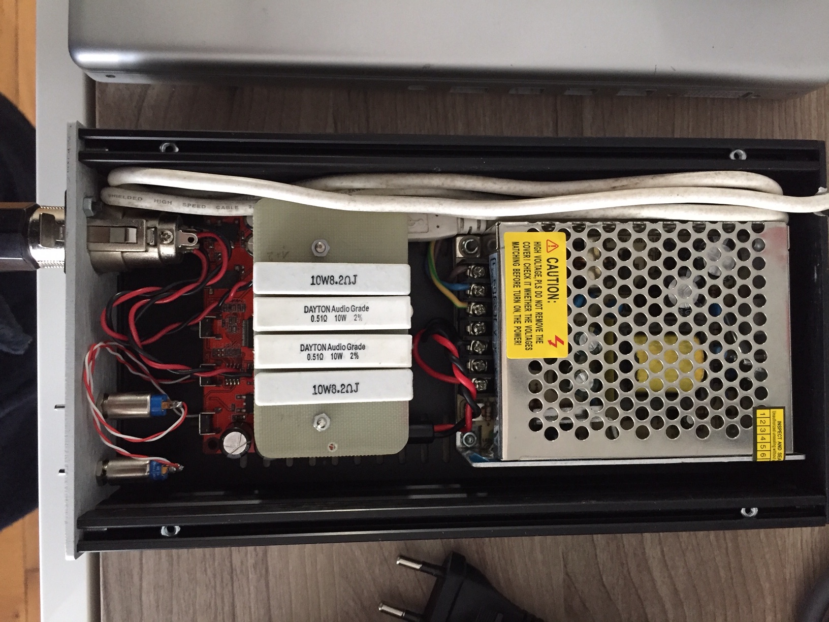

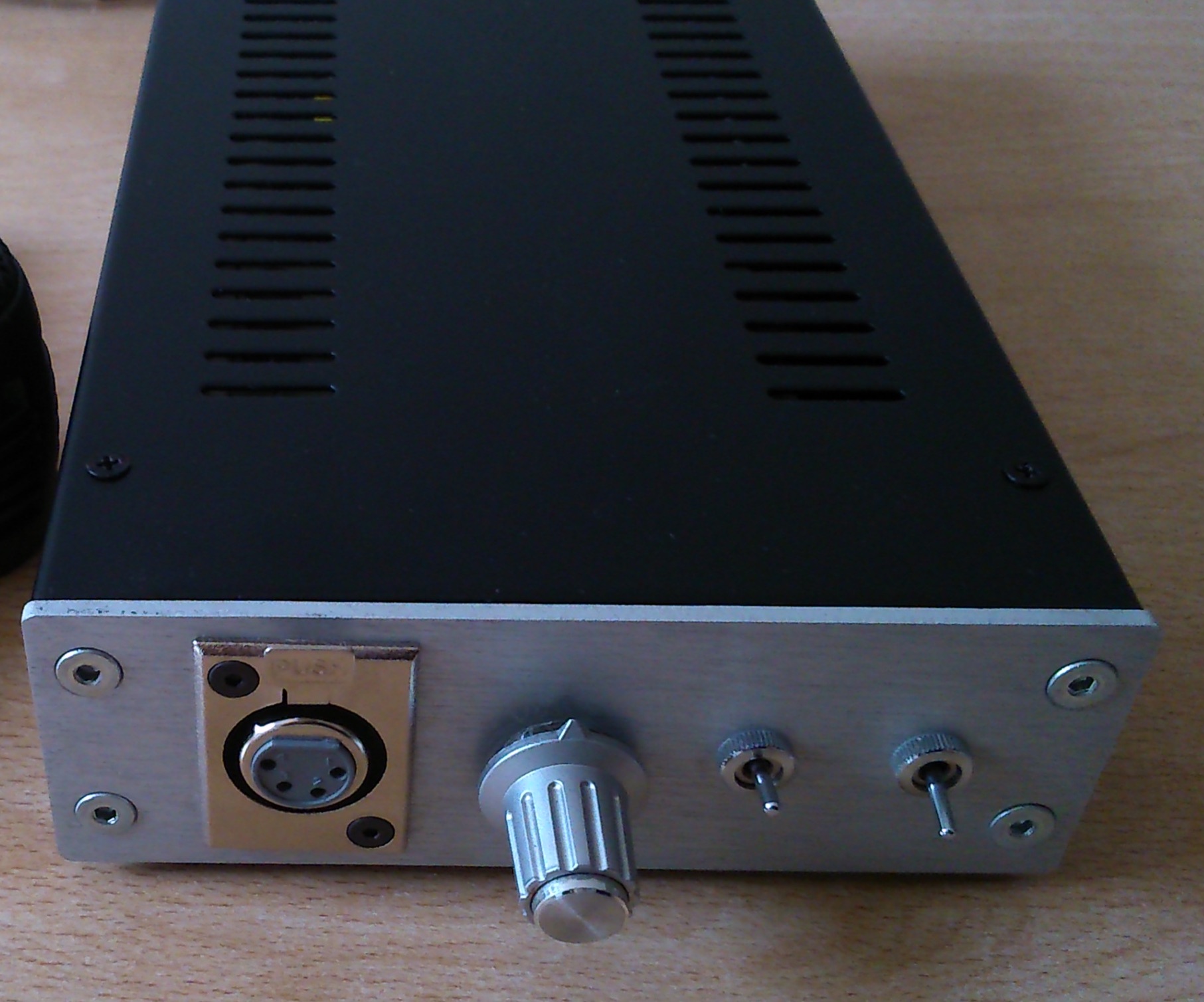

Here are some pictures of my FDA-Phone Amp using the STA-333 board !...
First tests are really amazing compared to more "classical" phone amps, even balanced ones !

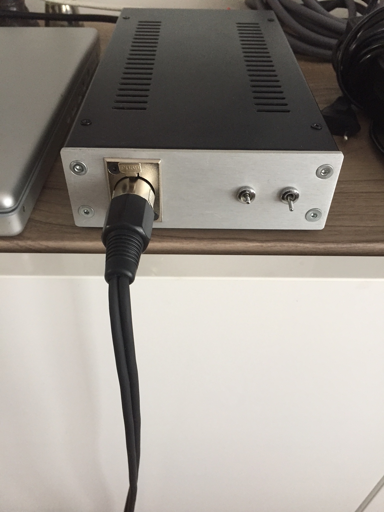

Below are some pictures of the resulting DIY unit...
The audio quality is really amazing for the price of the prototype. Perfect silence without modulation then no noise (the so-called "black background"), very high fidelity of the instruments and voices (I have a "personal" reference...), crystal clear sound and very good dynamics ! In addition, this is a fully balanced unit.
The very important points here are that there isn't neither any DAC nor any Operational Amplifier in this device !... Thus, the path is very short between the digital signal and its audition through the headphones. These are the most important reasons of the very good audio quality obtained with this little board. The PCM is converted in PWM...

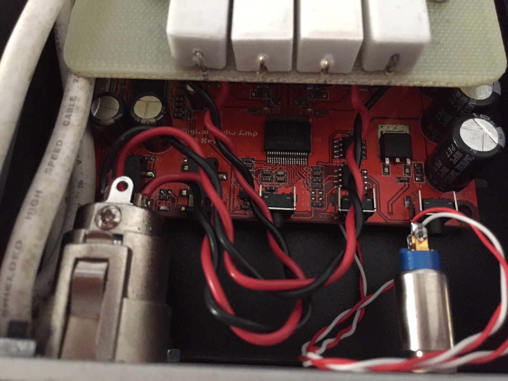

mods picts
We made a few mods in order to have 3 different levels of attenuation to address almost all Headphones whatever their sensibility.
Here a the picts of the mods...
