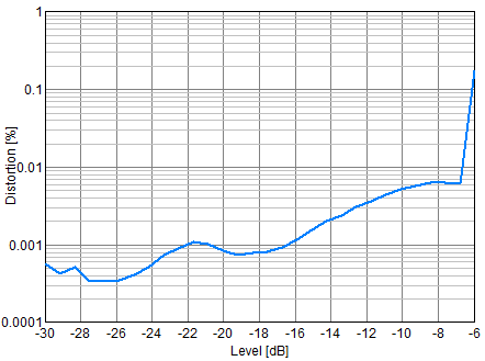

L chanel: sound card line out=>amplifier =>divider 1/10=>sound card line in
R chanel: sound card line out=>sound card line in (we call it a through channel measurement)
ah that makes sense
Thanks!Very nice job.
just finished testing the first sample
THD on load 3.3 Ohm. PS - 50Hz 120W transformer with 2x30V
winding.
-6dB=130W (135W-amp clipping)
scale in decibels - the input level of the audio card

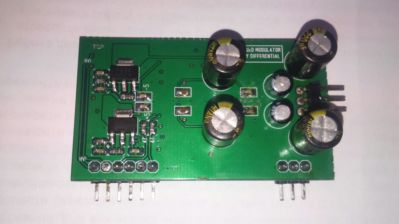

In the first post there inverter circuit are you looking for
Fully Differential UCD Modulator
Hello Sous,
Thanks for sharing the circuit. Is this the one you have implemented in your final version? Kindly help me understand the function of the circuit based around the matched transistors pairs BCV6x.
Thanks in advance!!
slightly modified the concept
based on ncore white paper.

The transistor circuit turns off the integrator closely to the clipping.
The bridge has not yet been implemented, because I do not know that circuit needs servos, I think that is not necessary.

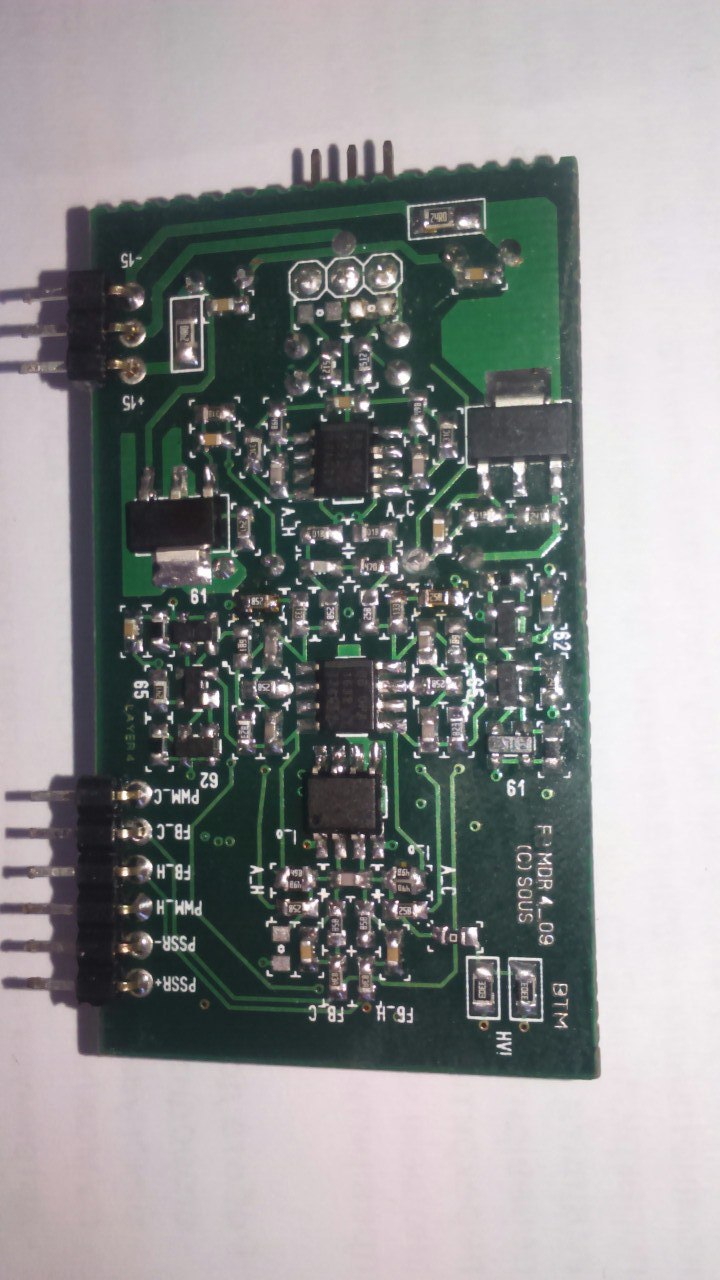

I must say that, nevertheless, failed to get the values that are achieved in the original ncore.
The circuit layout is very critical to the power section of the inverter. It is advisable to do a 4-layer board. And the dynamic dead time control is desirable
However, it turns out a good amp for home use, THD + noise 1-15 watts less than 0.0015%
