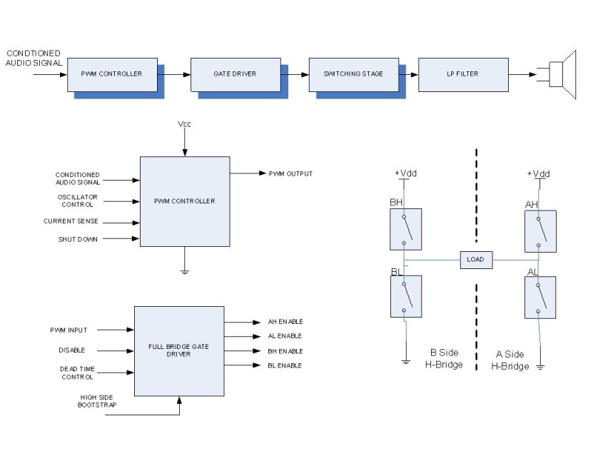

My group is going to be building a high power Class D amp for subwoofer apps ( <100Hz)
general questions:
1) Is there a problem with a full bridge desing without feedback?
2) Why do commercial applications that create Class D for subwoofer apps have switching freqs of 50-150Khz? Will 1Khz be acceptable (besides 2x for Nyquist criteria). Are the transistors more efficient if they are being switched rather than conducting? In other words are switching losses < conduction losses?
3) We would like to create a 3-state PWM. Most PWMs have 2 states, ON and OFF. We would like ON, OFF and Idle. This is because for 2-state PWM if the input is zero, then the duty cycle is 50% and the system is incurring losses. Anyone have any ways to implement this? Im sure it has to do with signal conditioning part of the circuit.
Attached is a block diagram

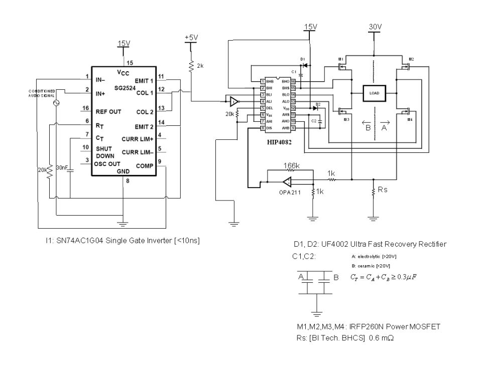

here's the schematic so far
- 2524 is unable to produce 3 level PWM. For 3 level PWM you must have triangle wave instead of sawtooth, and 2 comparator.
- IRFP260N is bad choice. High Rds, high gate charge. Choose a lower voltage, lower resistance, lower gate charge, and faster one!
- Make dead time adjustment!
- Attach a filter!
Is 30V the voltage of the final design?

We are 4 seniors in Electrical Engineering creating class D amp for a project.

The filter is not shown, you are correct. Furthermore the dead-time is built in with the SG2524 PWM controller or with the gate driver (HIP 4082).
