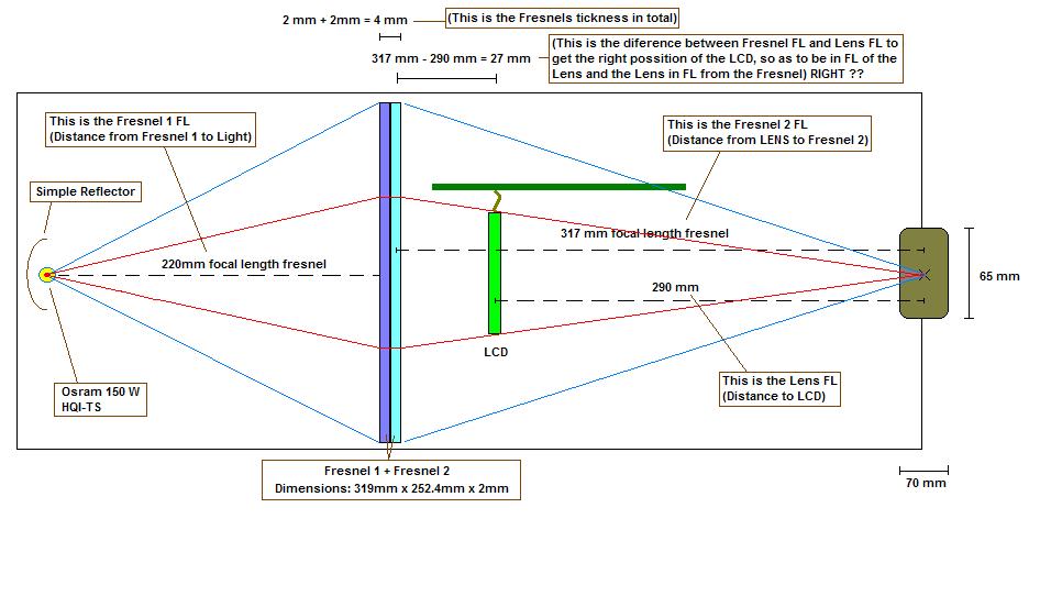

What about this configuration ?
Guy or any experinced one... what do you think of my desing ? The only think I have doubts is this:
I'd like to preserve my fresnels untouched, so if in the future I'd like to use a bigger LCD, I will be able too... so, my doubts:
1) My fresnels are 319x254 mm and my LCD is only 125 mm diagonal (5" PsOne).... then... Where should I put the LCD ? In the middle ? It's the same anywhere ?
2) If I put the LCD on the top or in the middle, should I modify any of the distances to LENS or fressnel ?
3) Again, if I put the LCD on the TOP for example, is it better to move the lens to the top on the same line ?
I have this skretch to check.....

No, don't worry!
Put both fresnels about 20 mm before the LCD. (Any closer and you will see fresnel rings in your screen image.
The you can adjust the distance from the lamp arc to the condensor fresnel (just a few millimeters) to get the arc image into the projection lens.
If you change the throw distance later, you might be able to get a brighter image by adjusting the lamp arc to condensor fresnel distance again.
Don't forget to put a mask around your small LCD so there is no light going directly from the fresnels to the projection lens.
Mopheus questions 1, 2, 3: Your drawing is correct. Put the LCD in the middle, it is NOT the same anywhere. The distances will be correct if you do that.
