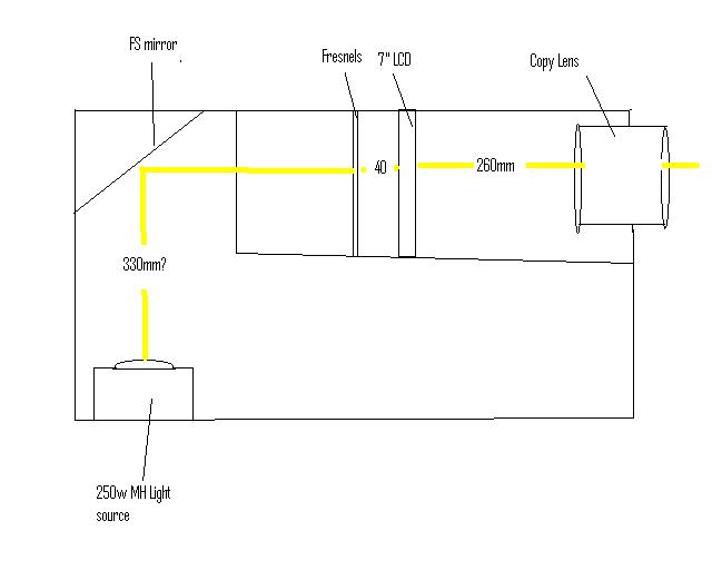

I am about to purchase my Fresnel Lense Set from diyprojectorcompany.com and I want to make sure that I am getting the right stuff.
The set I plan to get:
Groove Pitch: 0.5 grooves/mm
Rear Lens Focal Length: 8.67" (~220mm)
Front Lens Focal Length: 13" (~330mm)
Is this pretty much the best match for the copy lens?
Also I will need to get a condensor/reflector that will work with this set up. Any recommendations and where to get them from? I will probably use the 250w MH kit from diyprojectorcompany as well.
Thanks!

that's the right fresnel set
That should work just fine with a 240 mm fl lens. At a 10 foot throw distance, the LCD to lens distance will be around 260 mm. You can put both fresnels about 40 mm before the LCD and you will get a very bright image.
looks good to me
You can try all those distances out before committing it to a box. Just toss together a temporary "bench model" using duct tape, sticks, etc. to hold everything in place while you project an image the real throw distance. You can even make a mockup LCD using some transparency film printed with a lot of fine text, to verify your focussing.
People use split designs because they have too short a focal length field fresnel for their projection lens. With a 330 mm fl field fresnel and a 240 mm fl projection lens, you have room to spare to use a non-split design. Unless you need to do optical keystone correction, you should avoid a split design. The field fresnel in a split design can only hurt the image quality, not help it!
To combine the fresnels you just put them together in the same holder with their centers aligned and the grooved sides facing each other.
BTW: What were you thinking of doing to remove heat from the light? If you use a cold mirror instead of that first surface mirror, then most of the IR will pass through the mirror where it can be absorbed by a heat sink and then removed by an air stream.

I appreciate your help Guy Grotke.
I planned on using the same type of cooling that Hillbilly used. Two 120mm fans blowing on the light. Will that be enough? Do I still need a UV filter or IR filter? Would the circular cold mirror work from diyprojectorcompany?
Also, do you know where I could get a condenser and reflector that will work with this?

That fan setup should be good, but you still need IR and UV filtering. If you can fit the whole light cone from the pre-condensor lens to the fresnel into the 4.75" diameter cold mirror, then that would be great. Try making some full-scale drawings to see if that is possible. I think you can also get them from surplusshed.com for a bit less. If it won't fit, then there are some hot mirrors available from the various DIY online stores: DIYbuildergroup.com, lumenlab.com, diyprojectorcompany.com. Hot mirrors are easier to fit since they just go straight across the light path. (Or you could buy or piece together a larger cold mirror.)
For UV filtering, you can buy UV filter sheets or UV glass from most of the DIY online stores. Or you can just go to Home Depot and buy a piece of Lexan XL10. The lexan is also very good for supporting your fresnels, since it is so strong.
DIYbuilderGroup.com has some condensor lenses in their online store. The owner also says he is expecting condensors and reflectors from the manufacturer in another couple of weeks.

I understand now. I don't think I could make a full size drawing right now as I don't have the measurements of the parts and not really sure how to calculate the light cone. How would I go about doing that?
I should have my LCD by this week and my light kit next week. Ill try to order the frenels, copy lens, and the Lexan XL10 by next week.
full-scale drawing
If you know the distance between the pre-condensor lens and the fresnel, the diagonal size of the fresnel, and the diameter of the lens, that is all you need. You just draw the lens and the fresnel as straight parallel lines on the paper, seperated by their known distance and centered on the horizontal axis. Then you draw a line from the upper end of the lens to the upper end of the fresnel, and a line between the lower ends. That is the cone of light, represented in two dimensions.
Then you can see how to fit a 45 degree cold mirror (or any mirror really) in that path to bend it 90 degrees. Pretty simple. Keep in mind that the pre-condensor lens can't block the reflected light, so it can't be too close to the mirror. The size of the required mirror will surprise you. It has to be much longer than it is wide.

Guy,
I read over your other post on condensors, and you described a way of drawing the condensor...
I made an excel program that will plot the condensor and normal light fields real quick...I think I interperted your instructions wrong because when I fit a 100mm diam condensor with 200mm FL into a 15" light path it is actually worse, the usable angle of light is less.
Well heres a picture, I must be drawing it wrong cause this doesnt make sense.
My Light angle for the 15" panel by itself is 82 degrees, with the condensor it is narrowed to 28 degrees.
