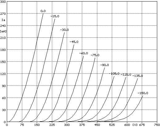

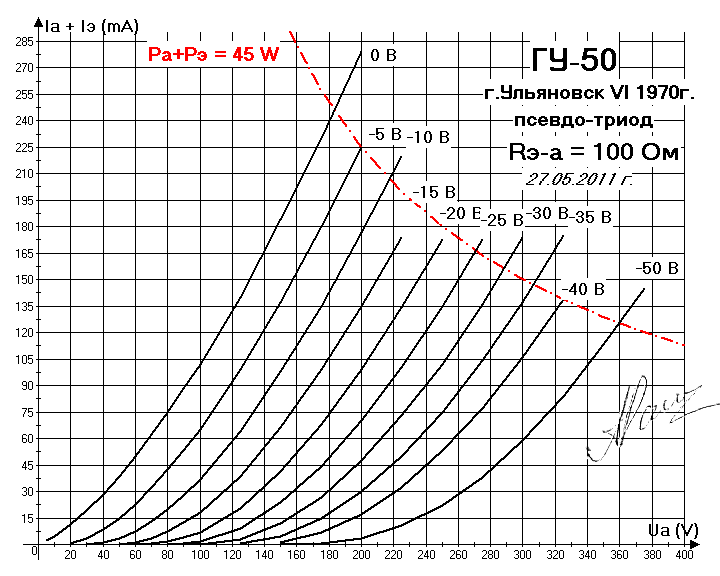

I see, you can't read... You just repost ads... ;-)
For those who can read, here are curves for comparison. Do you see anything in common? I don't.

Ha!, Wavebourn 100% right
As hard a 300B is to drive, the FU50 is unusable in a tube design.
As to why fu50 is built... same thing as usual : people like the look so it sells.
I wouldn't even use that :snowman: in push-pull if it was the last tube I had. I would leave tubes in their box and go transistors.

Absolutely not.
FU-50, GU-50, FL-152, SRS-552, and their original version LS-50 are excellent tubes for audio, but not in a straight A1 triode mode, and no way they are replacements to 300B. Don't compare apples with oranges, they both are great, but not interchangeable.

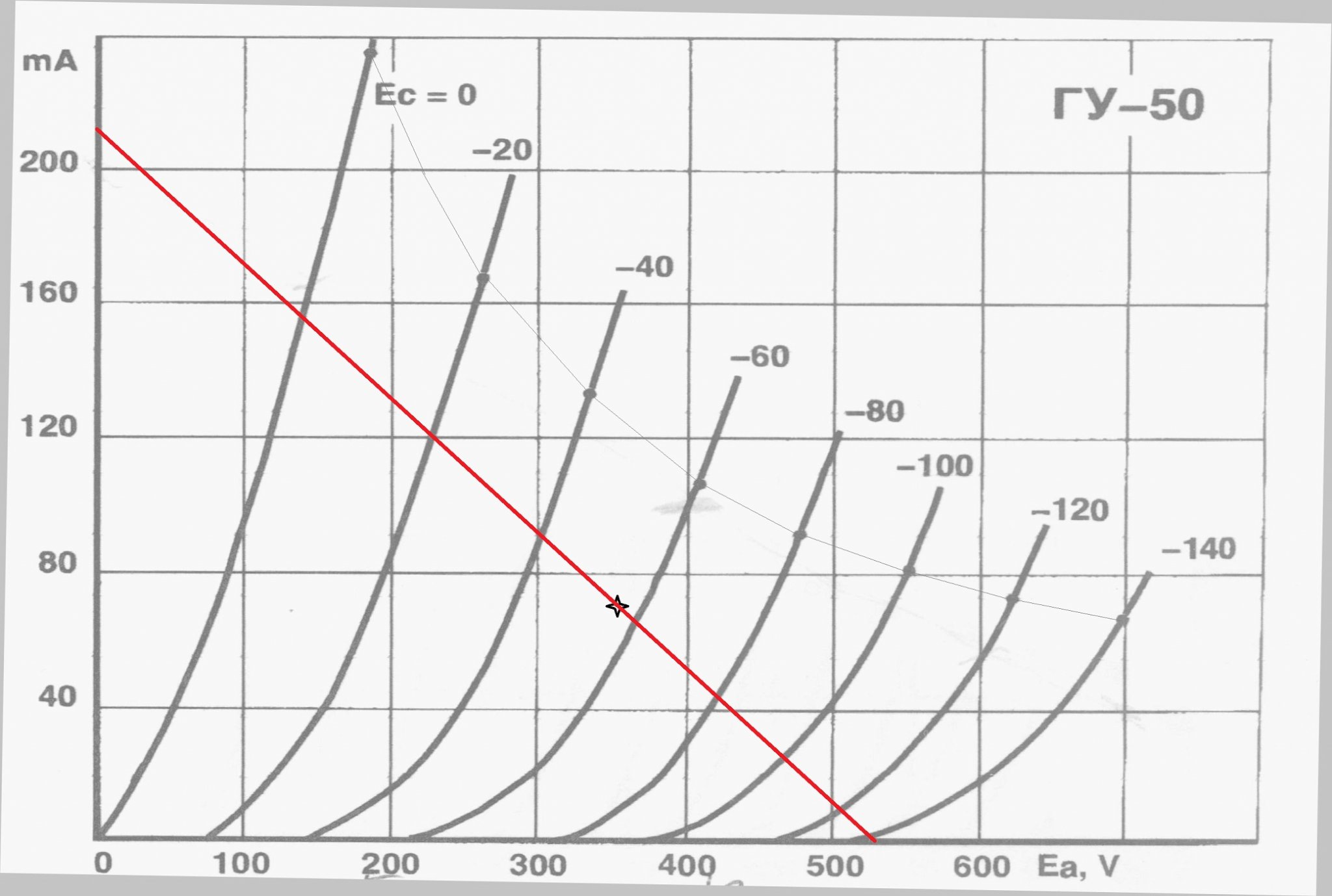

The GU50-Triode is not anything close to a real 300B. But how can you say it's 'useless'? I think it can be pretty good for not too much $$.
From what I've read, the general consensus is that the best way to use a pair of GU50 is in pentode, using plate-grid local NFB ("Schade"). That should be done with an LTP driver stage made of high-gm pentodes, something like 6EJ7/EF184. I'm pretty sure Wavebourn used a 10k:VC OPT for his GU50 amplifiers, with a very high B+ and regulated Vg2 supply down around +200V.
As a triode, GU50 max plate-to-cathode voltage is going to be around +400V. To get close to class A operation the load impedance would need to be high, perhaps 10k:VC, or else you'll be running in class AB operation for push-pull. A high power 10k OPT capable for use with output tubes drawing 80mA each of plate current is a tall order. If you go back to a lower impedance OPT but stay up at Vp = 400V you'll be in class AB operation. THD would then be kind of high, so you'd need some NFB, at which point you'd have to ask why you're not using the GU50s in pentode in the first place.
Perhaps if you reduce your power output requirements to only 10Wpc, PP GU50-Triode can work with good damping, low THD, all without global NFB, with more easily obtainable high power OPTs rated 5k:VC or 6.6k:VC.
Yes, you'd be burning 50W in plate dissipation plus 20W of heater current to make 10W of audio output power. Damnable triodes...

Loadline
Rload = 2.5k
Vp = 350V
Ip = 70mA
