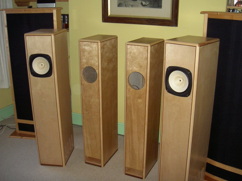

FWIW, my own FE167E MLTLs, which are quite similar to Bob's FT1600s in several areas, are built from BB ply. It's just a case of working with your chosen material.
BB plywood is considerably stiffer than MDF, and while it resonates, this tends to be at a frequency above the main passband of the cabinet. So, when working with it, the object is to keep those resonances up high, above the point where they'd be an issue. Basically, this is the opposite approach to using the denser, but less-stiff MDF, where you're looking to push panel resonance down, below the passband of the cabinet. Both methods have their advantages; my preference is for the former approach, while I know Bob favours the latter. IMO, neither is really 'better' -they're just different & which you favour is about personal preference rather than superiority.
I've got two left thumbs on a good day, and no facilities at all, so my mate Ed very kindly built my enclosures (because I wanted a pair of attractive cabinets for a change, and he's a bit handy at the old woodworking) -they're in the picture below, sans drivers, next to his own Vofo folded TQWTs. In construction terms, the front-panel is doubled, all vertical panels are end lap jointed (I believe that's the correct term), leaving only a 5mm vertical band of exposed ply edge down the back of the enclosure. The front & upper ply edges are concealed by 3/4in pine quadrants. Panel resonance is a non-issue -the ply isn't adding anything of its own to the proceedings.
Yes. This is exactly the technique I was recommending if you want to use pre-veneered flat goods. Remember, though, if you choose a dark stain rather than just a clear finish, the wood strips must be the same species as the panels or the color will not match.

Very pretty boxes Scott - kudos to Ed
