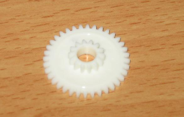

FS : Teac VRDS 7/T1 door gear
I have repared some friends Teac VRDS with this gear.
I have a spare one, if someone is interested....
This gear tends to fail on CMK4 VRDS : door can't open any more.
Make an offer.
I'll try to ask some friends if they got some spare.
We ordered (group buy) a lot of pieces in France because we had some drive to repair; this is a very common failure as the grease make the platic gear to be more fragile and break.
I found a seller on e-bay but some where sold $100 !!
