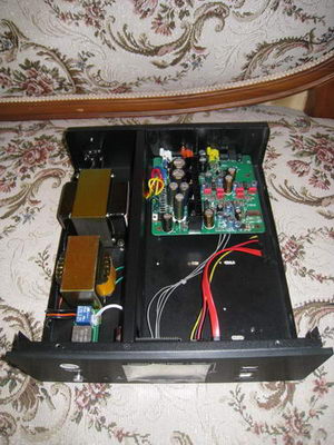

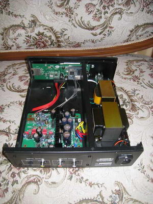

Lossless Player ready to use included :
1. Touch Screen Function & Display
2. Remotee Control
3. Thumbdriver Reader (128MB to 64GB)
4. SD CARD Reader (128MB to 64GB)
5. 2.5 SATA HDD Internal Connector and Data Transfer via Computer (160GB to 2TB)
6. I2S Direct DAC CS4398 No need any modify (Opamp NE5532 & NE5534)
7. SPDIF Output for HI-END DAC
8. 2 Pcs of transformer Digial & Analog (Shunt Regulator)
9. Completed Chassis, IEC Socket,
All of them fully assembled and tested it meant you no need to solder by yourself. Everything is completed from my store you only push switch and find any songs you like from your source then JUST PLAY IT !
Last price is 295 USD includes shipping cost to anywhere !!! (registed airmail with tighly packing wood & foam)
