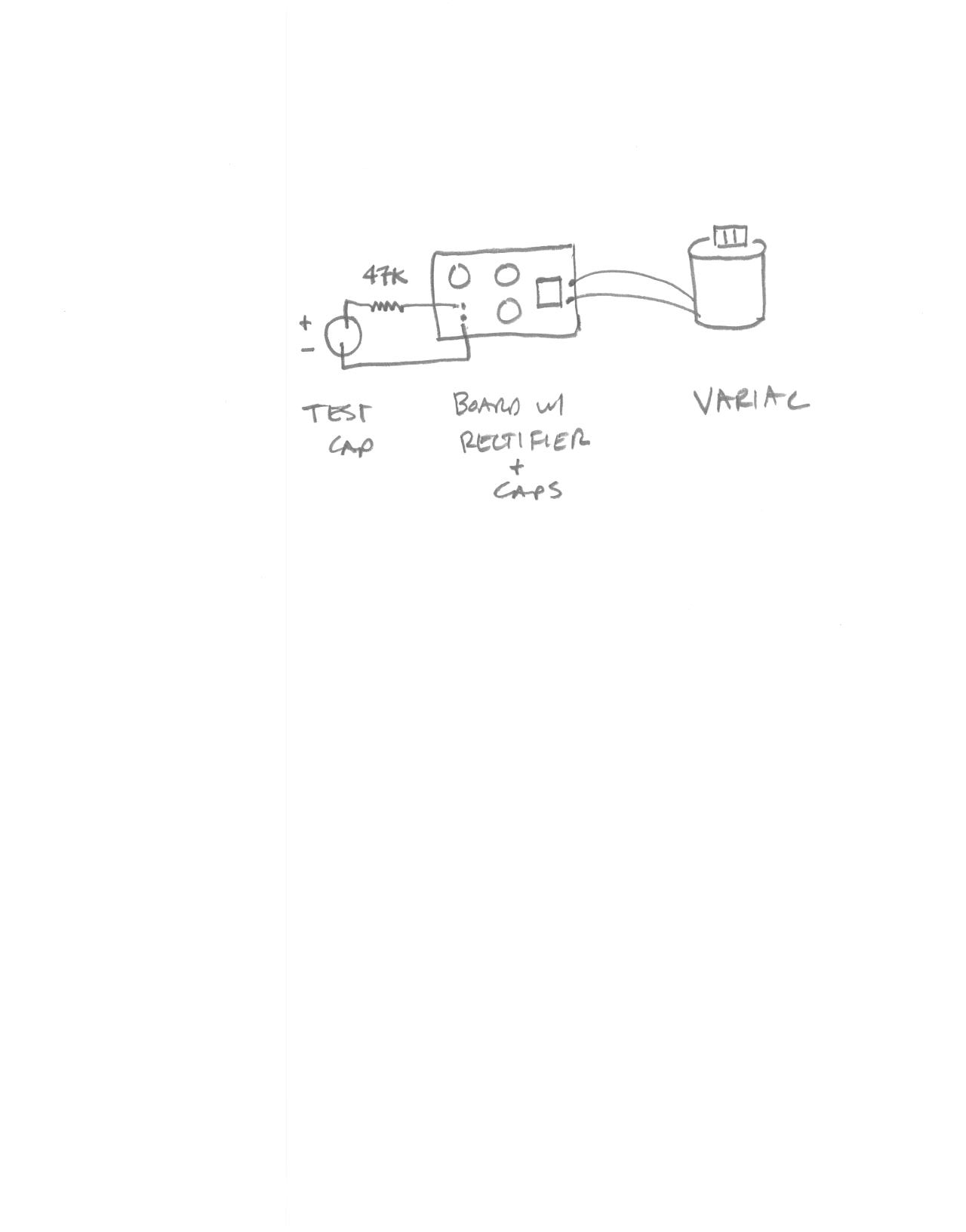

Will this setup work? I do not have a way to generate 63VDC.

That would work to some degree but I wouldn't do it for three reasons
1) you can't limit the current with the variac
2) you won't know what the AC ripple will be unless you can measure it
3) MAINS ! 🙁
Much better with a current limited DC bench supply
3) MAINS ! 🙁
Would powering the variac through a dim bulb tester address #1? I was hoping to do something like this to reform them.
