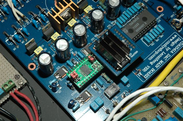

As promised, here is the photo how 9001 converter board is used in the TDA1541 DAC.
Notes:
1. The input of the DAC only used a pulse 1:1 transformer couple from the SPDIF signal.
2. 256fs and I2S output mode of the 9001 is used.
Jumper setting are:
J1/J2/J3 short
J4 and J5 open
Enjoy!
Notes:
Jumper setting are:
J1/J2/J3 short
J4 and J5 open
Enjoy!

Hi Spencer,
I see that the DAC board also has a SAA7220 digital filter.
Does the SAA perform a format conversion or the IIS signal can go (non-os) straight to the TDA?

Andrea,
The SAA7220 is used as a 4x oversample digital filter. Without SAA7220, it is NOS. I use SAA7220 because I use jfet IV (similar to pass D1 IV) so that there is less noise if I use 4x over sample. Or best 8x over sample digital filter.
Spencer
Spencer

spencer said:Andrea,
Spencer
Spencer,
thanks for the reply. Did you try runnung the DAC without the SAA7220?
Cheers
Andrea
