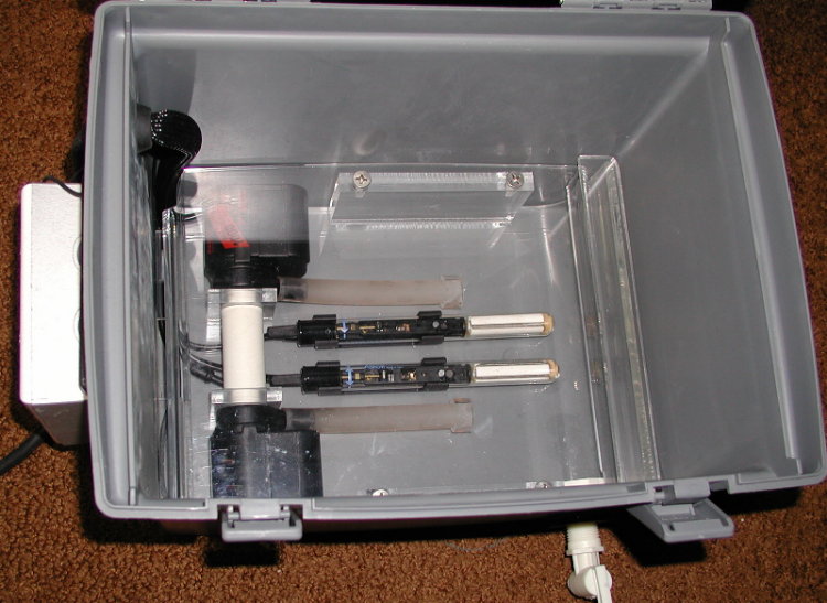

Wavemaster:
This unique horizontal etching tank has an acrylic shell that holds two fluid pumps, two heaters and a temperature sensor all submerged in the etchant beneath the "wash plate" where the circuit board lays. A GFCI circuit in the external switch box ensures total electical safety.
One gallon of the much preferred Ammonium Persulfate as an etchant is stabilized at 115degrees F by two 50 watt heaters. The built-in 4 digit LCD thermometer electricaly reads out either ethhant or room temperature. Two magnetic-drive centrifugal pumps move 2,000 liters per hour of etchant across the bottom of the tank, forced up a ramp at one end of the tank to form a 1" high waterfall. The falling etchant is then directed across the top of the "wash plate", where the circuit board is placed for etching, before falling back down into the reservoir at the other end of the tank to be recycled again. When power is removed, the etchant falls below the "wash plate" making it dry for circuit board removal. The etchant remains in the tank in-between etchings and when it is fully exhausted, a 1 gallon container, (included), is used for proper chemical disposal.

The Wavemaster holds a board up to 10" x 8".
