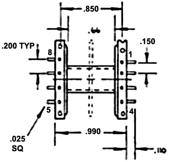

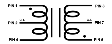

Hi Guys - good to hear that you got the transformers OK.
Below you will find the schematic, the pinout and a photo.
Basically all you need to know is that the input and output (+) sides are in opposite corners.
Pin 1 is a little closer to pin 2 than the others. That's the key.
You connect the output of your voltage DAC chip directly to pins 1&5 (input) and your cable or connector going to the amp/preamp to pins 5&8 (output). The output can be balanced or unbalanced, however you like.
Depending on you system, you may have to connect the (-) output pin to DAC ground to kill hum. If yo don't have to, that's great, but some systems want the DAC and amp grounds connected.
That's it, simple!

thanks muchly michael, was impossible to find any sort of datasheet and the last pics werent that revealing and only showed one set of 4 pins. so you use them as part of a sort of interconnect yeah? cut out the middle men so to speak. if I didnt have more than one target in mind I think thats what I would do too, either that or install them at the input of the amp and wire direct outs from the dac
Hi Francesco - I have not used these transformers with the TDA1549, but they should work just fine if there is no DC on the outputs of the chip. Looking at the datasheet, there does not seem to be.
So in that case you would connect the TDA1549 left output (pin 4) to the + pin of the transformer (pin 1) and the ground to transformer pin 4.
Same for the right channel, pin 7 of the DAC goes to pin 1 of the transfo.
