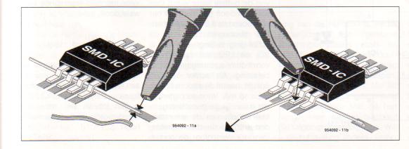

I've toyed with the idea of replacing the ST opamp, in the ASC200 modules I bought through this thread, with LM4562 type amplifiers. But the existing opamps on the boards are epoxied down (some pretty mean red stuff, like I've tried to remove before on other products, not easy!), and I'm afraid I might rip up some traces if I tried that. And the ASC200s are sounding great, so I don't have much real reason to cut them up.
've toyed with the idea of replacing the ST opamp, in the ASC200 modules ..... like I've tried to remove before on other products, not easy!), and I'm afraid I might rip up some traces if I tried that.
Maybe the attached photo is some help. I had some good results with this help of removing SMD opamps from the circuitboard. The trick is that heat up first the completelty left pin, if hot just pull the wire and the pin flips up and is free from the board, next the following pin etc. In the end all pins are free and you can remove the SMD itself with 'bruut' force.

Removing SMD opamp might result in peeling off the track if not done properly. I found the easiest way is to chop off all eight legs with pen knife, then remove the critter which had seperated from the legs. Apply some solder to remove all those eight legs still stuck to the pads. Risk free. 😀
Thanks, but the problem isn't the pins, it's the epoxy under the body (removing pins on a SOT8 is simple-- just flood solder over pins on one side, flip the part up, repeat on the other side. If you're worried about saving the part, do that with low-temp solder). But the epoxy under the body can rip up what's under it no matter what you do to the pins.
