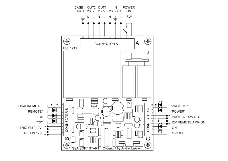

FS: Amplifier control board (soft start, push button, DC detection, remote trigger)

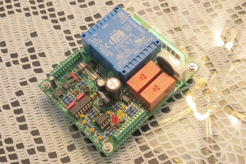

I have for sale special amplifier control board, designed by our forum member LazyCat. This board provide everything a amplifier should have for normal operation & protection:
-push button activation
-soft start (via thermistor and bypassed with special high inrush Schrack relay after few seconds)

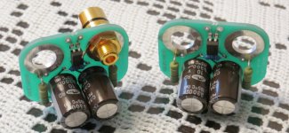

-DC detection (control board consists also two small pcb boards that are mounted on amplifier speaker terminal, providing DC sensing via optocoupler (galvanic separation)
-TX & RX
-12V trigger out/in
-LED indication on/off/fault/delay
This is state of the art control board, probably unique on diy market.
Price for amplifier boards + 2 DC detection boards : 65 EUR + post cost
contact: moonaudio (at) gmail.com

The circuit works in the way that when push button switch is actuated, the first Schrack relay turn on, after few seconds another Schrack relay bypass thermistor. If there is any DC detected on speaker terminals (+-1V or greater) the control circuit switch off amplifier mains off. Also speaker detection is galvanic separated from control circuit by optocoupler. So there is no relay in speaker path, also there is no danger that speaker relay would fail in case of several tenth of DC voltage.
I think this is best protection ever available for protection amplifiers. I am selling it, cause will use some SMPS on future project. 😎
