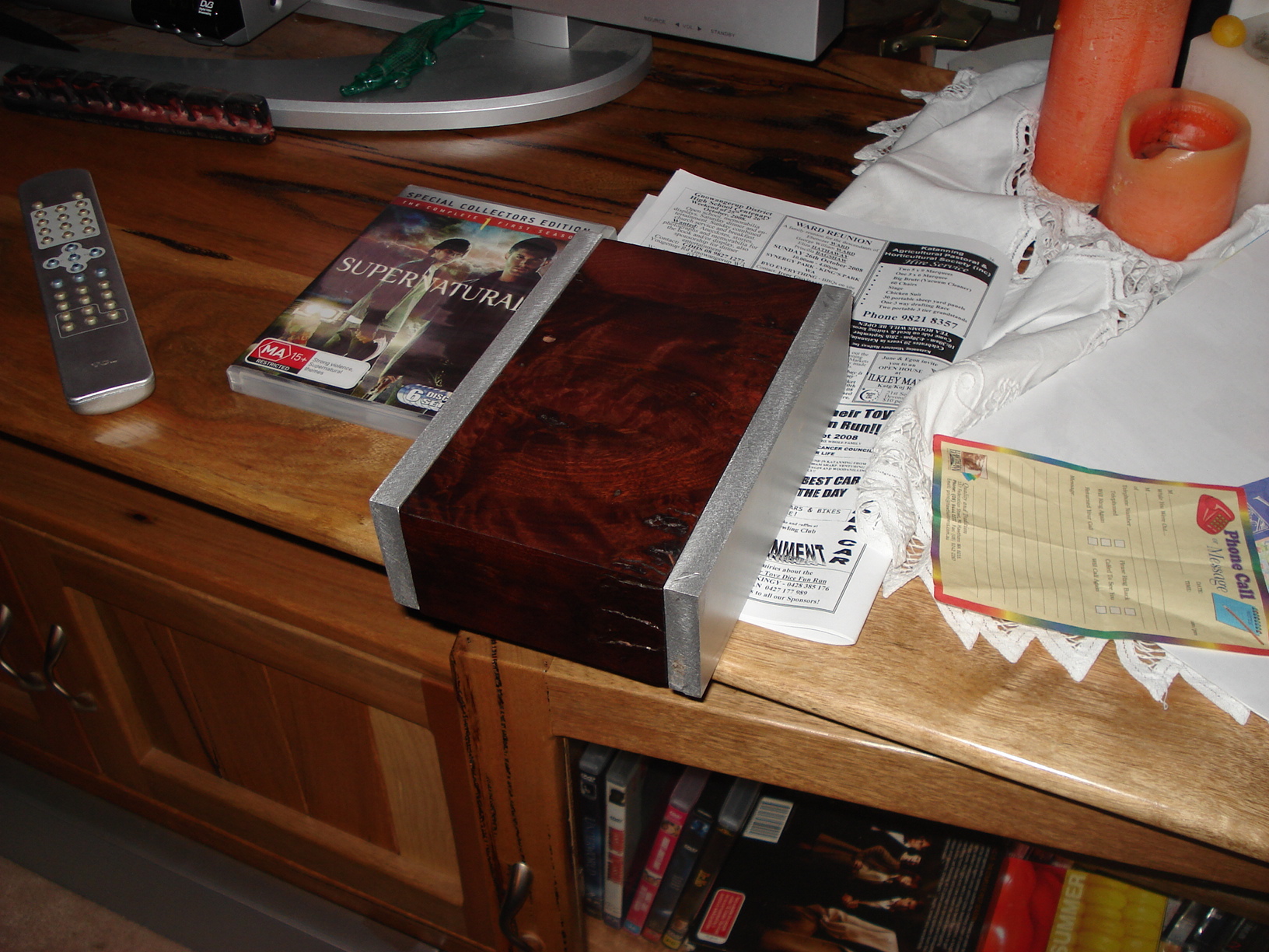

As for the amp I can use either a Tripath amp (41Hz AMP6) or a Peter Daniels LM4780 dual mono or one of his LM3875s. All are in enclosures made with scavanged materials.
I havent got a shot of the LM3875 but the toroid is encased in a box made of chestnut (from a freinds garden and the amp is in an aluminium enclosure constructed from the rear panels of burnt out power units found in a skip at work.
The LM4780 is in an enclosure built from 12mm thick aluminium found in a skip and Jarrah burl found on a fallen tree branch near to my house.
The 41Hz amp6 is in an enclosure made from sheoak I milled myself from trees fallen in the local wood cutting area.

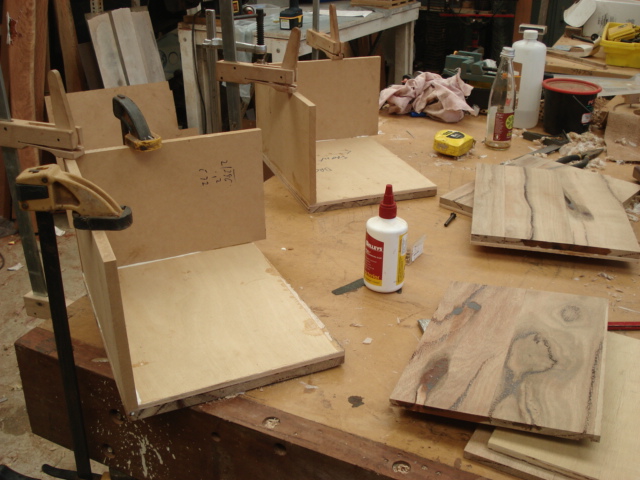

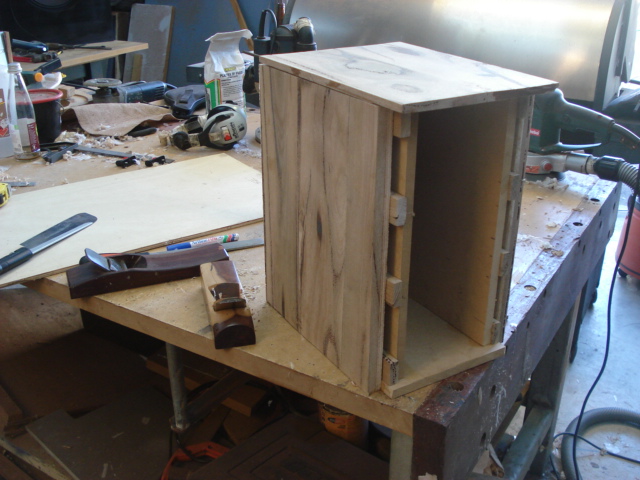

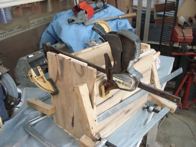

Fonken build progress report
Well the cabinets are underway.

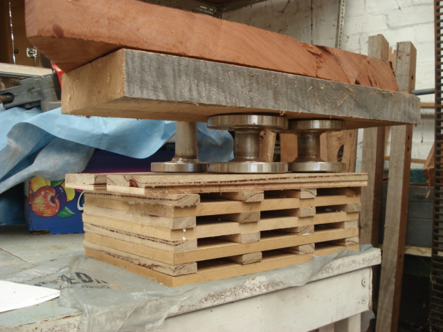

Ive used a local timber (marri) sandwiched to 12mm marine ply to make the sides and top. The baffles will be a thick slab of crotch cut jarrah 25mm thick and impregnated with 2 pack resin to stablise any cracks or voids. Some butt joins are glued with PVA and others with a glue that swells and fills cracks and seals everthing. Ive yet to plane and thickness the baffles. They are a pain because of the grain that runs in every direction, but the final product will look like marblecake.:cloud9:
Pics below.
