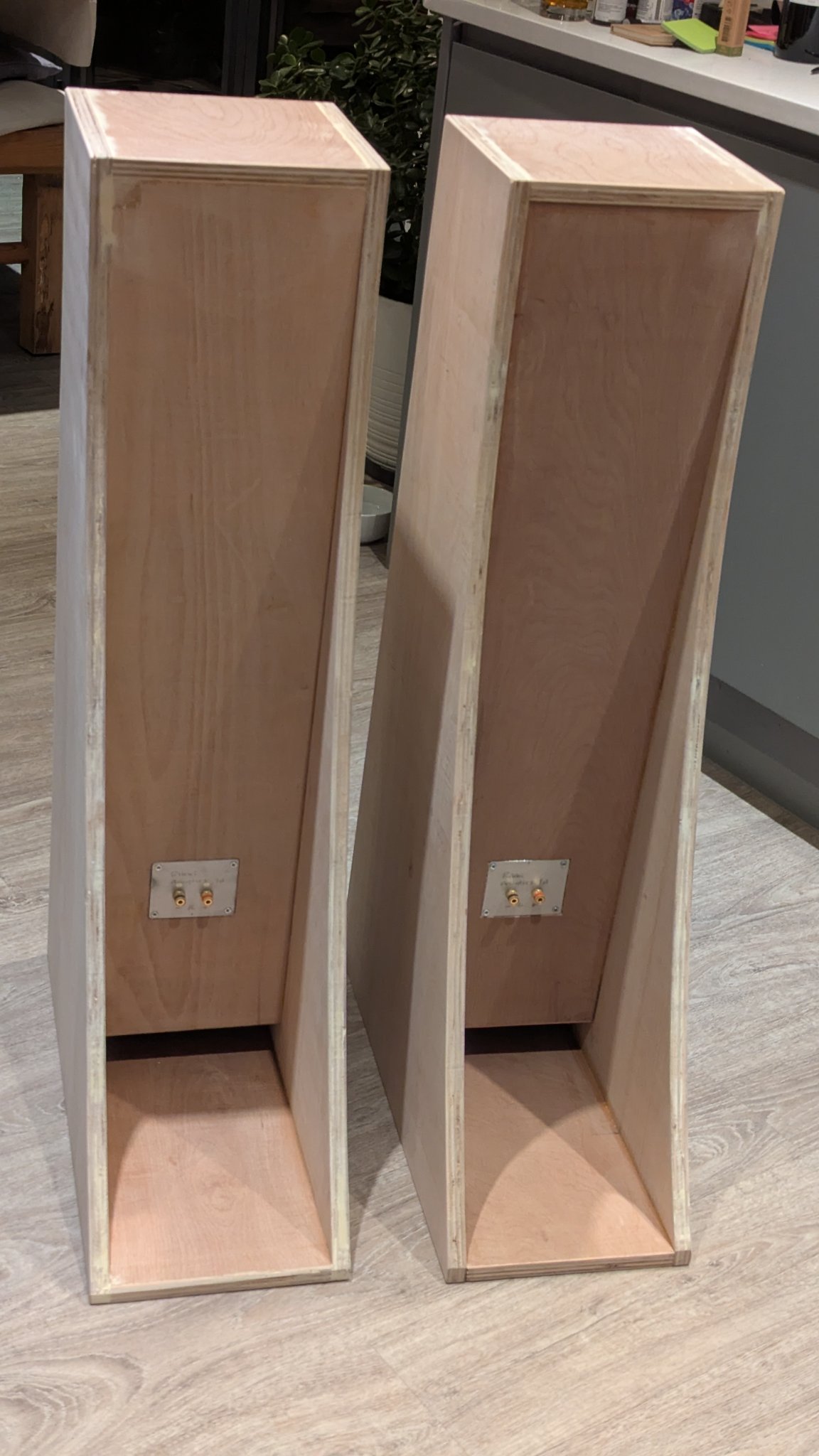

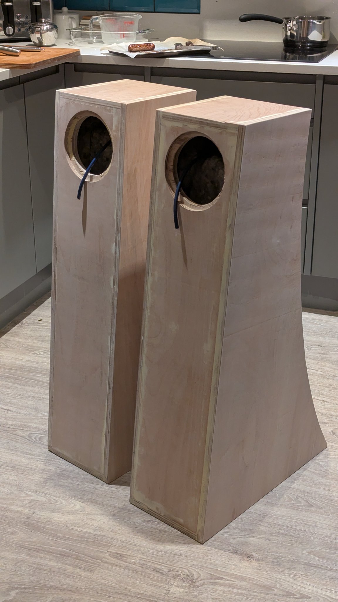

Well, they're ready for paint.
I'm going with white but I'm putting a bold colour on the back panel. I've seen someone do orange which looked great but I'll go with a different colour.

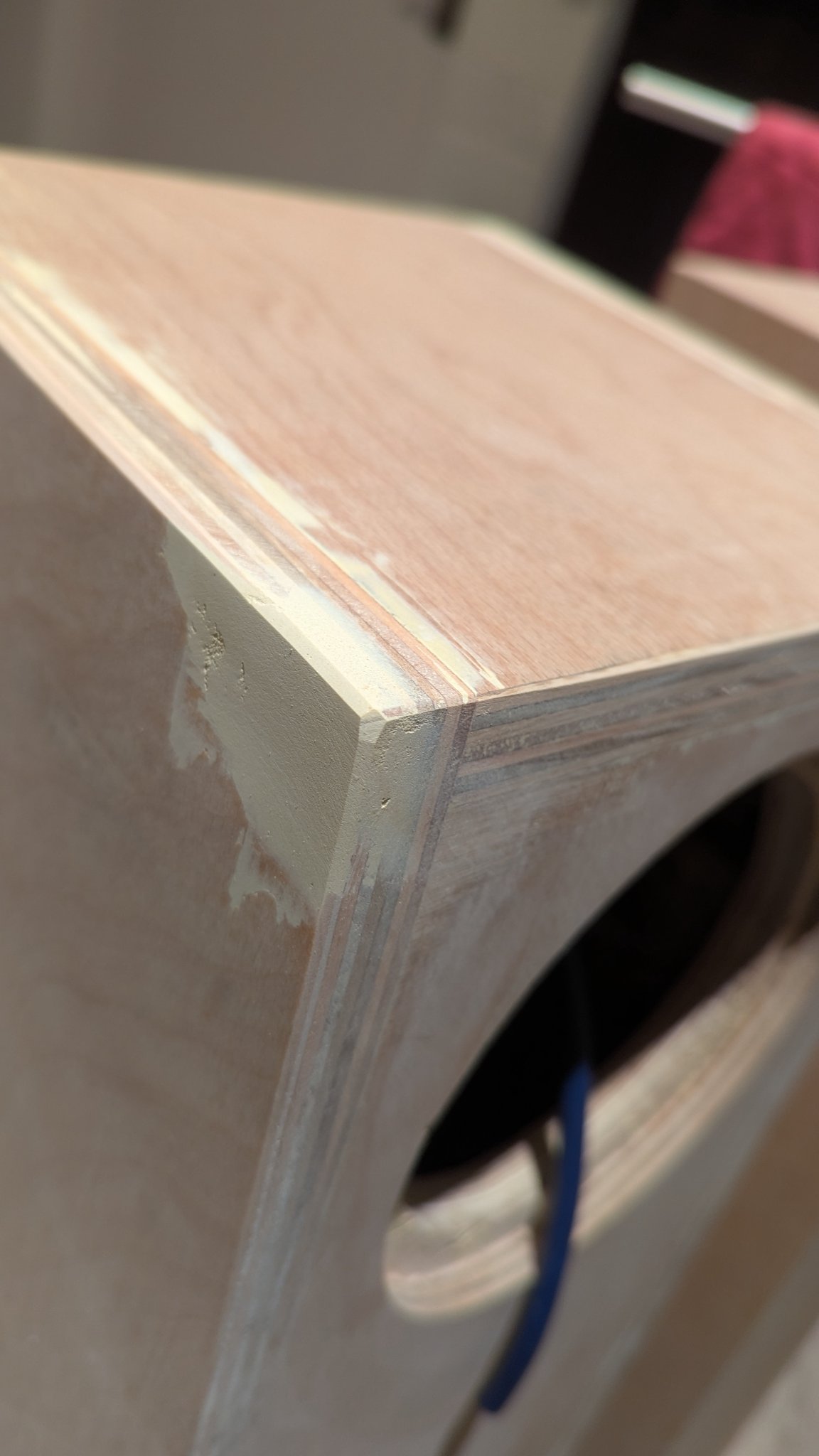

Close up pic of the damaged repaired corner which I'm hoping won't be noticeable.
Looking forward to completing these now and having a listen.
I think you’re gonna need more and higher density filler / primer seal coat before ready for paint; and definitely consider a satin or low gloss finish to avoid telegraphing of flaws/plywood edge grain.

I'm not really looking for a factory finish. I'm ok with "looks good from 6ft away"
I'm using a primer / paint all in one formula that I've used before. You can paint it on almost anything. It's a satin finish.

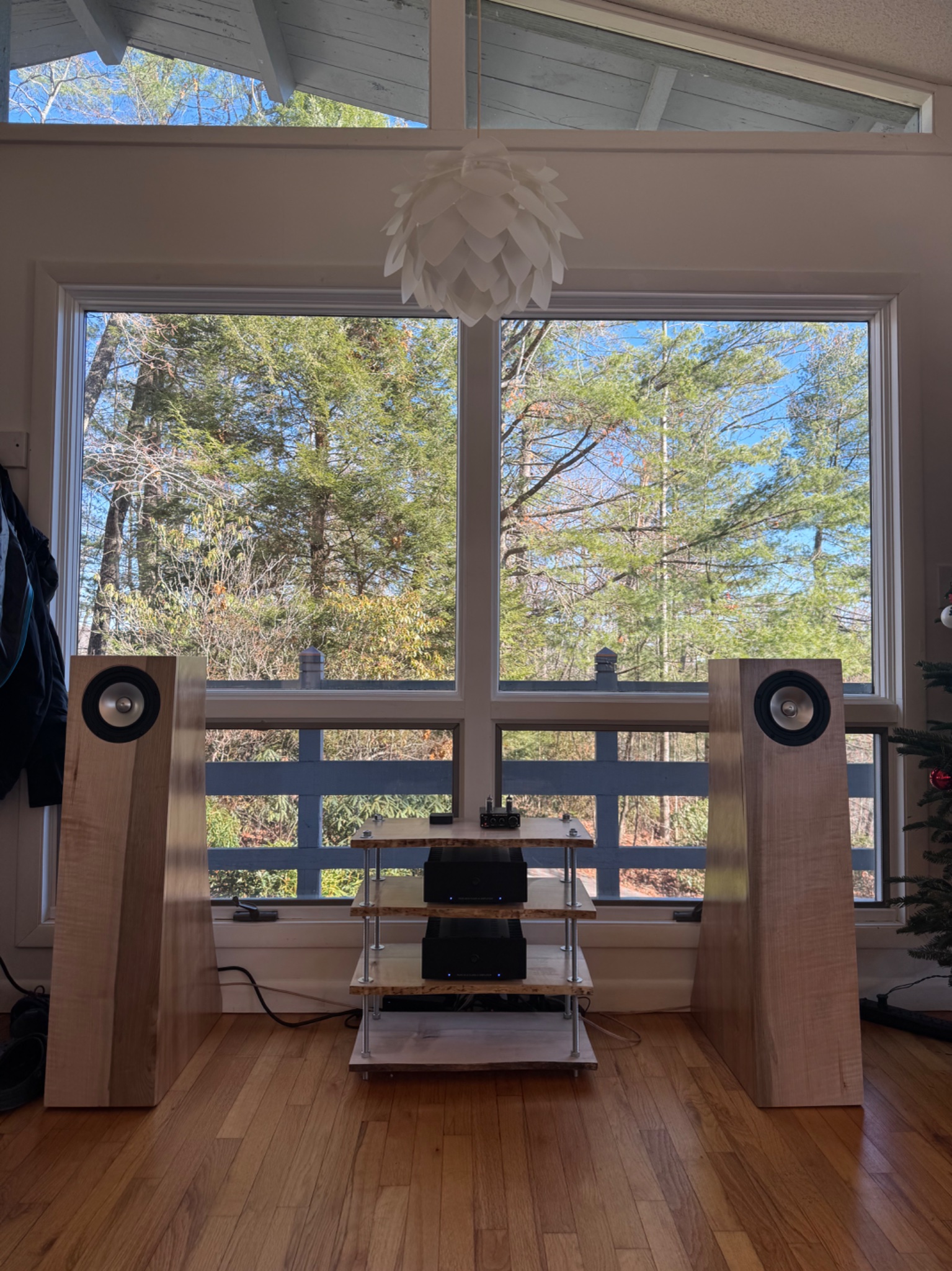

I built FHXL’s early this year with CHN110’s. Had high-ish hopes of a cabinet grade build using quality ply and locally sawn maple for the faces. I couldn’t contain my enthusiasm and rushed the build. Made a couple little errors that I can see but no-one else seems to notice. They sound phenomenal driven by Pass ACA monoblocks. A little tube preamp provides some mild tone control. I don’t regret rushing the build as I’m not a perfectionist and just enjoy the sound they create. I joke that I used the “Wabi-Sabi” method of planned imperfections.
I have to admit that I’m already thinking of another build, though not for any reason other than the build itself. I can imagine being perfectly happy with my arraignment for quite some time.

I'm impressed and inspired to get moving with my projects which, oddly enough, mirror what you've done. Over the past few years my aspirations have slowly changed from simply repairing my old 1980's gear to building pretty much what you have: FH-XLs powered by ACA redux balanced monoblocks but with a BA2018 balanced preamp and a Pearl 3.
I'd decided to face the enclosures with hardwood too -- to cover the edges of the plywood and facilitate thumbnail roundovers. I was going to ask the lumber yard to split a 2" piece to get a matched grain appearance... though I like your choice too. I was able to snag Alpair 10.3s which I hope to Enabl at some point.

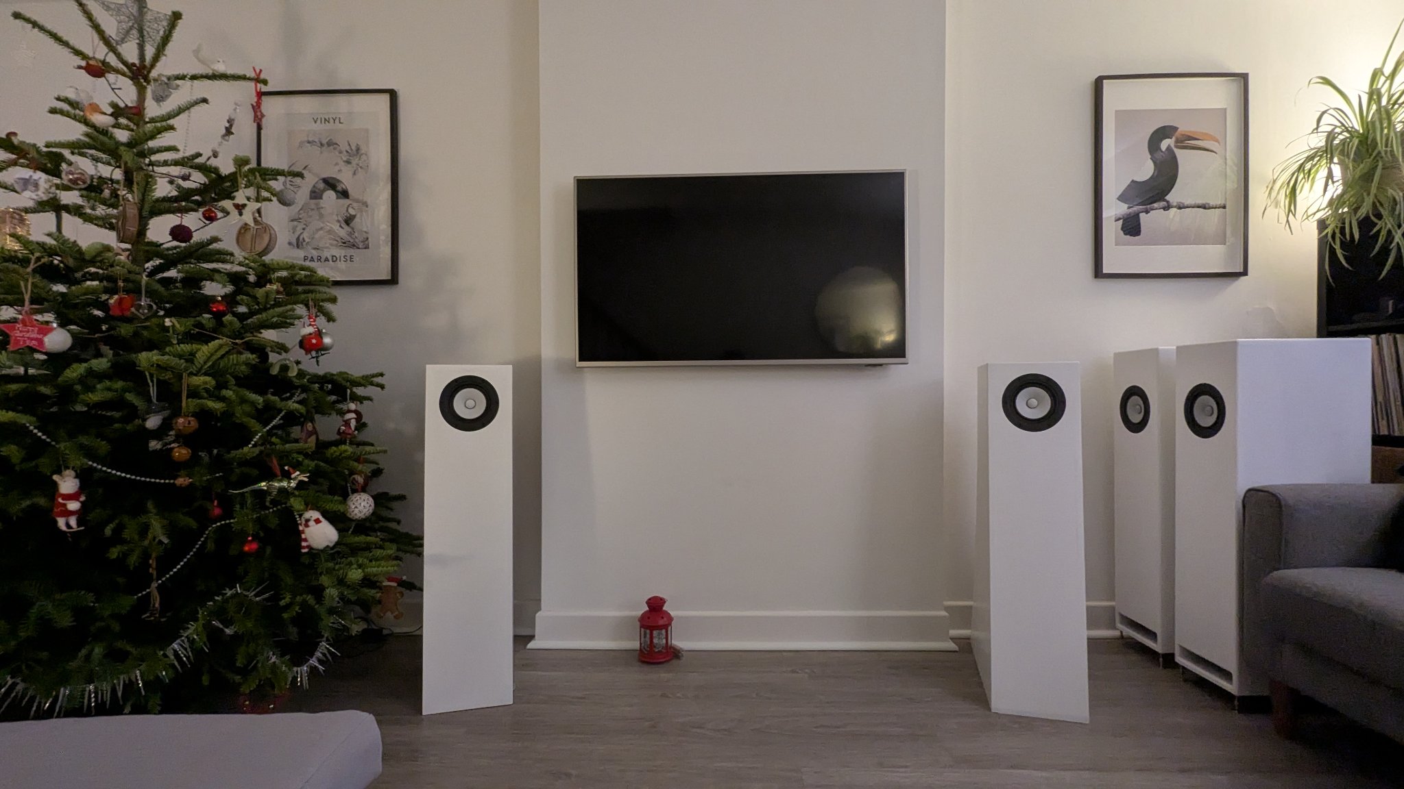

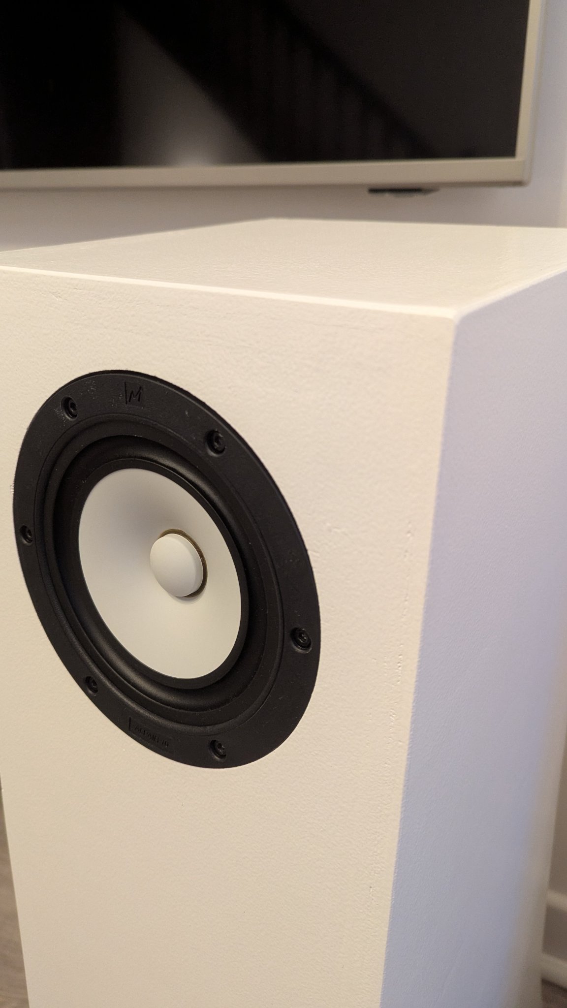

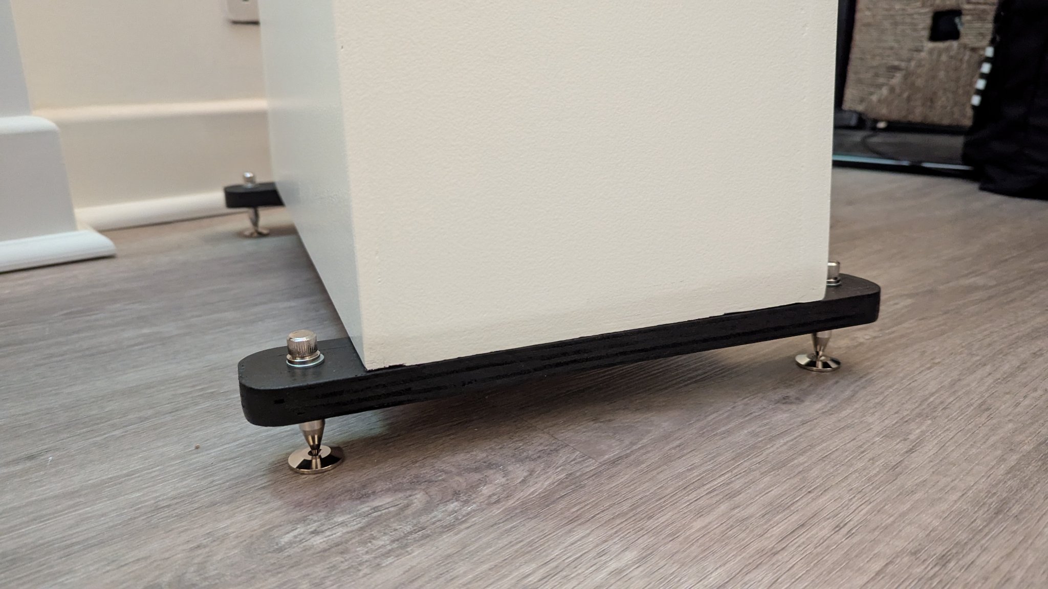

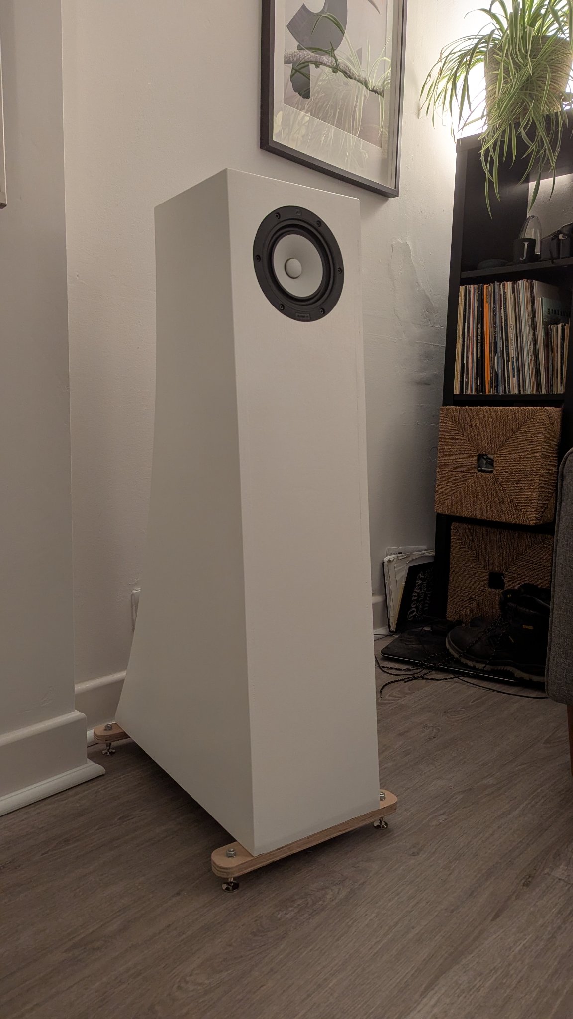

Well they're finished.
I can't place them in the usual spot because the bloody Xmas tree is now taking over. This means they're closer together than I'm used to, but gotta say, they are sounding good.
Are they any better than my current Pensil 10P's? Hmmm.
Not exactly. They obviously need more time to bed in. I've had the drivers running in the bedroom system daily for about 3 weeks at low volume while I've been building these cabs. Now they're in the fhxl's I'll turn the wick up a little.
They both sound very similar at the moment.

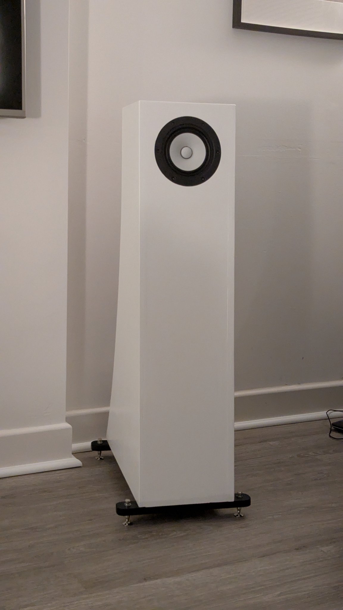

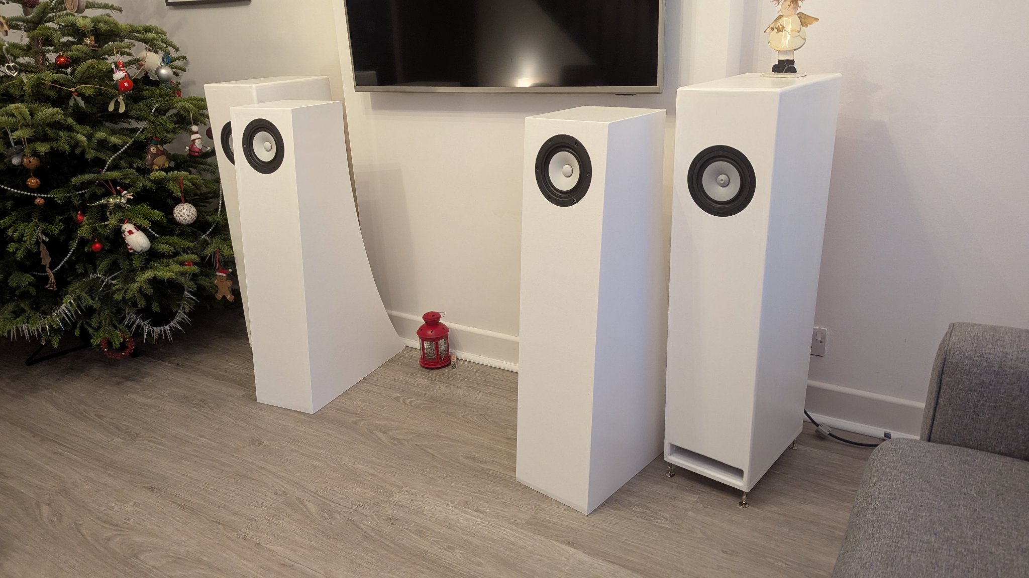

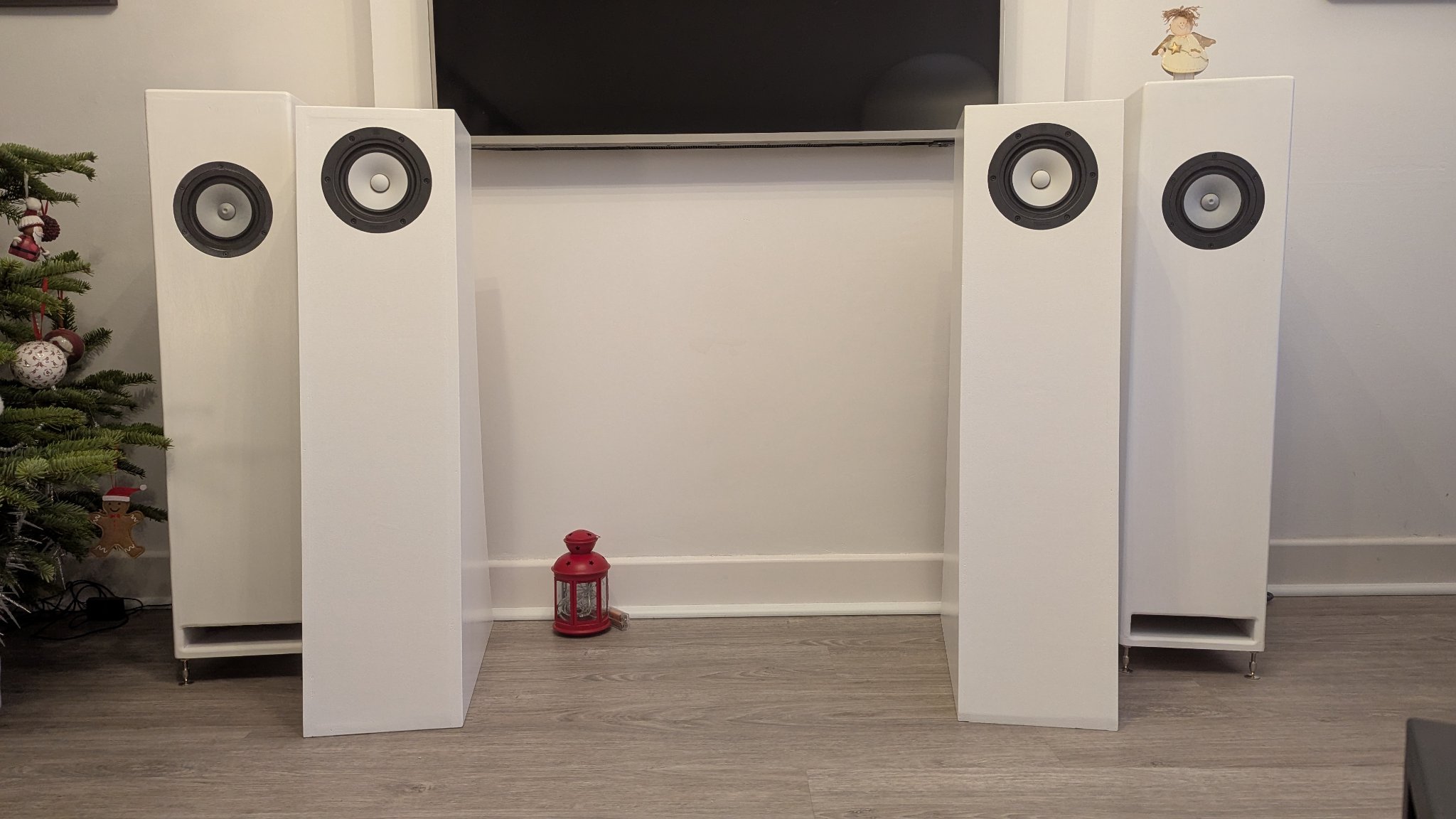

Anyway, some pics,
PXL_20241208_155742165.jpgPXL_20241208_155814417.jpgPXL_20241208_155831578.jpgPXL_20241208_160530902.jpg
Very nice! I love the modern/minimalist result. As for sound, I noticed improvement in mine even a month after they were finished. I spent about a day breaking them in before installation so they were definitely not fully bedded in at install but even several weeks later they seemed to be more full. Less forward, not as bright. Could be my neophyte ears but…

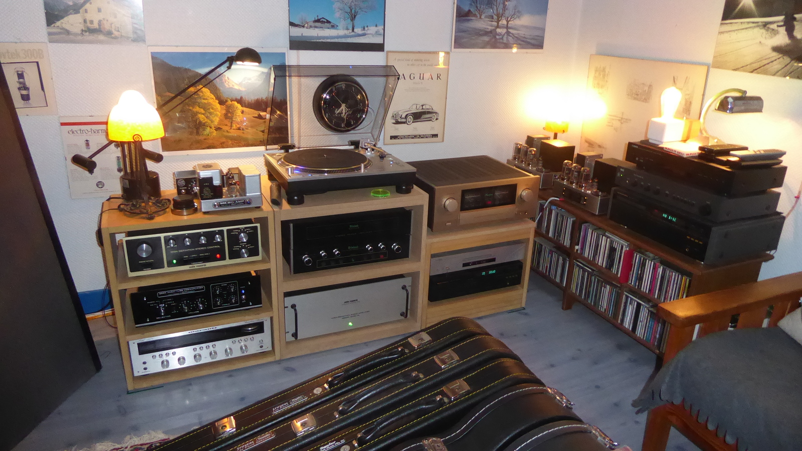

No, @Borats Baby : like you, I have a small Auditorium - dedicated to audio :
