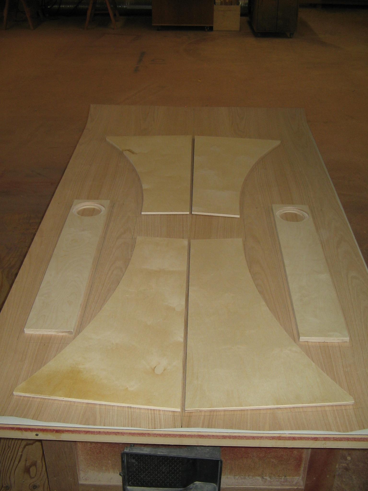

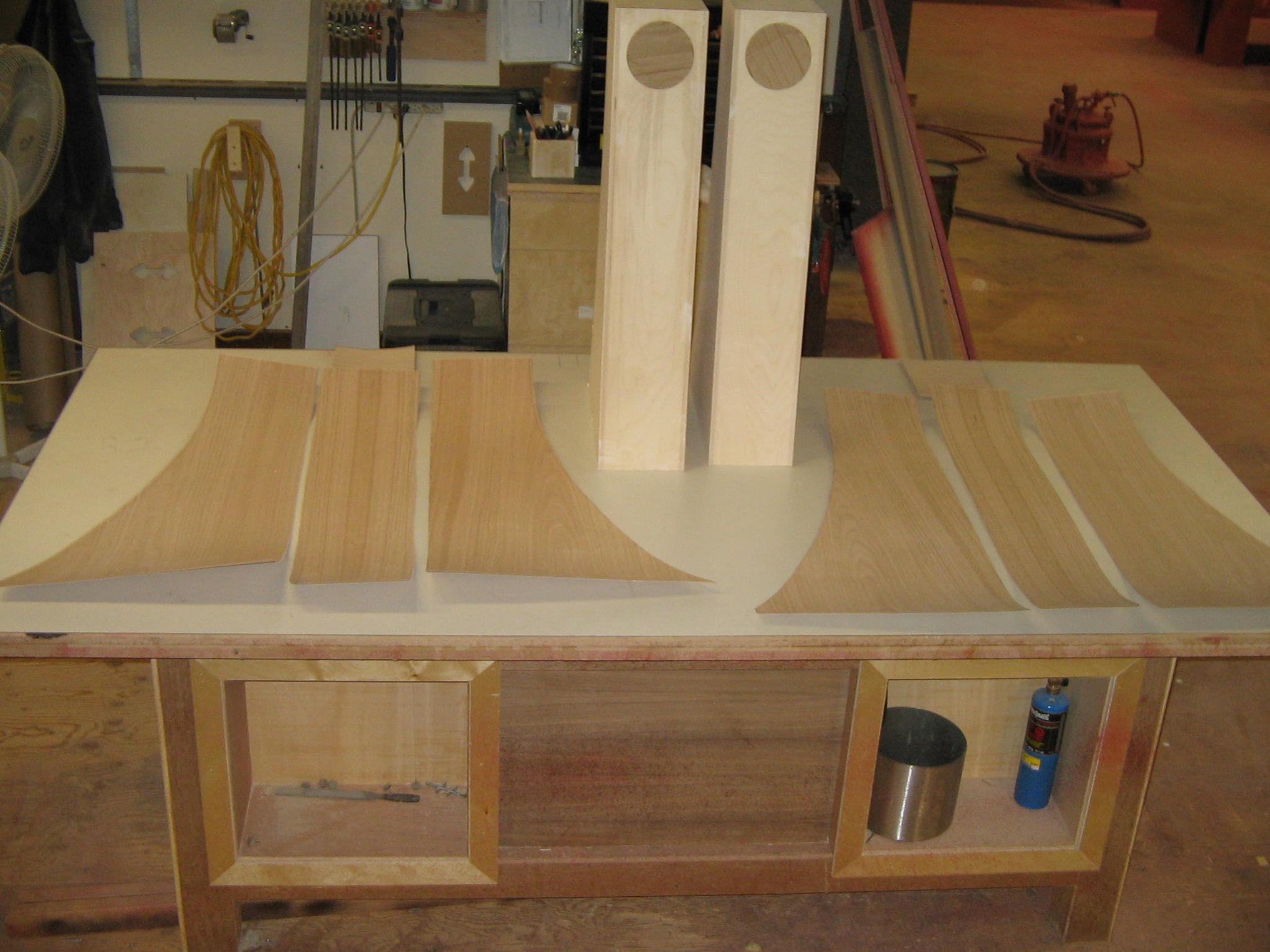

Due to the curved side panels, the yield isn't great. I happen to like to align any figuring to follow the 5dg tilt of the front panel, as well as to wrap the pattern contiguously around the enclosure, mirror image the two cabinets, and center the figuring on front panels. As the flitches on book or slip-matched veneer can vary in width from sheet to sheet, this layout can take some time, and I've always had to dedicate a full 4x8 sheet per pair for either the FH3 or XLs. Most of the engineered / reconstituted veneers I've used have a much tighter grain or pattern figuring -close to rift / quarter cut, so the waste is slightly lower.

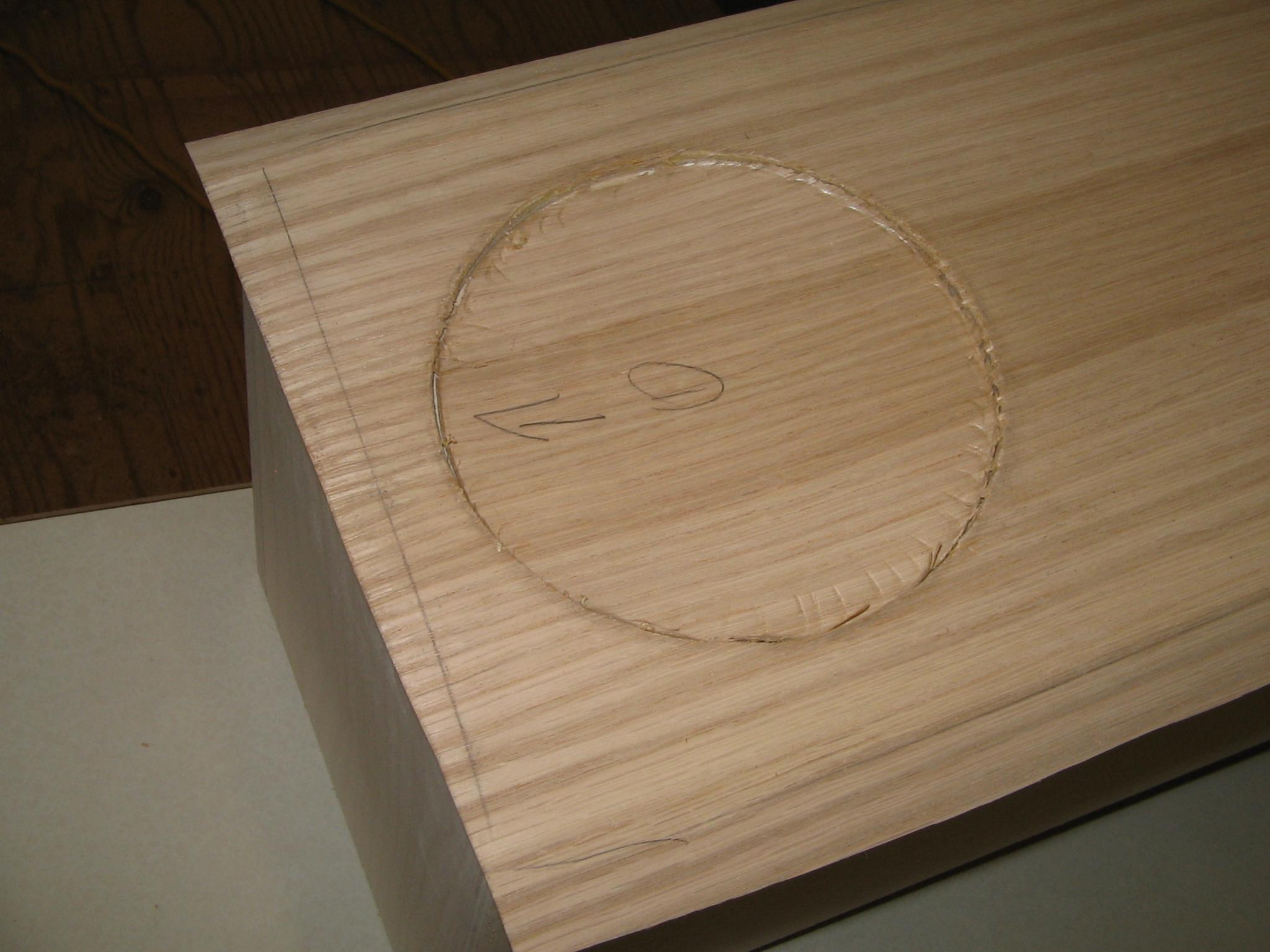

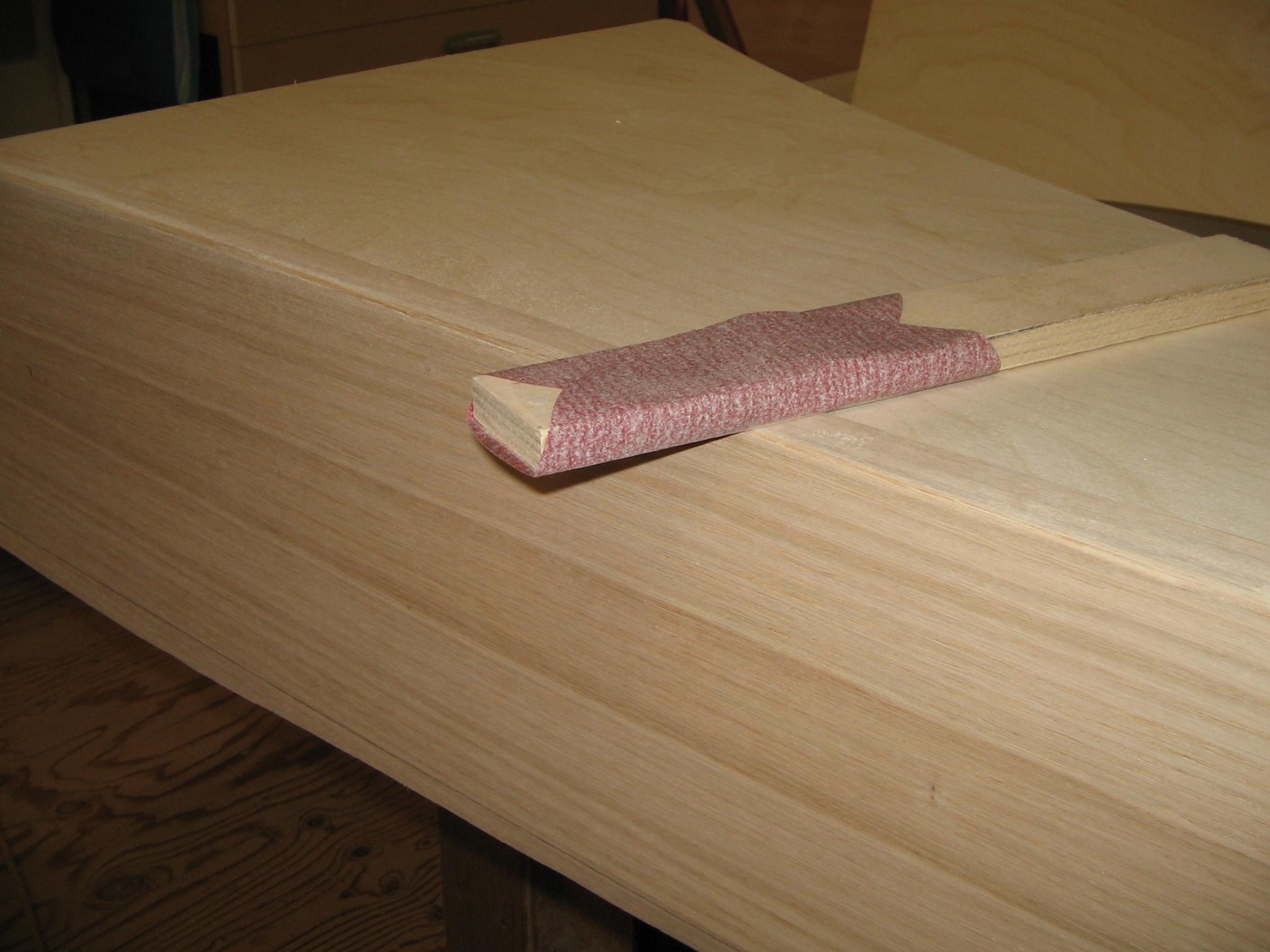

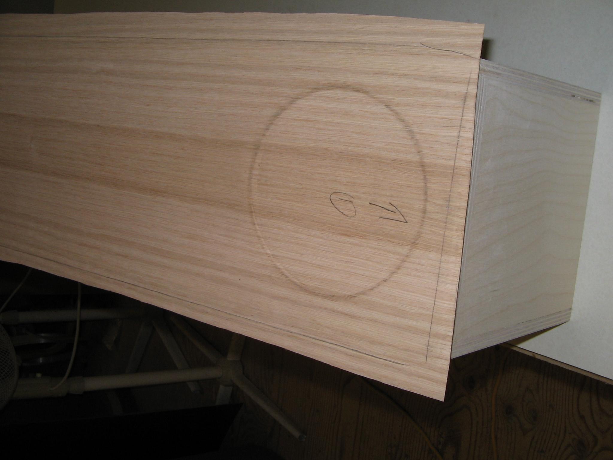

Doug - if not too late a few photos of veneering of FH3 from one of the few times I slow down enough to pick up the camera. As is clear, the curved side panels through a monkey wrench into efficient break out, but I've found this layout works pretty well for a wide range of grain figuring.
Note that I don't worry about scorching with the iron - in fact with some practice, the nose of the iron can be helpful in starting the trimming out of rebated openings for drivers such as Alpairs.
This pair went to Cal Weldon - veneer was flat sliced red oak, with Watco Fruitwood stain and satin finishing wax, and the rear mouth openings sprayed with textured paint and varathane clear top coat. Those are waterborne products that take a few light coats and lots of drying time to fully cure.

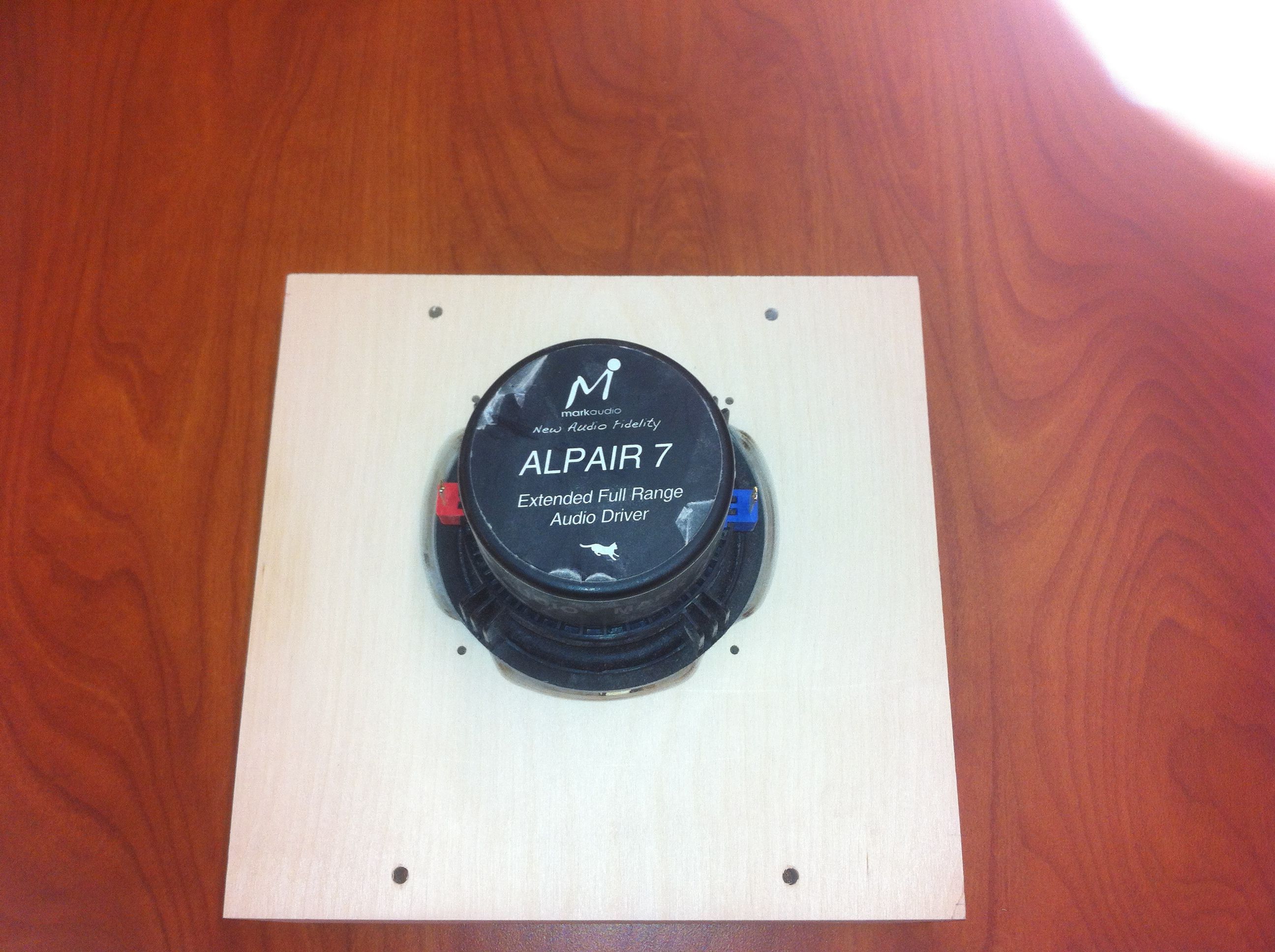

Thanks Chris! No, not too late. I have the bb plywood and the sapele veneer. And I have two choices in hand for the drivers, a pair of Alpair 7.3's and a pair of Fostex FE126En's. The only thing I haven't yet got in the bag is the WAF... Still working that one.
Doug
Doug
FE126En will play louder with less power, but really need a corner to get best bass out of them. Except for the efficiency the Alpair is the better choice.
dave
dave
Doug - +1 to Dave's sentiment. If you have sufficient power, the Alpair would be my recommendation. Baffles take a bit more time than with the Fostex, as the Alpair's thick bezel requires rebating for flush mounting, and chamfering of rear side of driver hole needs to be scalloped around the 4 screw mounting locations.
The sapele should look gorgeous - if you have the option, I'd go for the copper / gold colored Alpair cones.
