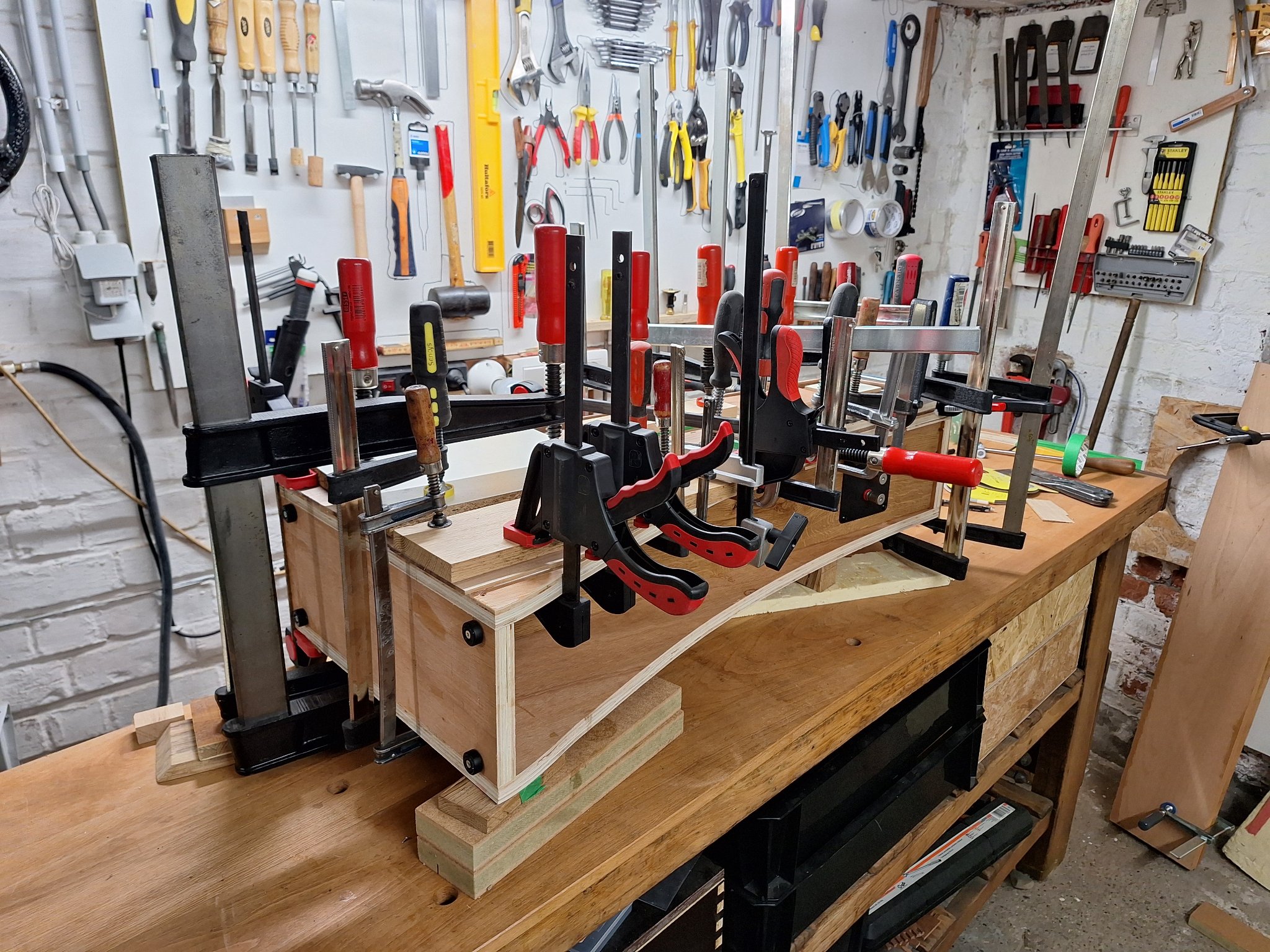

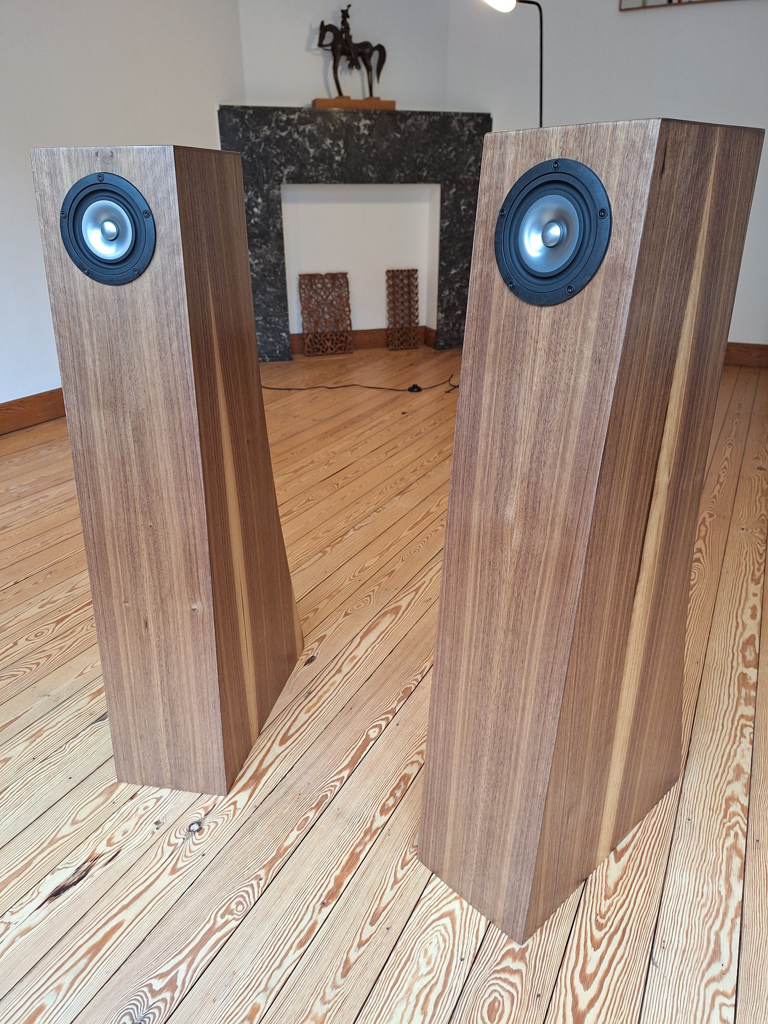

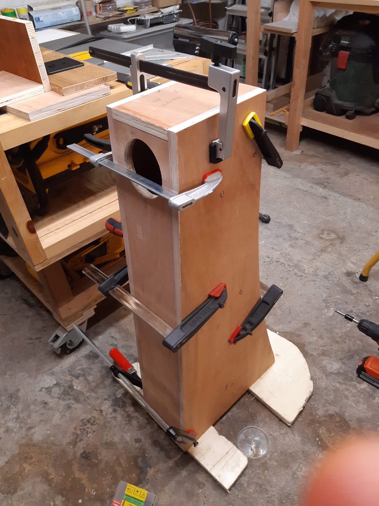

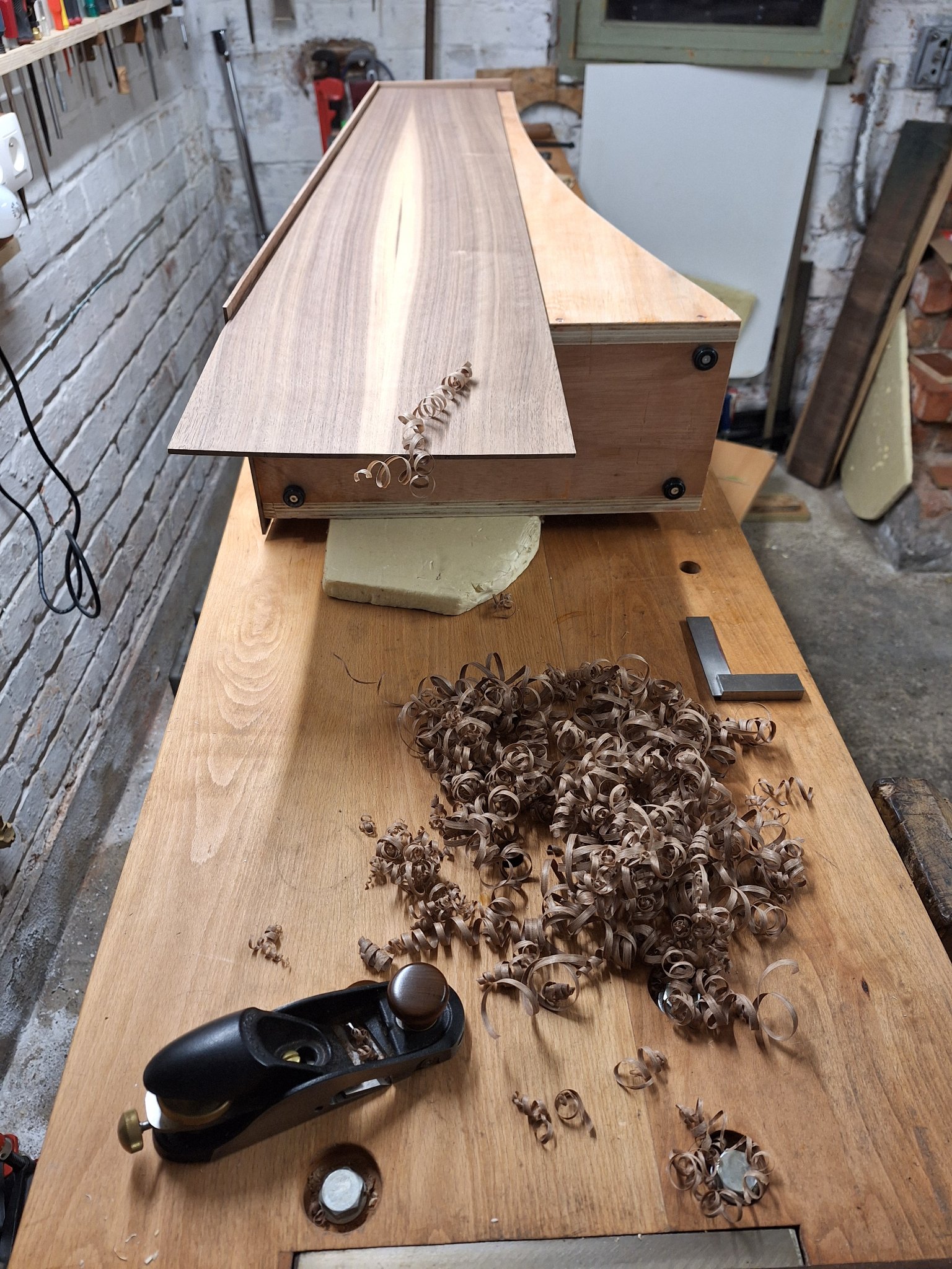

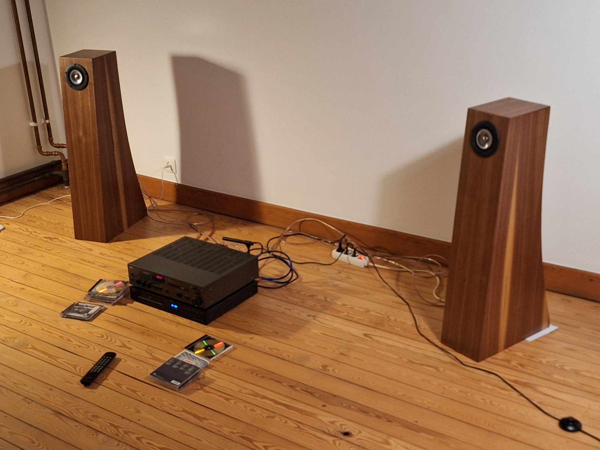

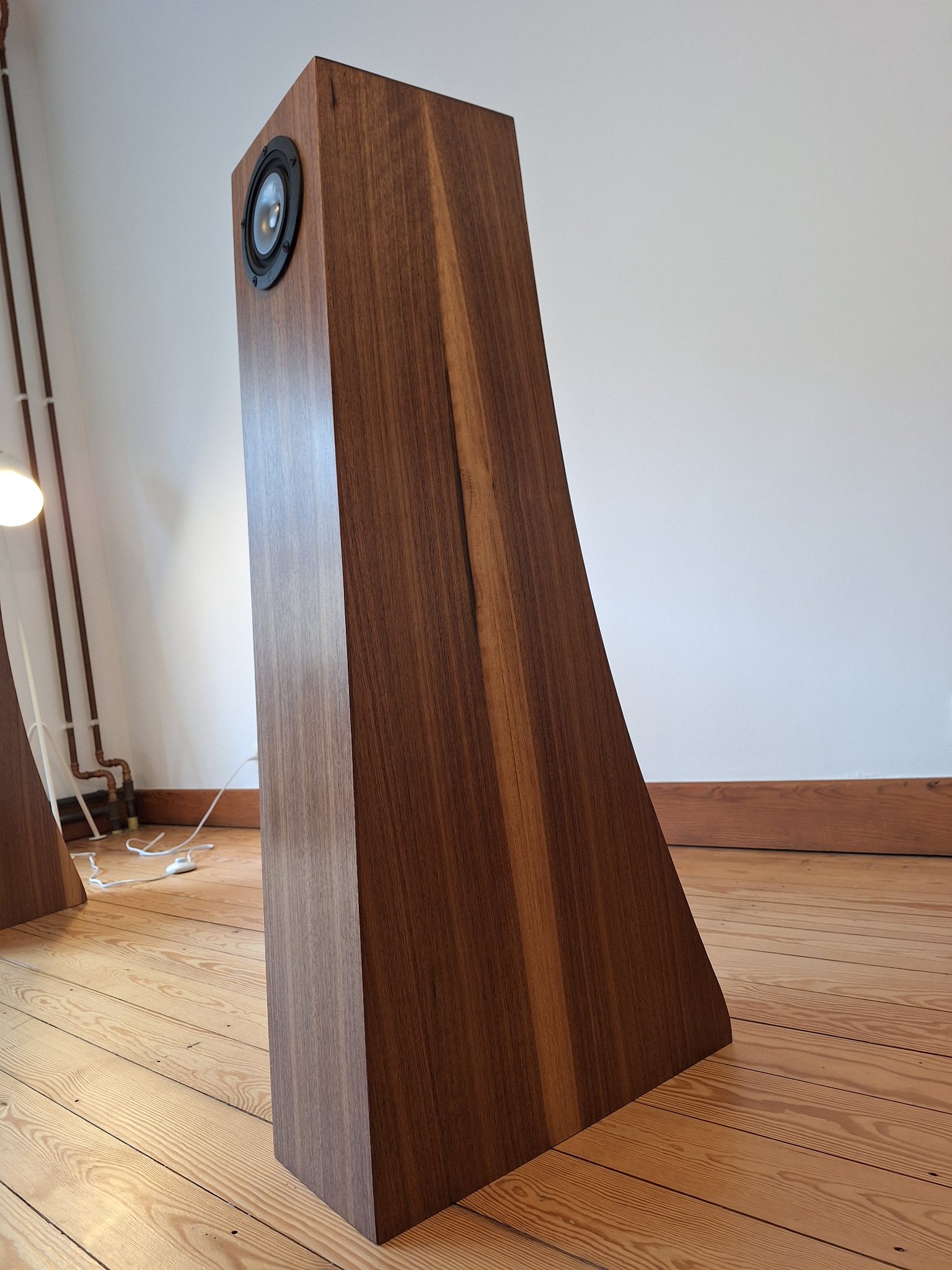

It took me three weeks to build the speakers from plywood and another four months to finish the veneering... But very satisfied with the result! Some pictures of the build proces:Hi, I've just built a pair of almost finished Mk3 Frugel Horns. I say 'almost finished' because the speaker box isn't glued, but screwed together so that I can still make adjustments. The woofers are Alpair-7MS. The cabinets are made from 18mm plywood, and I plan to veneer them with walnut wood.
Very nice! Please tell us what the veneer is.It took me three weeks to build the speakers from plywood and another four months to finish the veneering...
jeff
American walnut 🙂Very nice! Please tell us what the veneer is.

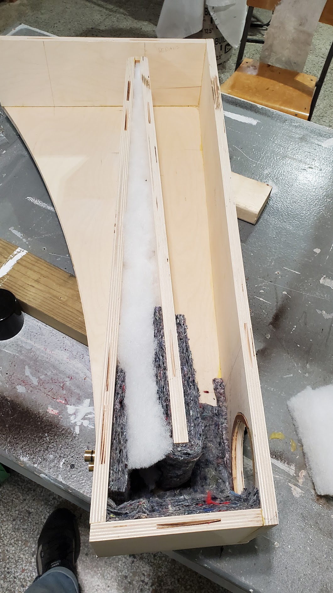

Hello all,
Do I need polyfill in the front section? The plans says "see notes page ix for driver-by-driver" but couldn't find info. Driver is Alpair 7 MS. They will be placed close to the wall and I can't have too much bass as I live in an old apartment. Both my receivers have tone controls so it's not to end of the world.
Other question: you can see the opening at the bottom where the back meets the internal wall is incorrectly angled. I traced my line wrong for my biscuit joints and the V is slightly larger than intended. Had to wedge some wood in between to close the gap.
Will this affect sound negatively?

That i pretty good.
The amount damping below the driver depends o=in driver, room, position, amplifier, taste all have an affect of the amount required.
Wen only know A7 — a good start is 20g.If you have too much bass, first pull the speaker out further, and it that is inufficient (or not possible) add damping. Reverse if not enuff bass. A high Rout amplifier will tend to require more.
dave
@tcpdumpling : try to do what I did. Close the speakers temporarily. Do a listening test and change the filling until you're satisfied.
