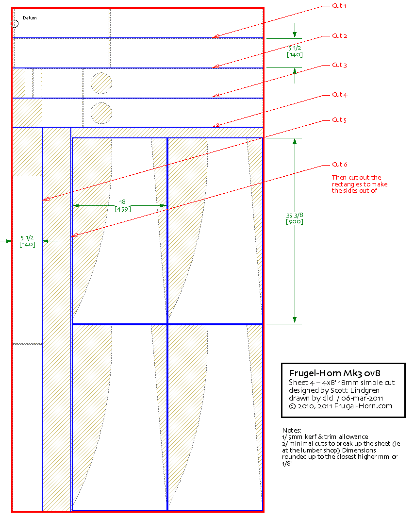

Here is my version of an 18mm cut plan for 18mm.
Designed to optimize the size of the largest offcut*, and to maintain grain pattern -- i suspect many of these will be natural BB finish.
* one chunk just slightly over 25 x 29", large enuff to make a stabalization base (shown ghosted out in blue)
I have a whole bunch of pages to add to the document, will add this & the other pages over the next day or so, and also try to get a 1st page for the website so that it can be hosted there.

Hi all,
Yippeee!!!! 🙂
Thanks Colin,
That's a great way you did that cutting sheet. I do hope you don't mind I've re-drawn it so that it can be printed off without using 1/2 a tank of black ink 🙂 and the bloke at the the Do It Yourself shed can cut it;
My idea being that the 4 off 140 strips are cut first, the remaining piece turned through 90 degrees and the other 140 strips cut while the 140 stop is set then the remaining pieces in the same fashion.
I can cut the 5 degree angle and the curve with me little jigsaw on one piece and use that to mark the other three.
Thats Reely Grate thanks a million.
Jim

Taking Colin's diagram, here is how I would one-man it out of a 4x8 panel.
0. Build yourself a T-square cutting guide out of scrap material. You can find the instructions out there on the Internet.
00. I have a 3'x6' sacrificial table top on a pair of saw horses. I can still manage to get a 4x8 sheet of plywood on it, but I can no longer get a sheet of MDF on it. For MDF, I just drop the sheet on the driveway and put 4 2x4's under it.
1. With a circular saw, cut off the 4 140mm pieces.
2. Cut between the remaining doubled pieces.
3. Now you can rip the individual pieces on a table saw as long as you can rig some kind of outflow table. I have a jig that fits my router table so that it can double as an outflow table for the table saw. Of course, if you don't have a table saw, you can do this with a circular saw and the rip fence you made above.
You can get the two cross cuts done at Lowes'/HD (speaking to the USA now), but my experience is that their panel saws are not square in any axis and I have to re-cut the ends. Also, the utility blade in their saw really tears up the cut. I have a 60 tooth blade in my circular saw that does an acceptable job. Not as good as the 80 tooth blade in my table saw, but acceptable.
That's my technique. YMMV.
Bob
Jim (Jemraid),
Apologies for my poor image. It was exported from my original AutoCad drawing file so quality was poor. Normally I would print the image onto A4 paper then scan that print, but my printer ran out of black ink. BAH!
One small amendment to your revised image cutting list. For 18mm material the 456mm dimension should actually be 458mm.
To be pedantic should be 458.5mm. But who builds to 0.5mm, hey 🙄

I am also adding Colin's variation of the cut to the plans for those who have the local lumber shop do the basic cuts (certainly makes them easier to stuff into the VW).
My drawing shows less scrap than Colin's (or maybe just moved around as i've allowed for a 5 mm trim/kerf
attached for comment & comparison
dave
edit: attachment updated to add some of Jim's comments from post below
Hello all and Hello Colin,
Thanks for clarifying that Colin.
Here is the new and irrevocably final cutting drawing for the FH3 builders like me who have few tools, but do have the will to do it come what may.
The idea is to use the cutting service of one of the Do It Yourself sheds [I will use B&Q in Chesterfield] the first cuts being the 140mm ones, the sheet is then turned 90 degrees and the other 140 cuts made while the 140 stop is still in place. Then the 4 sides can be cut in the same manner.
When I have made cabinets in the past I found that a talk to the cutting bloke with an emphasis on getting the cuts parallel has resulted in good cuts.
Warmest wishes - Jim
