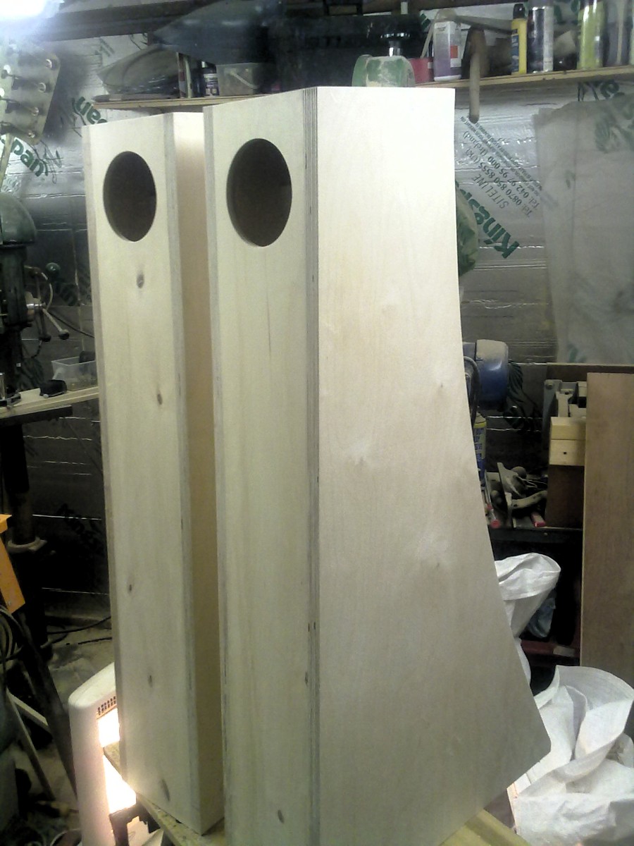

Hi
I just completed a pair of FH3. A lovely design and a very simple build. I first made an accurate template for the sides from 9mm high quality ply. I used this to draw the shapes for the sides, onto 18mm furniture grade baltic birch ply, which were cut slightly oversize on the bandsaw. I fixed the template to each of the sides with a couple of screws to finish off with a flush trim router bit.
The fronts and internal panels, including angles were all cut by bandsaw.
The hole for the driver was cut by hole saw and then chamfered on the inside with the router.
When gluing up, I started with the front, then bottom, top, back then centre, making sure each panel was perfectly square to the side by using a square. When dry, simply clamp on the other side to complete the sandwich.
Have tried several glues, but like Bison pu Timbermax in cartridge. Very strong bond, easy application, slightly gap filling and easy cleanup when dry.
I am waiting for veneer to arrive. Any advice on driver choice would be welcome. I quite like the look of Alpair 7.

Edit: dave beat me to it.
FH3 is designed to be relatively flexible / accept a reasonable range of drivers. Baseline are the Mark Audio CHR70, CHP70, & the CSS branded EL70. The A7 has also been used to good effect. The FE126En also works but as you would expect, this provides a somewhat more damped alignment which is best corner-loaded.
Decision made. The piggy bank will be broken and a pair of alpair 7 ordered. If the fh3 sound as good as they look, then I suspect my trusty fh1 will be for sale shortly. I will report back when up and running. Thanks for the plans and advice.
