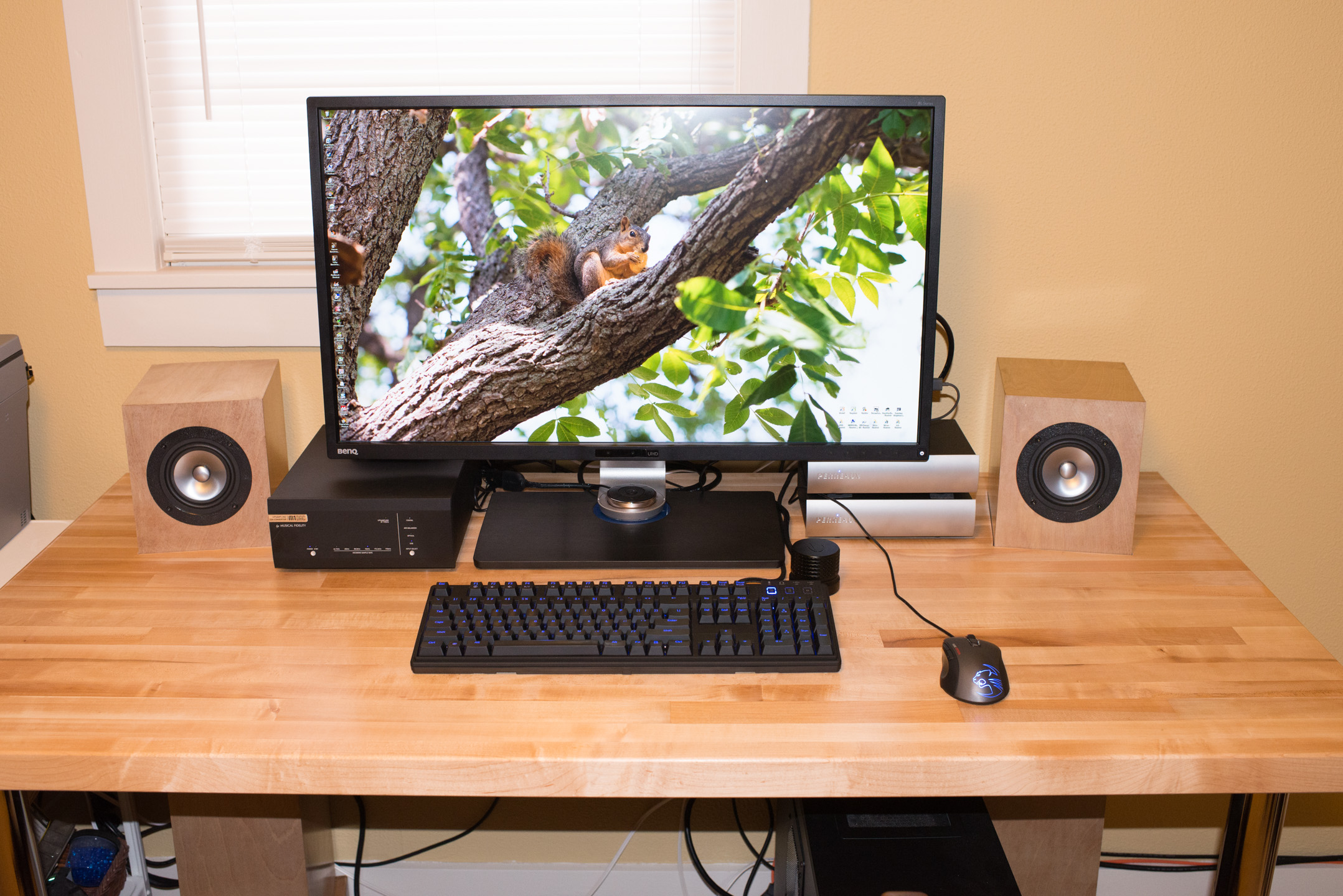

Edit. Do you have a photo of the rear? Is the tabletop open behind the speaker, or flush to the wall? Do you ever think the table top causes any weird reflections? Ever lay towels on the table top to see if there's a difference?
Sorry for the 50 questions, but my son's getting older, he'll probably need a computer (and desk) for school next year.
I was about his age when my Dad upgraded his stereo, and handed me down his Marantz integrated. It was some kind of a conspiracy for me to get the music bug, cause my Mom got me a pair of Polk 4a Monitors at the same time.
The top has two holes routered into it that just fit the tops of the cabinets. I had to "square up" the top few inches of the cabinets to keep the front/back parallel so they'd fit in the hole, and I had to trim a few inches off the flare at the base to keep the desk from sitting too far out from the wall. There's about 3 inches of table behind the inside speaker corner, and the desk is about an inch from the wall.
I posted a few pics in the Planet10 forum
I mentioned this in the Planet10 thread- The imaging is so precise, it's like the computer screen is the source right in front of you. So if there's any reflections, I don't notice a detrimental effect. It's funny, I started thinking about this a couple of years ago, and reflections off the desk were one of the issues I thought about then.
Any pair of speakers sitting on a desk would suffer the same reflections, so I guess it just doesn't matter to me. I could try a towel, but since I'm not going to leave towels on there the result would be moot.
No problem. It's kind of expensive, the table top was $250 shipped, and it seems like the flat packs were about that without shipping (I bought them 2 years ago and just now got around to assembling them), the front legs and drivers would add about another $250, so a chunk for a computer desk. But like I said, it's something that's been floating around in my head for a while and I had to give it a shot. I'm just glad it turned out well, the sound quality is really great.
