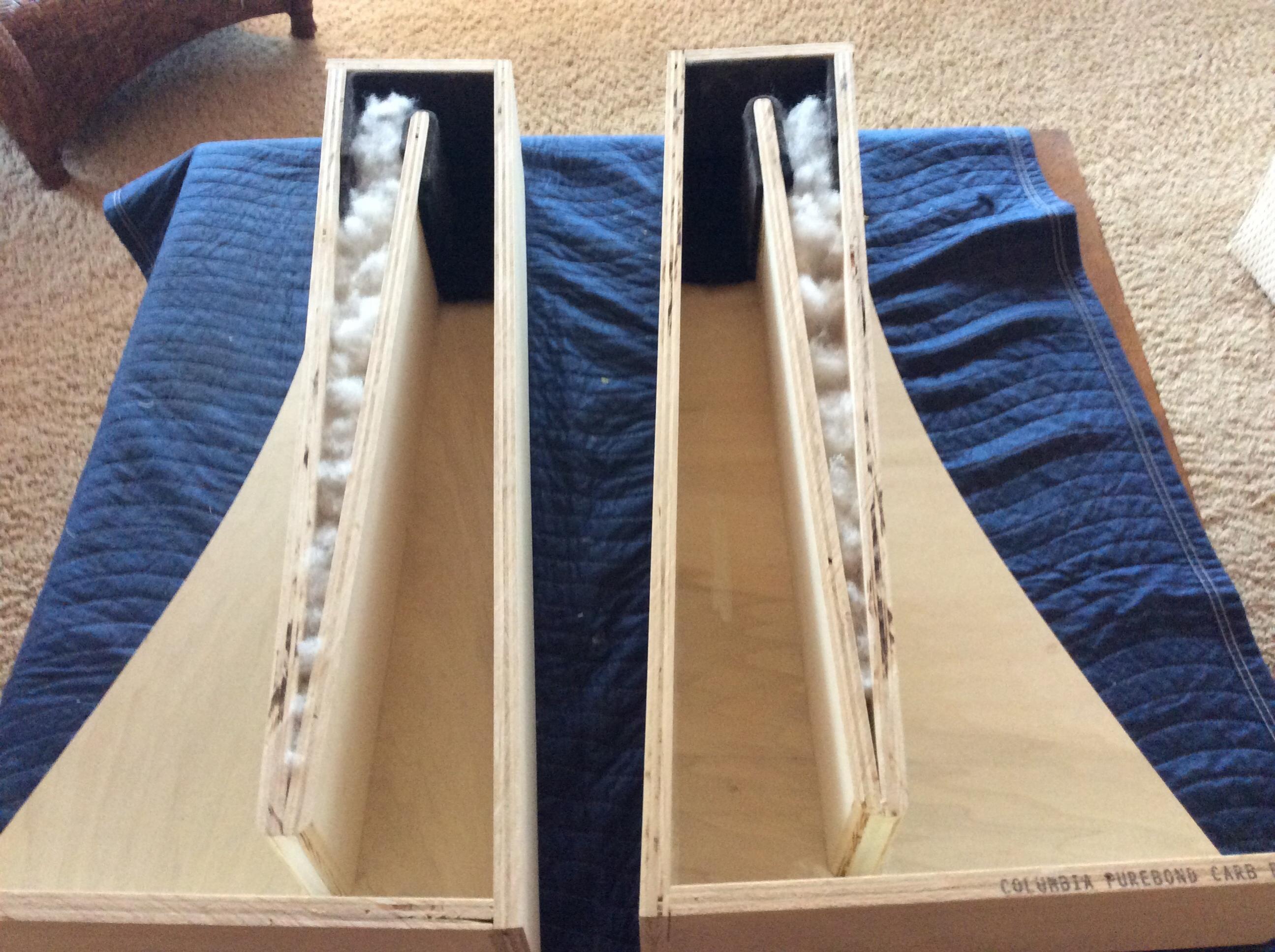

I've made through all the posts. My Alpair 7.3 are breaking in to Jacinth Autumn Leaves down in the TV room. I built my Frugelhorn Mk3 with 3/4 cabinet grade. I'm waiting on some binding posts from Madisound. I have 30 grams in the pointy side stuffed more dense towards the point. The area around the driver is lined with 1/2 inch wool felt. I am very excited about this build. There's are the forth pair of speakers I have made. I will try to post some pictures. I tend to cut the sides a bit over sized then trim them with a router. I have some nice African Ribbon Mahogany veneer. Or I might try to do a black piano paint job. Many thanks to all who have contributed to this great project!

I was doing the final steps today on my cabs, sealing with silicone, sanding out some rough spots, and fitting the bottom when I decided to measure the throat. It came out at 1 1/4" instead of the 1 1/2 in the plans. Will this matter? Since the bottom isn't glued on yet I could lower it by the 1/4 inch so it would not be flush, and then fill in the gap. I could also try to sand the roundover down by 1/4 inch, but it is solid oak and would take forever.
Both of these options are a PITA, but I'd do one if the wisdom is to keep that dimension as spec'ed.
Have you measured the 2 internal boards and the side panels? It would be nice to know where the problem lies. Not that I'm anything but a beginner though.
I've decided I'm going to mount the bottom so that the measurement is correct. I'll decide from there if I want to fill the gap. The top of that same box is also off, by about 3/16ths. So I must have put the rear baffle slightly too low. Overall the dimensions will work out. The other box came out right. I'll decide when I'm doing the remaining cosmetic work whether I want to fill the gap. Because the top cap is lower I can flush cut the sides and front baffle to wherever I put the top, and I was planning on doing that anyway to cover the edges.

Haven't reverse engineered this alignment, but the reduced horn vent area/'faster' flare you've created will just lower tuning a bit and/or reduced the amount of stuffing required, which when combined with the room's acoustic impact on performance may be moot or for the better overall, though no way to know for sure of course, but I recommend Scott/whoever sim it before deciding what to do.
