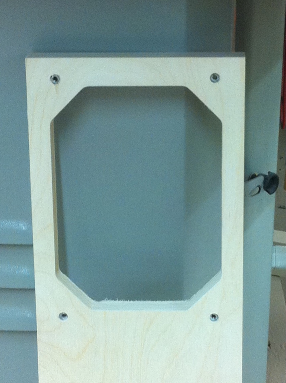

An easy option to allow for swapping of drivers with different cut out sizes is to make the main front baffle with a large rectangular opening, and a set of separate mounting plates for each driver.
Use threaded inserts to allow for repeated removal of plates, and seal with a perimeter gasket of PSA weatherstrip tape
This should also provide enough access for adjusting fill levels immediately surrounding and below the driver as might be necessary.

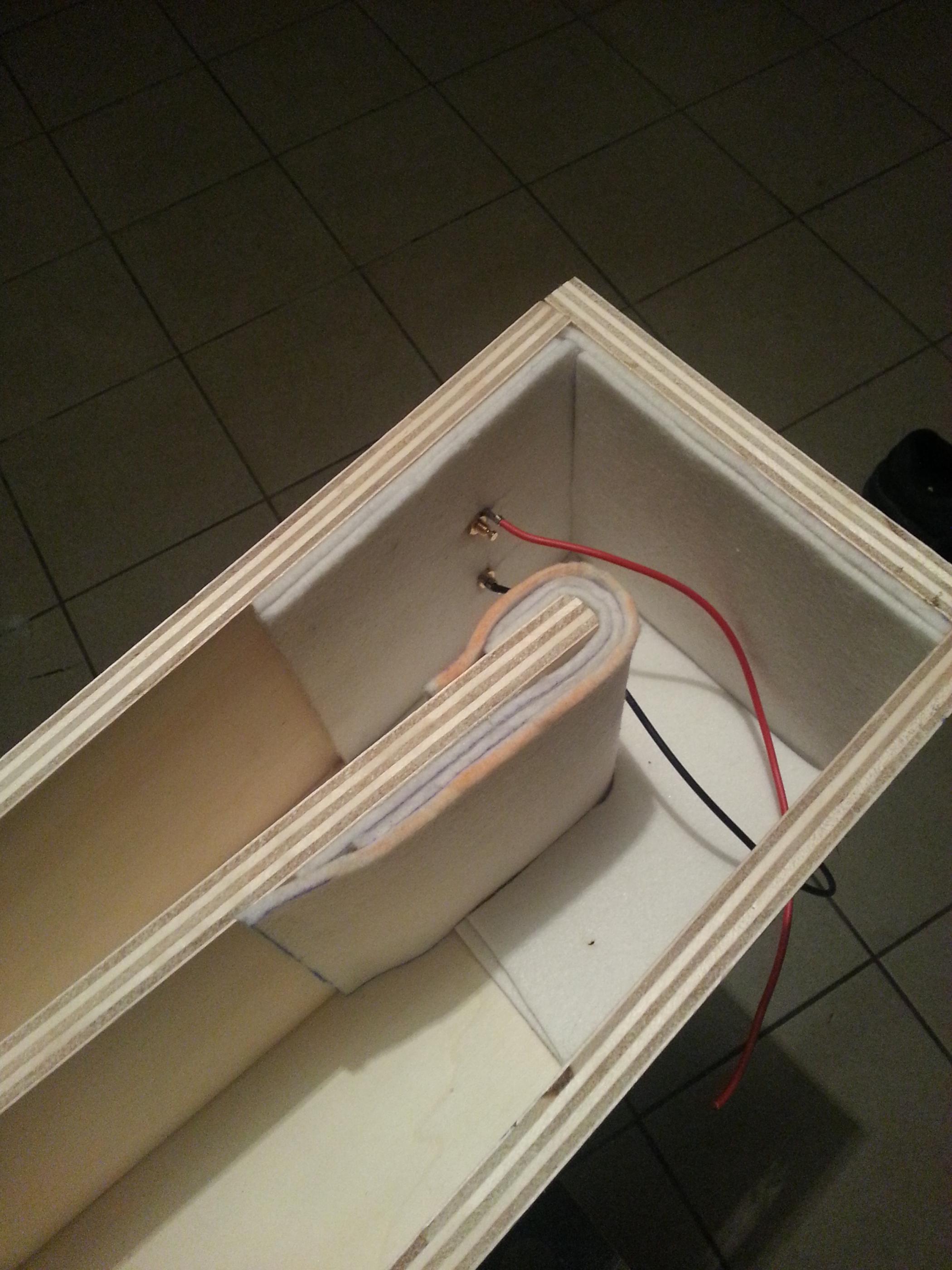

2 things:
- I assume the fibre fill "above" the driver location (i.e. from slightly below where the wires feed to the driver and in the rear tapered section of line) is left out for purposes of clarity of the photo
- I've never built FH3 without the 1/2" Ultratouch, and the panel padding shown looks to be a bit light for the job
Don't forget that once the second side panel is securely attached, it's virtually impossible to access the inside for adjustment of the side walls and rear section.
