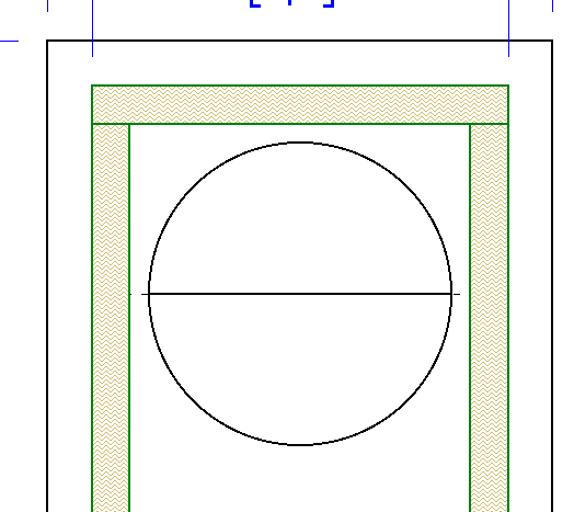

If the felt is of appropriate density, air passes right thru it. Low frequencies don't see it at all and HF get absorbed (as required)
Attached is a FH3 diagram with 1/2" lining. Magnet on the FE126 is slightly smaller than the cutout.
dave

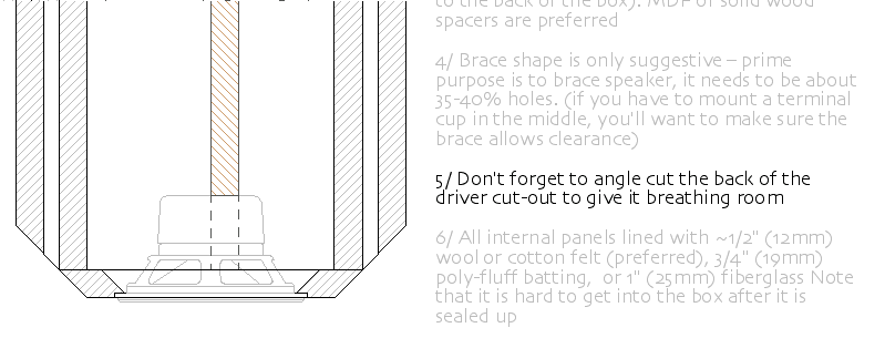

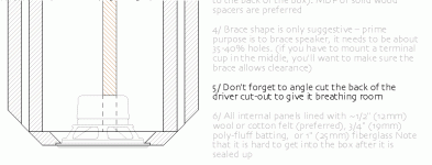

...has a rounded or beveled edge on de inside been considered?
It is a given. Driver cutouts are depicted as in the drawing snapshot attached and item 5 in the notes is standard boilerplate. Thanx for pointing out that it is missing. I really need to find some time to add to the drawings.
dave

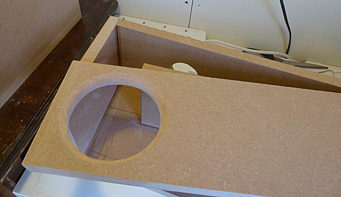

Back chamfer
Dear Triode-al and Dave
I used a little round rasp on the inside of my baffles and finished the chamfer off with some really coarse sand paper;
Outside on a windy day and wearing a mask!
