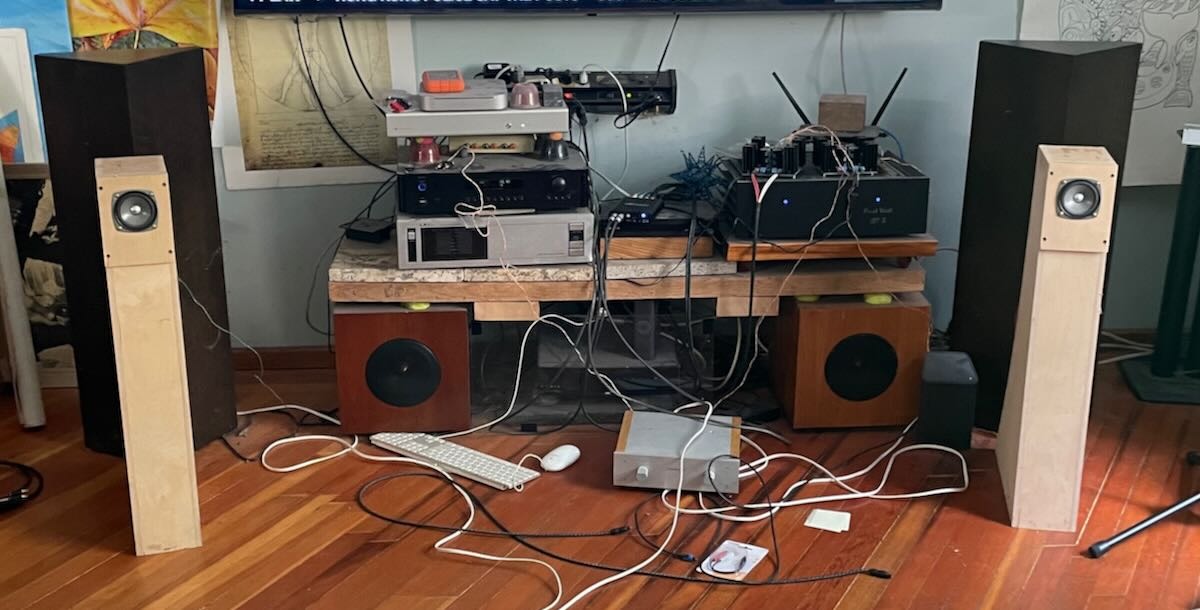

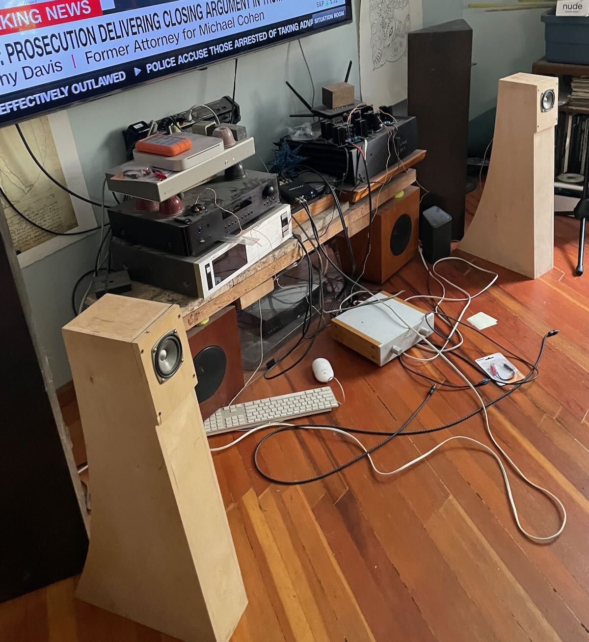

Trianguaklr columns/wedges -? Dipole wedges?Chris & i just spent the afternoon playing with REW and the miniDSP.
If you are lucky Chrios will post some graphs.
Basically the FF85wKeN in FH-Lite was close to ruler flat from 500-9Khz, with some room humps and dips below that. Top rolled gently down some dB by 20KHz.
woofer is the brown Trianguaklr columns/wedges in the back.
Bass in room at teh listening position, produced bass down quite low, into the 40s. Adding the woofer did not ad dmuch extention but boy did it bring authority.
dave
Also, it’s interesting that people complain about their cables and cable noise and you have crap everywhere. So do I. I clean it all up for serious listening though.
I have some mellow sounding 3” TB’s that I need to put into an FH.

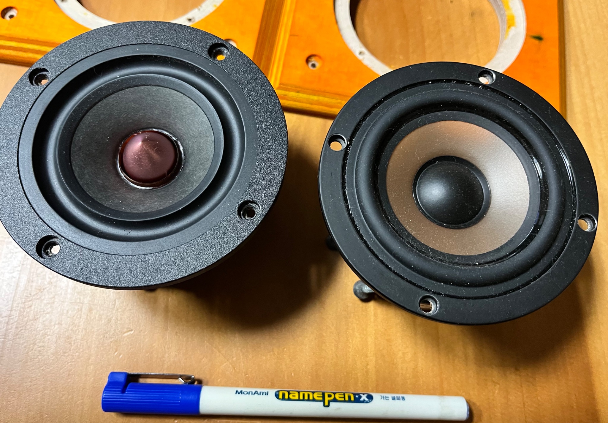

I am thinking to give the Alpair 5.2 in frugel horn lite a try. I found out, that I dont like too much top end energy. I had Pluvia 7.2 in a Pensil before and I found these fatiguing over longer periods with too much information.
How does Alpair 5.2 compare to this? The Fr graph shows much less peak in the top end.
Iam fan of CHN50 in baby labs and like them a lot. But some more quality would be ok.

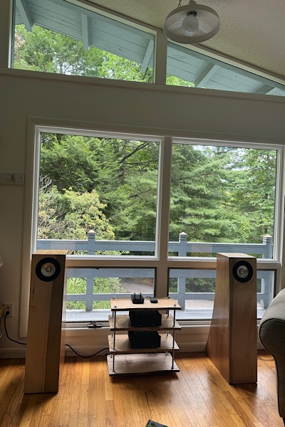

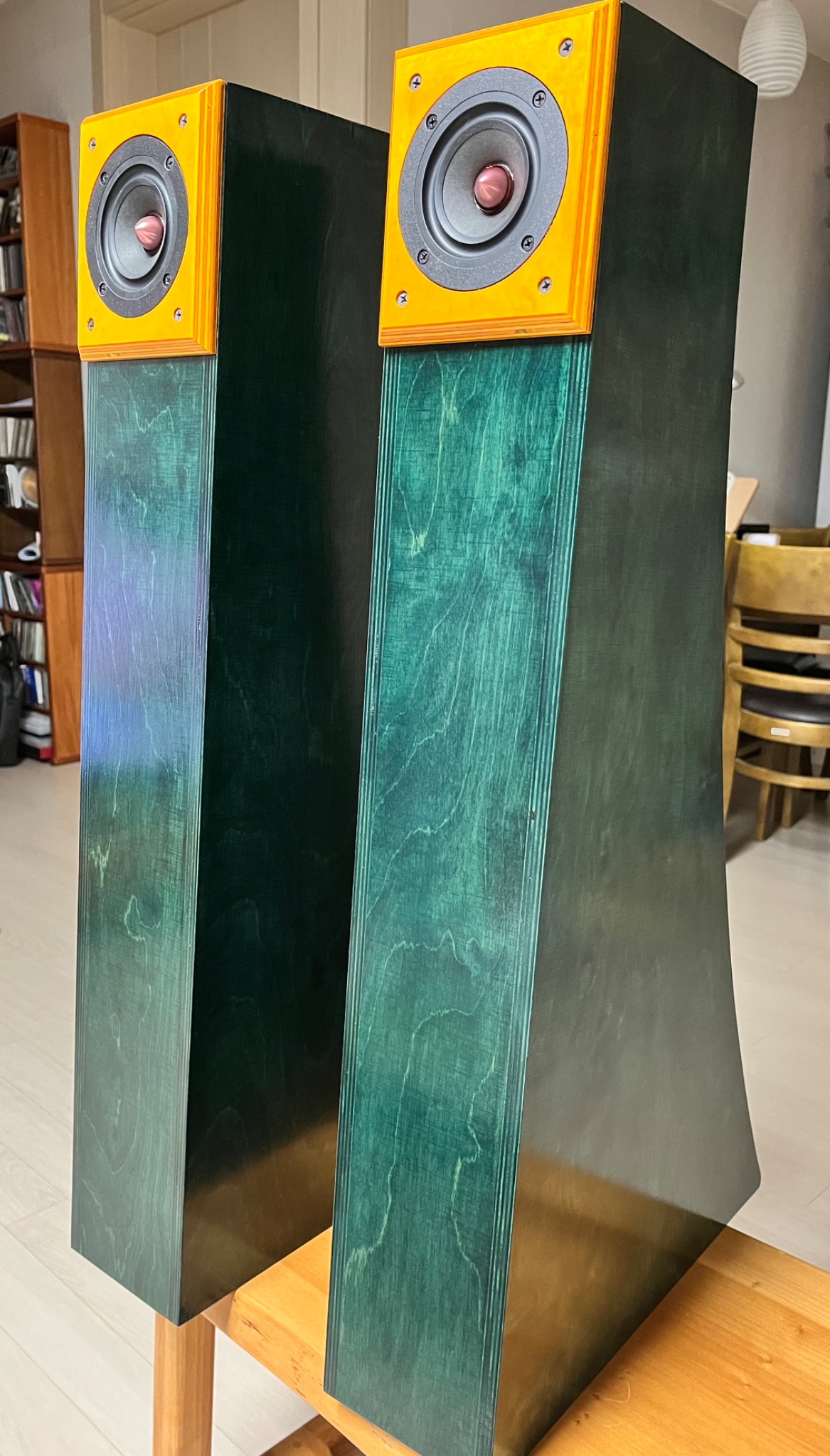

Chn-110 in Frugel Horn XL. Pass ACA Monoblocks with a Tube-03 pre-amp. Cheap Spotify streamer. So around 8wpc, amazing sound, phenomenal bass. Plenty of volume for my listening. I don’t have much experience but it’s hard to imagine much better than FH’s.

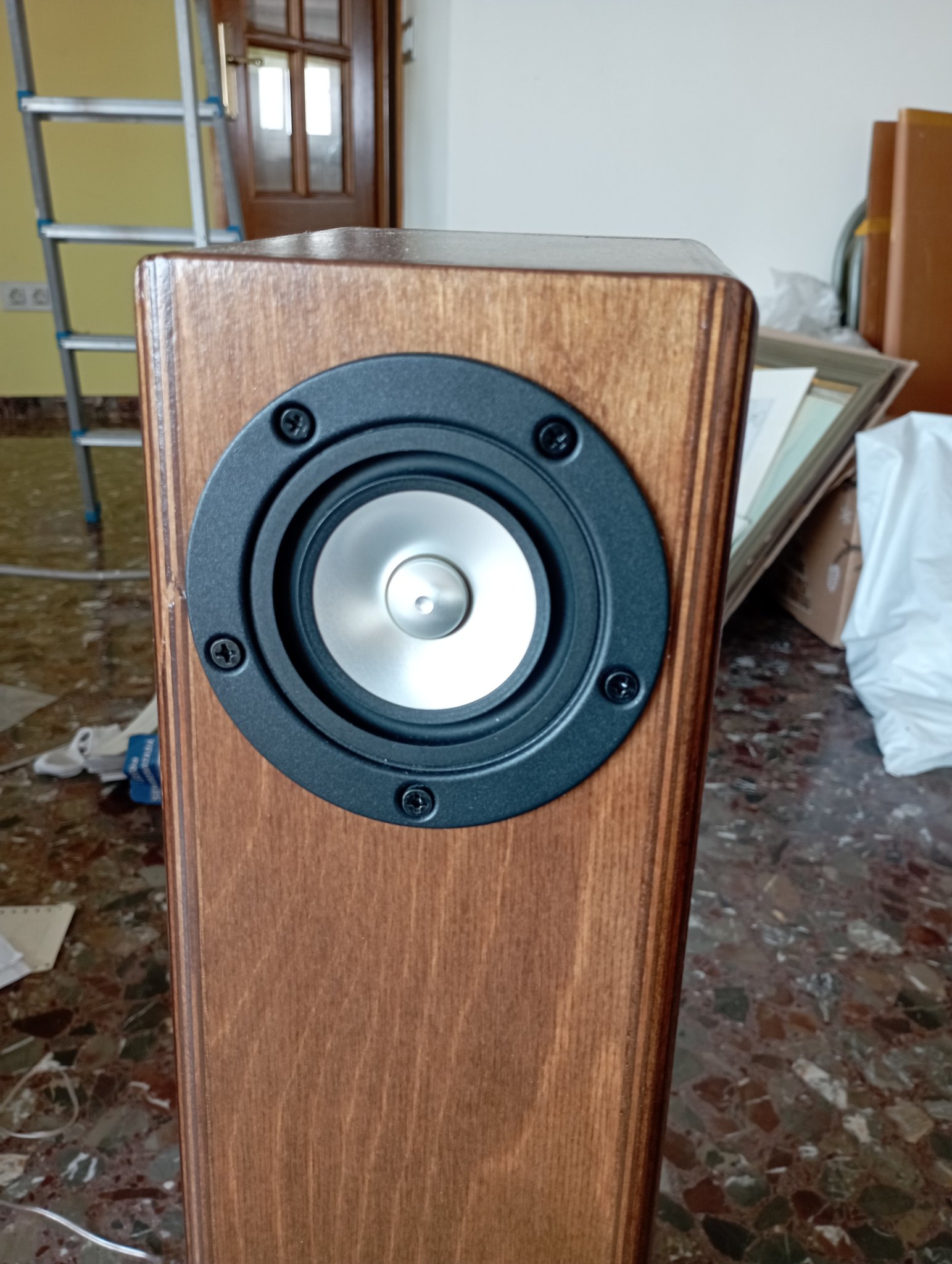

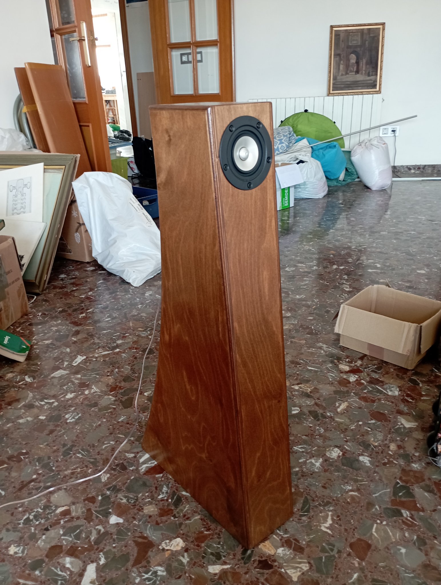

I have committed to building a pair of these to try and replace some small bookshelf speakers. They will be used, more or less on a book shelf... (Only have 4.5" on either side of the TV)
I realize ill loose a bit of bass from being 3' above the floor... But its a small room.
Being up higher, i would also like to remove the 5° slant.
Is there anything special i should consider other than cut at 0°?
Thanks!
Thanks!

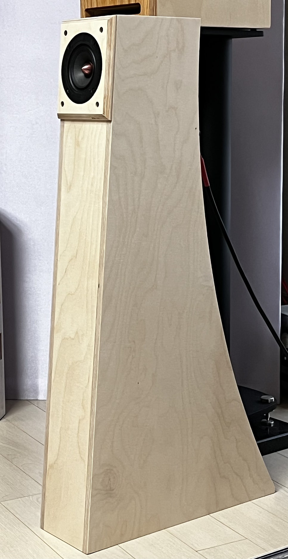

Looks like i haven’t done the unslanted baffle version of this Frugel-Horn. I’ll work on fixing that, could take a bit. While i’m at it, anyone want a twin?
dave
dave
My max height is 56" so probably no FHL twin for me. Though if the FHL sounds amazing, I might try a larger unit (maybe even a larger twin...)
So many speaker plans not enough sawdust... 😉
Could someone point me to how to model these in hornresp?
Not sure hornResp is flexible enuff to simulate these.
The planset should havea vertical baffle version.
