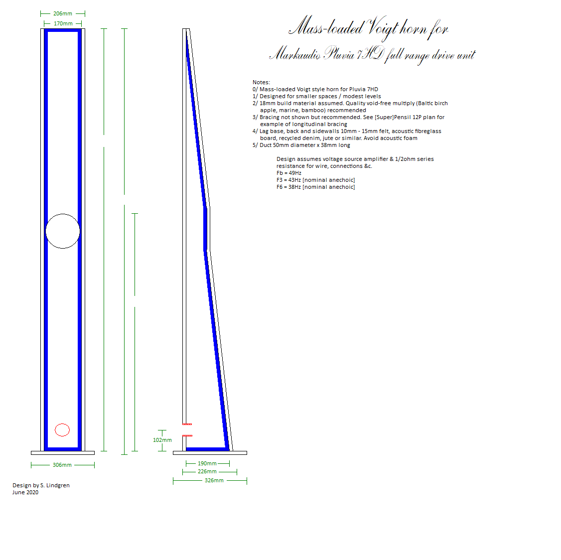

A Voigt pipe in the usual parlance is a conical horn tuned to 1/4 wavelength (there are exceptions) of the desired Fo & is rarely impedance matched in its functional BW (again, with certain exceptions). It's basically a standing-wave generator; having positive expansion that means 1/2 wave with a 1/4 wave fundamental. The ripples in the FR are a function of the pipe harmonics, just as they are in a straight pipe, albeit with both odd and even harmonics. FH3 is a hypex (hyperboilc) corner-horn, impedance matched to a much lower frequency. Different flare profile, different results, far less harmonic ripple through it's functional BW.
FH3 approximates a hypex / hyperbolic horn profile with two conical expansion stages between which a choke is inserted per Olson which helps block unwanted higher frequencies (viz. shorter wavelengths) from passing in either direction. Said choke has almost zero effect on Fo. As a corner / rear-boundary loaded design the expansion thus continues outside the box, like any other corner / 1/4 space design.

I am trying to understand this, but failing. I cannot see the choke between the 2 conical sections. And to me the 2 conical sections are all but identical expansion rates. I am missing things here.
I think it looks like a quarter horn down to the opening.
But what happens there seems to be an expanded horn.
Since the speaker is to stand against a wall, the back wall forms a continuation of the horn. That's probably why the sides are so deep. They fulfill their function.

Apologies for my lack of clarity. I read the original explanation (probably incorrectly) as meaning the second conic section had a different expansion rate to the first section. If they are the same does it mean all "Voigt" style pipes are hypex.
Is the choke mentioned created by the geometry, or the stuffing?
I am hoping to hear a pair soon, and would really like to appreciate and understand the design more.
Again, any pipe/horn with parallel sides is always technically a parabolic expansion defined [ Hornresp] by its mouth flare tangent angle [degrees].
From this we see it's divided by straight boards = constant expansion and its pipe horn terminus/vent/'choke' [2nd expansion] has a curved divider/terminus/mouth to the corner, so has a plurality/multiple constant expansions to approximate a hypex/whatever flare frequency [Hz].
