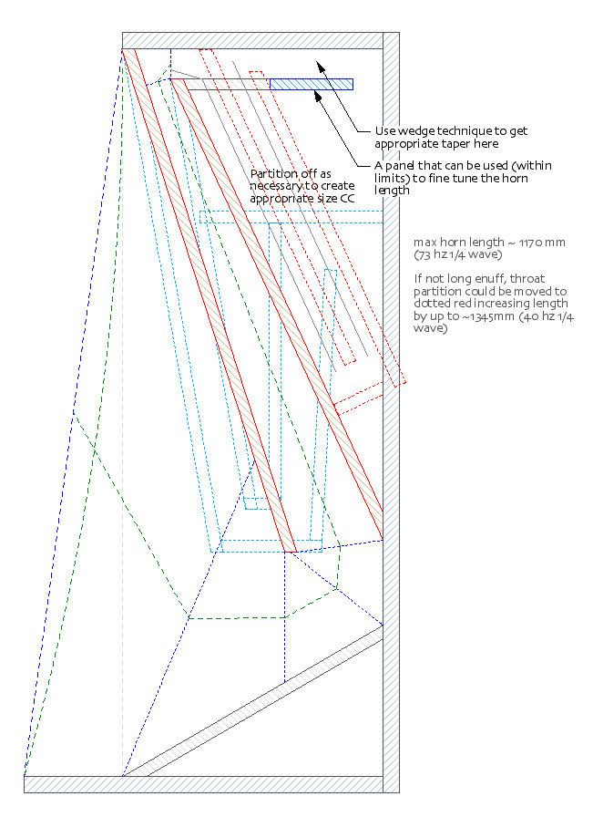

rjbond3rd [/i]I hope there's some interest in a collaborative diyAudio reference project on how to design a BLH / BVR. Is anyone interested in puzzling out how the variables and trade-offs fit together (driver said:
What driver(s) would you guys like for that?
Originally posted by planet10
For the FE126 there already exists Saburo, Austin A126, Frugel-Horn. The 1st 2 are very good in their class, the Frugel-Horn we know could use some massaging...perhaps this project can co-opt FH 2v0? Scott and i already have done some very preliminary work on that,
It does need to work within some constraints to full-fill its original design goals. But i think it is possible to get more/better bass, smoother response, and to simplifier the build (make it more elegant)
Frugel-Horn was always a collaborative project... mostly me with help from Scott, a bit from Martin, and Ron'd flourishes at the end, that really put the icing on the cake,
We should retain the FE126 as driver of choice.
Constraints:
1/ needs to remain petit and corner loaded as an ode to the original inspiration
2/ optional deflector & sBaffle. I think that the option of a non-curved mouth (ie Level 0) build should not even be considered.
3/ i'd like to keep the full height rear mouth (but not fixed in stone), but it does expand faster than it should to be really useful. Besides acting as a deflector, it increases the horn length & mouth size.
Things i'd like to incorporate
a/ a bit wider (tentatively 10mm). The inspiration is 130, the FH 140. One of Ron's remarks was that even that little bit made for an improvement in the shape of the mouth exit curve and the shape of the deflector. There is probably a combination of widths & other factors that could allow for the deflector to be made with 45s. It also takes the width out to where, we have found from other projects, reflections off the side walls becomes less of an issue.
b/ a minimum of pieces.
The attached sketch shows my 1st pass idea of the folding (it is far from set in stone, just a simplification i came up with -- the current is ghosted in in the background). As drawn it is 4 conical sections. It does represent a bit slower taper at the end (and could be slowed even more by legthening the bottom angled piece (allowable due to the last part of 2 above) , and allows for a longer horn with fewer pieces. It also has fewer parallel sides in the air cavity, yet allows for playing with volumes.

That was something Dave & I chatted about during the original FH design process. I reckon it could make a good basis for the FH MK2.
Without going into specifics here, FWIW, I'm going to throw this out for the sake of debate:
I don't think we should pursue maximum LF extension with these. If that is desired, the slightly larger A126 (or other cabinets) will serve the purpose better. I think a more sensible goal for this design, assuming it's decided that an FH MK2 should be the DIYaudio reference horn (the FH is supposed to be a community project, so it seems logical to what passes for my mind) would be to aim for a more modest tuning frequency -say, 70Hz, or around that area, & aim for gain / efficiency, and minimising both distortion & driver excursion. The 126 doesn't have much of the latter, so keeping this down is essential to maintaining a clean sound. Going for high gain in the horn's operating BW will also, as Paul Klipsch pointed out, help reduce distortion.
Just my thoughts -any other ideas, agreeing or contrary?
I totally agree. It gives us a chance to get full horn loading when the corner is used. If someone needs more bass, the deflector can be turned into a stealthWoofer(tm).

An auspicious beginning! I naively tried to calculate the mouth of a ~70Hz corner horn, using this classic equation:
Am = 1/(SF*4pi) * (c/F0)^2
Where Am = mouth area, SF = 8 (corner radiation, 8pi), c = speed of sound and F0 is the cutoff.
However, I get .6269m^2. Here's how:
Am = (1 / 12pi) * (340^2 / 70^2)
Am = (1 / 37.68) * (11560 / 4900)
Am = .02653 * 23.59
Am = .6258m^2
If a 70Hz wavelength is approximately 4.9 meters in diameter (not sure if that's right!), and we're using the 8-fold reduction in mouth size (due to the corner), then the mouth would be about 4.9/8 = .6125m^2. So this figure seems to check out.
However, wild-guessing the mouth is ~12cm wide by ~74cm high, I get about .0888m^2, rounding up to account for the RonC-style mouth radius, we can say about .09m^, or even more roughly, a tenth of a square meter.
Assuming any of this is accurate, any hints on the disparity? I'm not lazy, I'm stuck. :)
'GIGO' applies here, ergo you got the wrong answer. :(
WL circumference = ~13560"/F
WL diameter = ~13560"/pi/F
WL area = ~(diameter^2*pi)/4
Am = 1/(SF*4pi)*(c/F0)^2
Am = 1/(8*4pi)*(13560/70)^2
Am = ~0.009947184*37525.22449
Am = ~373.2703105"^2
FYI: 8*4pi = 32pi = ~100.5309649, not 37.68

Hi GM, thank you, I appreciate it. (Your correctly calculated mouth is still much bigger than the FH's could possibly be, so I'm still missing something interesting.) Thank you again!

I'm not going to double check the math right now (i would have done the original calc at least twice), with the deflector and the corner loading, i calculated a theoretical cutoff of 75 Hz.
Remember that with the deflector in place , the mouth is defined by the back edge of the deflecor and the sides of the horn.
In FH 2 i imagined making this more explicit by doing a full height deflector and having the option of extending the top of the horn such that it is also the top of the deflector with the intervening space covered.
Without the defletor the horn cutout of FH 1 is about an octave higher, and the rest is TL action.
