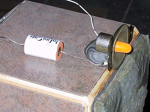

Budget Tweeters
i have been threatening for sometime to do some cone tweeter mods to see how good i could get an almost no cost tweeter. I have a number of 2" alnico "thimble-magnet" tweeters that even stock have quite impressive performance despite their modest value (i've sold a couple pr for $2 USD/pr).
1st mod was to do a dustcapectomy and add a phase plug. I discovered that my earplugs were just right for this job. I have only been able to find 3M ones so far and they are a bit fatter so i had to shorten them (next ones i'll try to do a better job). A washer is glued to the base and they are held magnetically. More pictures on my BD-Pipes page.
I'll listen to them for a while, then treat the paper with either damar or puzzlecoat. This should make the cone more acoustically opaque. And a proper covering of ductseal as opposed to just the blob holding them onto the top of the speaker.
dave
