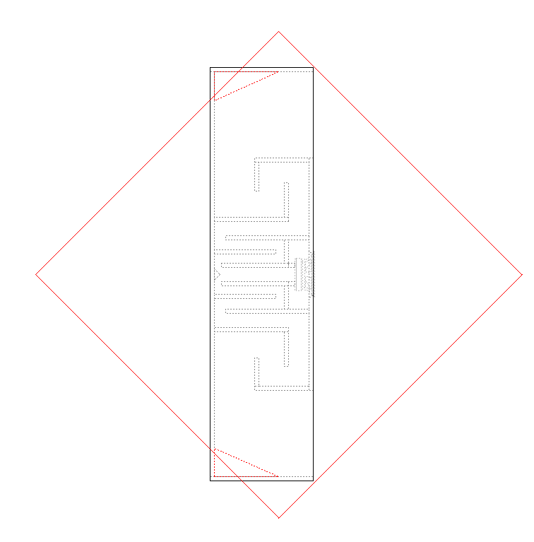

Using the Pythagorean Theorem to make 5'x5' BB work?
I think it could work using 5x5 sheets cut diagonally, probably with only 4 to 4.5 sheets of BB. There will be a small 45deg angle void on the top and bottom rear corners of each side, however, this could be easily spliced without significant impact to the structural integrity of the box IMHO. One could even add some decorative accents to mask these splices.
By my calculations you get just over 84" cutting a 5x5 from corner to corner. It would take 3 of the 4 sheets to be cut on 45's, the last could be cut on all 90's. There is approximately 6 ft of cut-off inherent in the use of three 4x8 sheets making the total required sqft about 90. There are of course 100 sqft in four sheets of BB 5x5 thus giving an average of 2.5 sqft per sheet allowable for cut-off. I will put pen to paper in the next day or so to try and create a sheet-cut plan for the 5x5 using angular cuts. If I can figure this out is there any interest in me taking it to the next level and producing a CAD drawing to post here?
Jeff
It can be done... i don't guarantee this is the optimum rotation in terms of material use... Note that the red bits can just be left off...
I've gotten alot out of this thread about plywood and have been wondering how to get the 6 foot sides from 5x5 sheets.

By the time you calculate the huge waste factor with these diagonal cuts, allow for the full length back panels, recutting the off-cuts to usable sizes for the internal fold panels, time/materials required for jigs, etc., how much will you really save over "splurging" on the 2 4x8 sheets of Apple or Europly?
If I ever get around to building a pair of any of Scott's over 60" tall designs, I would either simply spend the money on the 4x8 sheets (you'd need 2 to include the back panels ), or use 5x5's and overlap 2 layers of material for the outside panels. I'm thinking 15mm & 9mm - 15 for the first would be thick enough that you could join biscuits or full length spline - with careful handling, the joint would be plenty strong enough for initial assembly - and cold press the second layer with overlapped joints after the shell is glued up. This would afford the opportunity to get jiggy with your brad nailing gun on the first layer, and hide it with the second.
