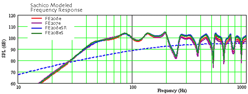

I am fairly new to high sensitivity horn style speakers, esp these rear loaded horn types. I have been building tube gear for some time now but generally the higher powered PP types of amps. I have recently taken an interest in the DHT / SET low powered designs and am in the process of sourcing parts for a build of the Wilson MK1 300B. I know that this new direction is going to require some different speakers with higher sens. than my current Proac 2.5s and Polk M10 speakers. Because of this I am also planning on building a speaker based on the Fostex 206 series driver. I have been hunting for the "perfect" DIY enclosure but have some serious concerns about the frequency response dips I see inherent in the rear loaded horn designs. The Frugal-Horn website has a perfect case in point. The Sachico has wonderful reviews but I can honestly say that I am skeptical given the response graphs that are shown (Here: http://homepage.mac.com/tlinespeakers/FH/images/Sachico-modeled-FR.gif ).
These are some pretty nasty dips that I would find totally unacceptable in the modeling of any 2 or 3 way design I have built or would build. But the reviews.....what about the reviews? They all claim the wondrous sound of these designs.
Well, based on my concerns I am here for some more subjective (and possibly objective) reviews of these speakers....particularly these Sachico horns.
I am also here to ask if anybody has considered or designed an asymmetrical twin path horn like these to where the dips and valleys of one path offset that of the other. It seems to me these dips occur probably near the transition of one cross section/length to the next as the horn unfolds. I am not sure exactly why the dips occur but it would seem to me that if one could design a horn with dips and peaks in a specific place on the freq response curve then another could be designed with the dips and peaks in other places on the curve.
My ultimate question is how would one model it to overlap 2 horns where there is cancellation of these effects. What I would love to do is get some pointers from a knowledgeable person here who could help me design something like this. Specifically, I want to build the Sachicko, at least 1/2 of it, and have somebody give me some estimates of what the other 1/2 might look like. I was thinking of just a trial by error shot at this by building it with one 1/2 exactly as in the plans and then build the other 1/2 scaled a little bit up or down, maybe 15-20%. What I am afraid of though is if I get the scale off too much where I actually place the dips and peaks of one 1/2 right on top of the other 1/2.
Is there a rule of thumb on figuring out what aspects of the horn cause the specific dip? If somebody here where to do what I am contemplating (scaling 1/2 different) what % would you try?

One of the reasons we are slowly pulling the sims out of the frugal-horn docs is that they are often misunderstood.
In practise those dips are not there. there might be a hint of the 1st big one, but the others dissappear in reality.
There are a couple reasons for this.
1/ the simulation software gets less accurate as the frequencies go up.
2/ when these models were made the sim sw did not take into account the room boundaries (Have a look at any of the BIB sims to see how bad things can sim as far as ripple goes)
3/ this sim was done based on a continually expanding line and does not take into account all of the 'bumps" in the expansion that takes place at every fold. Each one of these acts as a low pass filter (8 of them) which stack together to dramatically curtail HF coming out of the horn mouths. It is the HF combing with the front driver in the sim that causes the ripple.

So, are there any real time measurements from a mic showing the actual curve anywhere. I did not realize this was a simulation generated curve, I thought it was measured. Where might I see some measurements taken from a similar design.
So, what exactly is the sim simulating, the response at the mouth of the horn or the wave at the front of the driver? Or does the sim somehow combine the 2 wavefronts together to create this curve?
The big dip that occurs at about 250Hz, is this the one you are speaking of that is audible? How many dB down is the real life response at 250Hz?

I have not seen any valid measurements for these... to do so, one needs to have the measure mic in the farfield (3 or 4m) and to have any chance of not measuring the room instead of the speaker, that means humping one of these to a big, quiet, flat parking lot with no obstructions.
The sim is of the system. The sims do also give driver alone and mouths alone. The software, at the time, did not account for many details, and did not consider that the horn is bifricated. The designer (Scott in this case) to interpret what is real & what is not, and use feedback from previous efforts to craft a final design.
Scott has simmed literally thosands of configurations and has feeback from at least dozens of real world builds to guide him.
I have yet to hear a pair so can't speak from personal experience. I do have a set of personal FE206eN set aside for some.
Reports from the field have been almost universally positive. People are sure enjoying them. This is one thread, a search here will find many more.
Further, the response of a speaker in the range of that 1st dip is dominated by floor bounce, so things are much complicated.
