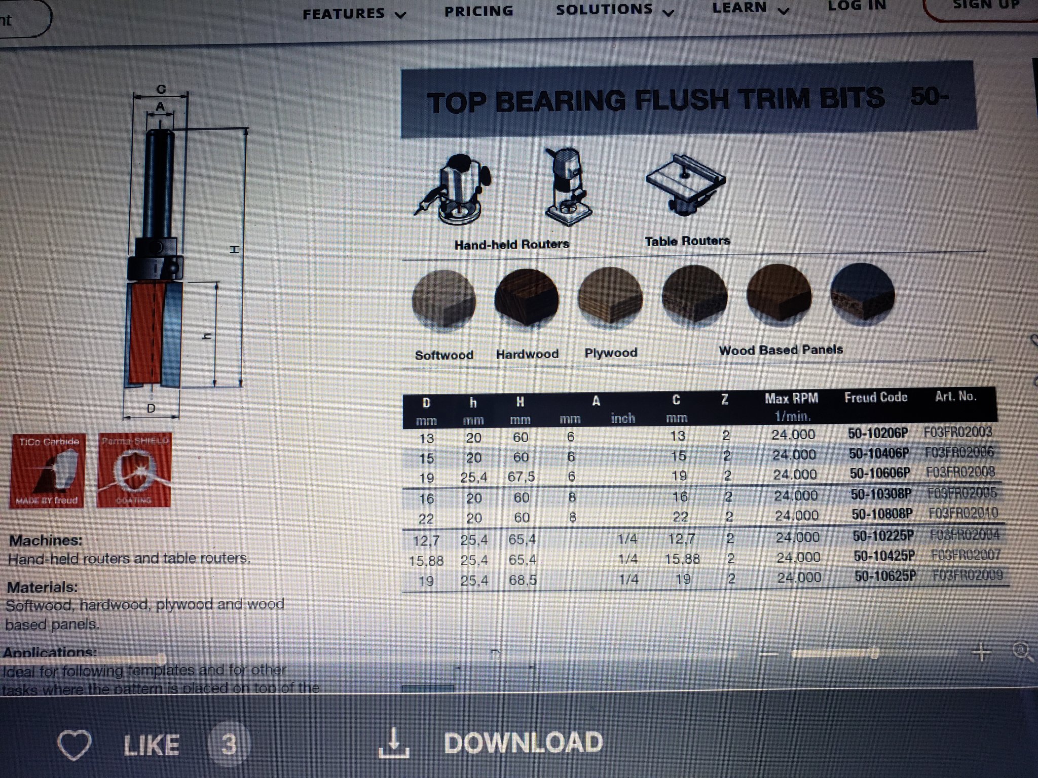

I was sent the wrong bit the first time. I need a top bearing cutter with a 1/4" shank. Does Freud even make them in this size? An online catalog wasn't very helpful, its for a store not by Freud.

NM they do, I found a compatible Freud catalog. The first ones were no help.
But thats for trimming. Are they the same thing, can I follow a template and cut right through 1/4" ply with either one of the three part #'s ?
