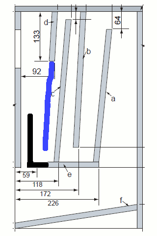

That let me to an idea of "back loaded horn + fonken hybrid" ... how's that sound? Instead of having a port, replace with a fonken (black line)
The question is.. what's the length and size....
I was thinking to extending the length (blue line) as well
Suggestion is welcome
lithoc said:That let me to an idea of "back loaded horn + fonken hybrid" ... how's that sound? Instead of having a port, replace with a fonken (black line)
What would you be hoping to achieve?
Well, I hope to minimize excursion as much as possible at lower frequency without sacrifice the bass response.
Since it's X-over @ 100hz or 150hz
I think it can be achieve if the enclosure is tuned correctly.

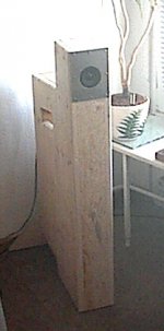

Hi
Have you finished them? If so, I would like to know how they sound, subjectivity as possible please.
I´ve just found this thread very related with my last toy:
http://www.che.es/uniforo/viewtopic.php?t=1786
I started them more than a year ago. Now are in "toilette" phase.

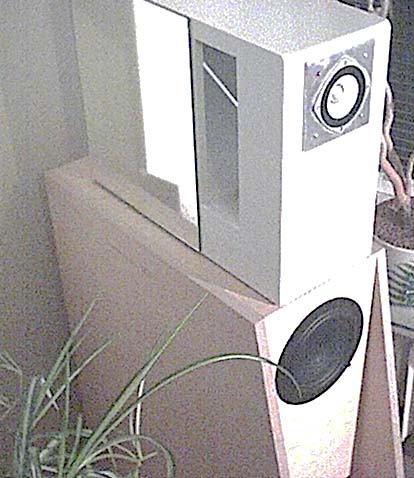

You are using the better suited FRS8, while the thread starter uses the FRS8M. They are not comparable. The FRS8M is more or less the high efficiency version, meaning the lower frequency roll-off starts at higher frequencies. And the FRS8 has Xmax ±1 mm, while the FRS8M only has ±0,5 mm.
There are many applications with the FRS8 (Needle, Brick, Buschhorn, etc.), but the FRS8M does not appear in many as real full-range driver. It is simply asking too much of it. The only version I know is this, and that is not one FRS8M but 25.
Ahora, sí entiendo.
There's a little mistake.
Yes, I started with FRS8 but the drivers finally mounted in the boxes where the FRS8M. I mentioned it at the final of the linked post. Hence my interest in this thread.
Why FRS8M and not the 'safe bet' FRS8?. Well I have a lot of answers but not certainty that only one were the real cause. Maybe curiosity on how this driver would behave in a 9 liter TQWT, plus play a little with wood and tools. And learn.
I don't know if I am asking too much of it, but at moderate levels they sound quite good, considering the price (less than 10 Euro), their small size and the fact I am a little deaf.
Regards
