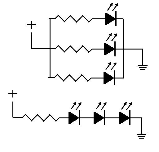

If the LEDs are wired in parallel, each LED will require its own resistor.

Just to re-iterate, LEDs cannot be directly paralleled, each one needs it's own resistor.
The more usual solution is to connect the LEDs in series, but with a limiting factor of a 5V supply that gets awkward.
If you connect two LEDs in series, then the VF's can be added together in the following formula.
R = (5V-Vf1-Vf2) / 10mA
So using Vf at 1.3V as before
R = 2.4 / 10 mA = 240 Ohms.
Three LEDs in series
R = (5V-Vf1-Vf2-Vf3) / 10mA
R = 110 Ohms
Four LEDs in series would make Vf higher than the 5V supply and the LEDs might fail to illuminate.
