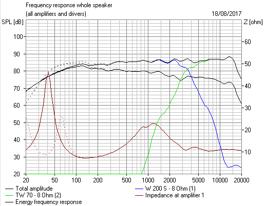

630830d1503064961-mission-762-custom-cabinets-passive-radiators-30l-reflex-versus-64l-closed-box-png
Here we see slow bass reflex versus some sort of fast (foot-tappin') closed box.
The double-peak impedance reflex certainly seems to deliver more bass in the main range. TBH, I like both approaches.
IMO, if you have a big magnet Qts= 0.38 reflex driver, that is what you do. If your driver is nearer small magnet closed box Qts= 0.5, that is what you then do.
We'd be silly to imagine there is anything like a perfect speaker. All is compromise. 😎
